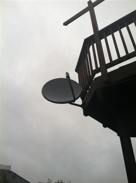

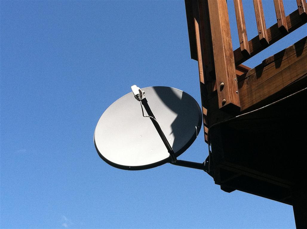

Someone had asked for pictures of what the dish is pointing. It's pointing toward a deck! Hopefully this helps!

Well usually you take a photo from behind the dish so we can see what is in front of the dish :D With these photos we can't really tell.

The dish is skewed! That explains why skewing the LNB (more) lost signal. Normally these dishes are installed with the portion of the tube the dish mount slips over being perfectly vertical. Than one can use the elevation scale on the mount set to the satellite elevation. With it "skewed", that's pretty much not an option. BTW: kinda looks like the required 25 degree skew though.
In the second picture, it appears that it's aimed at the top leaves of the tree in front of it.

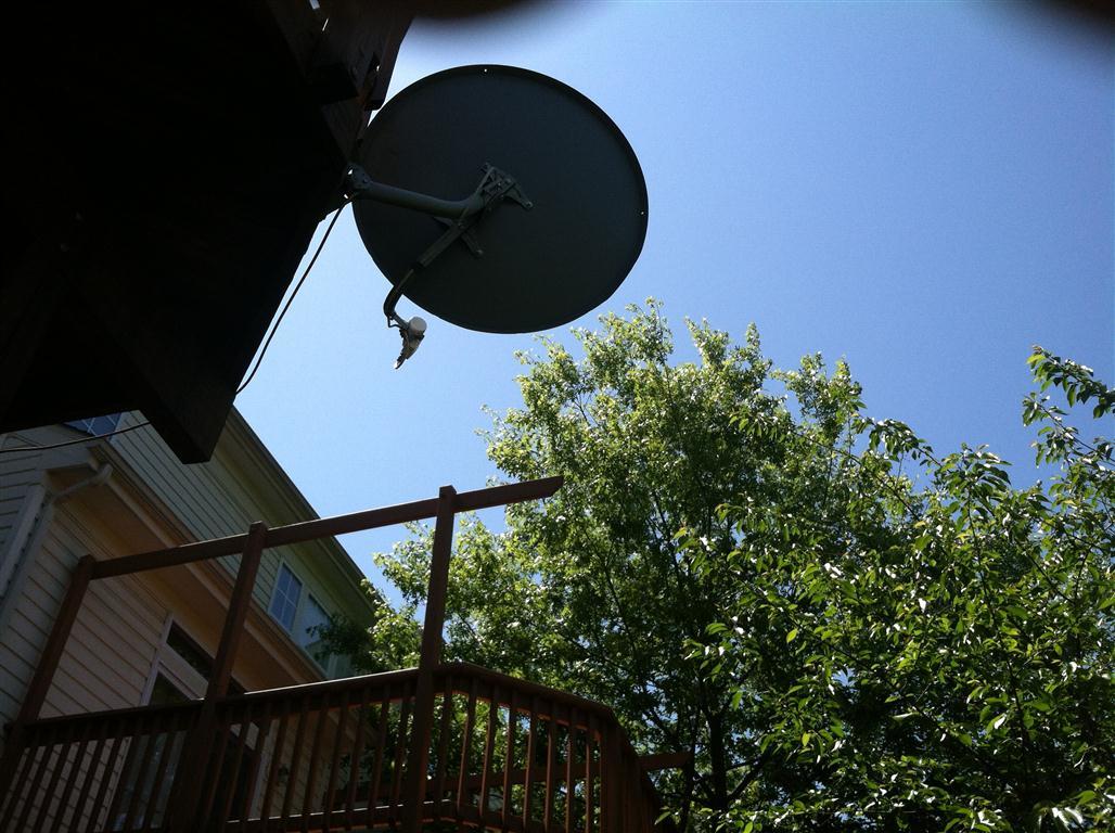

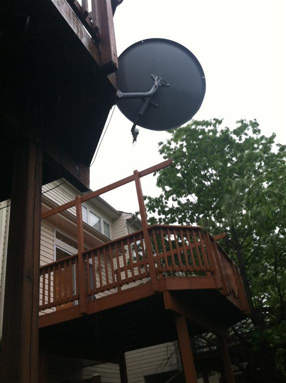

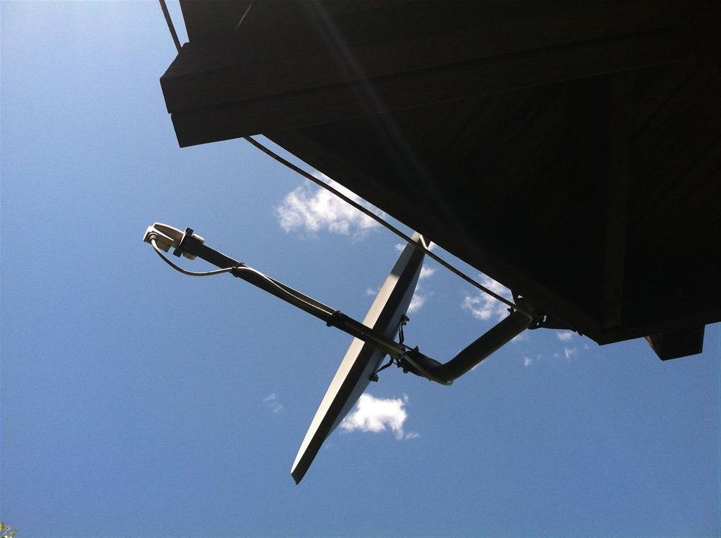

Well, finally a sunny day, after a week of rain. Took some better pictures. I really think it's the leafs on the tree. Was hoping, I could tweak the sattelite LNB, but it seems like a full re-install should be in order.

Agreed.... You can't fight mother nature. The tree has grown into the line of sight for the satellite signal. Time to prune or move the dish.

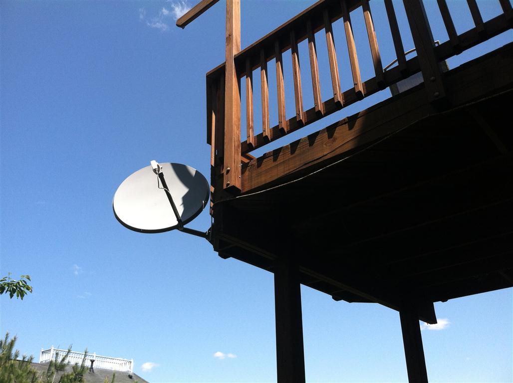

After tweaking with it, everything stopped working. Couldn't take it, and called in an installer. He tweaked it a bit where it was originally, and we just couldn't really pick up anything quality. We decided to do a fresh install, and fresh install we did. Got 270 channels total, and out of that 50 of them useful to me (Persian Channels). Signals range from 91-99 and quality ranges from 71-75. I asked if we could improve the quality from 70's to the 90's. He said, on Omegasat, for East Coast 70% quality is equivalent of 100%. Overall, glad that channels are working fine. He did say however, that FTA is not to stay, and sooner than later all these channels will be all on IP, and over Internet Receivers are the new things.

Glad to hear that you have your channels again. Great that you moved the dish. Should buy you another year before the tree grows into the path again.
