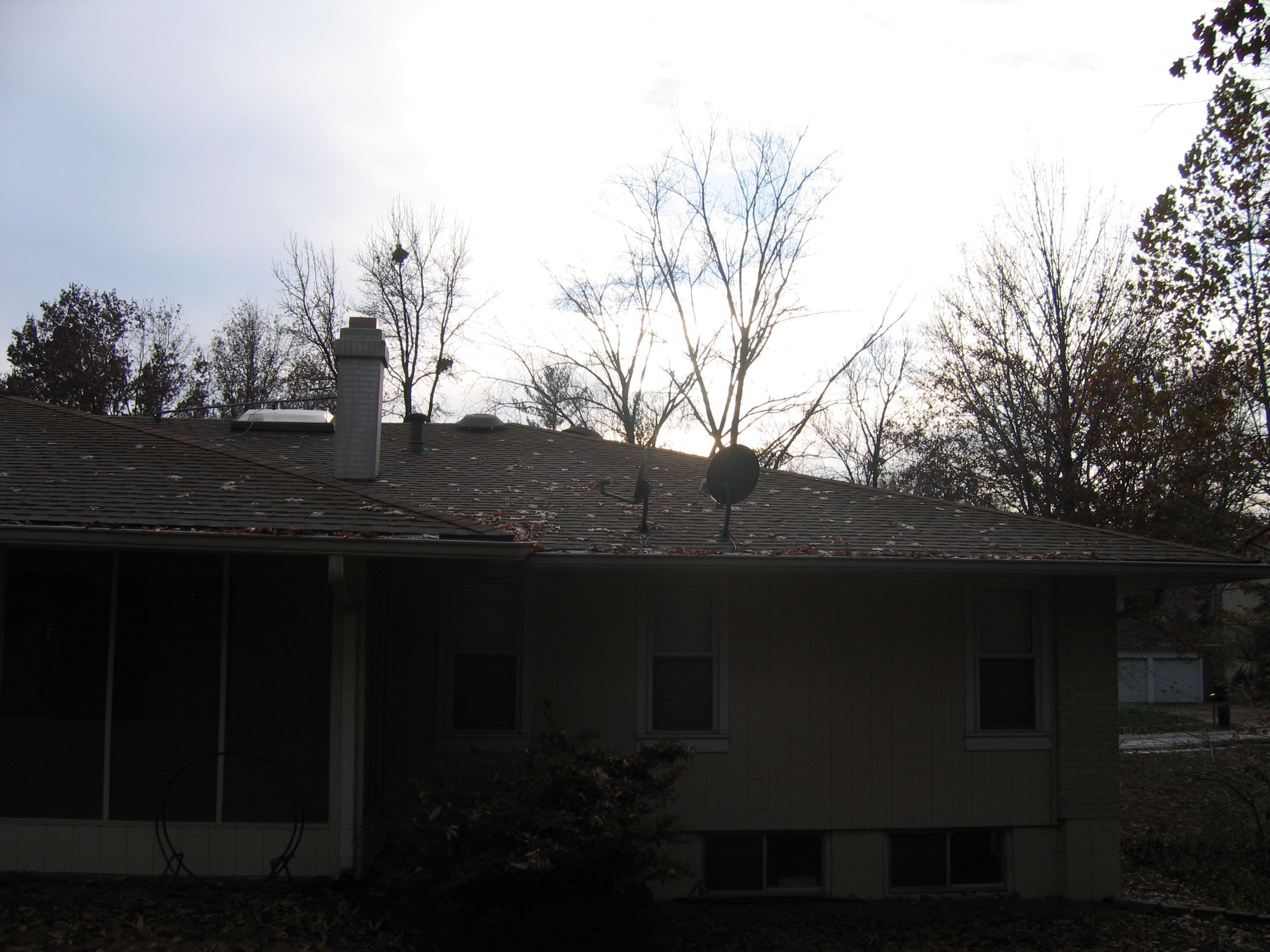

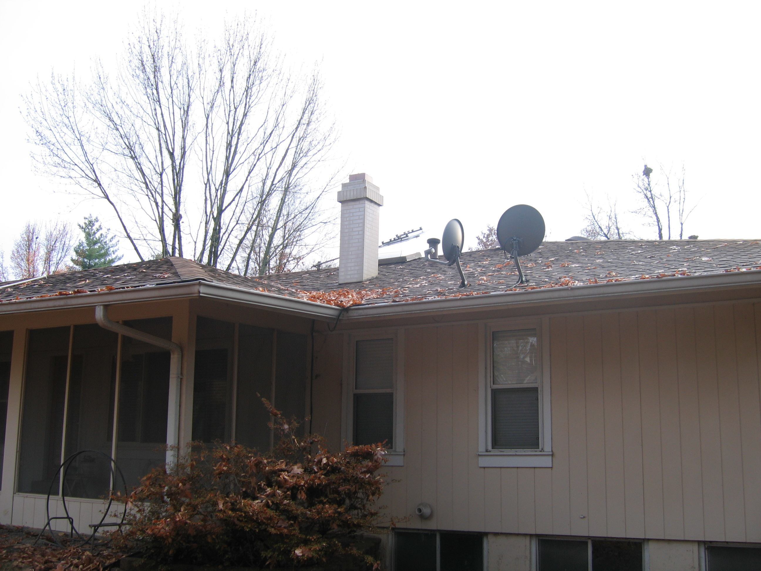

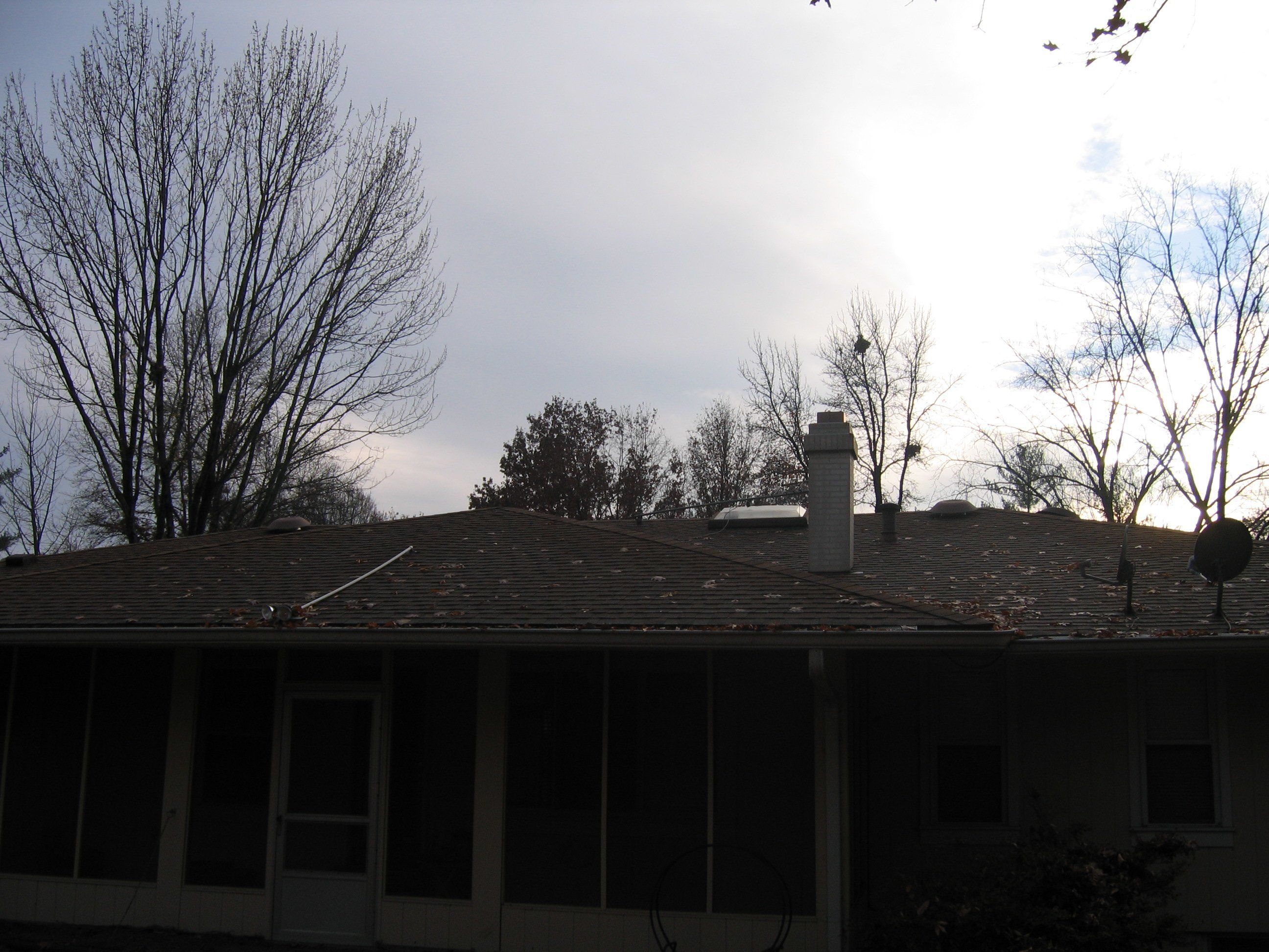

My biggest problem and question is is it ok to put a 90cm dish on the roof. I have read many things that putting holes in the roof is not good but I already have 2 DN dishes (which I did not install) and they don't leak but they are not 90cm dishes either. What are your thoughts about the 90cm on the roof. There is really no where else to put the dish. I think my subdivision does not allow dishes in the yard.
I have attached some pictures of the roof also to show where it would go and to find out what you guys think as far as reception of the most satellites.
I am thinking of putting it at the top of the roof in the middle to the right of the HD antenna which is laying on its side (don't laugh it works). This way I would clear the other dishes and the chimney. The dish on the left is pointing at 61.5 and the other is 110 and 119. There are trees when going less than 61.5 and there is one tree that you can see in the picture in between 61.5 and 110. On the right side of the house there are trees also.

To receive most of the satellites, you must have a somewhat clear view of the southern sky. If you own the house, you can put the dish anywhere. Putting it on a pole it not such a good ideal because it will wobble a lot in high wind. They make all sorts of mounts that don't need to go on the roof, such as an eave mount or mounting the dish on the side of the house or on a porch beam. They make mounts for chimneys too. There are some people that have mounted a dish on the roof, going through plywood,not on a stud, a good wind came by and took the dish and half the roof with it.
I don't like mounting on roofs due to leakage concerns but I have done it once. Make sure to seal all penitrations with tar or silicone and like Tim said make sure it is mounted into a rafter and not just the sheeting.
From the looks of where your current dishes are you should have a fine view of most of the sats. There is quite a bit of news channels and news feeds on FTA and there are some russian channels on Galaxy 25.
I think the setup you are thinking about sounds like a good choice and I hope you have fun with this hobby.:)
I don't like roof mounts either. Lazy DBS installers always do them though.
Is that a CM4228 laying down on your roof? Interesting concept of running electricity to a flood light ;)
Tim, I have my 90cm on a pole and it's rock solid for 2 years now. Wind has never been a factor.
If you get the right pole and install it correctly, you should have no issues with it. I prefer the pole mount as it is so much easier to work on than a roof :)

Whats the best way to install on a pole. I would rather do that but do you need to drive the thing into the ground or use concrete. I also have to put it behind the house so it would have to clear the house and then I guess I would have to bury the wire I guess and I would have to make sure my subdivision would allow it. Of course no one would see it in the back. I think I would hit more trees towards 61.5 also. The roof is still looking like the best place for clear view and easy install, but keep the ideas coming and convince me.
Existing pole for your other dishes prob wouldn't be tall enough to let a 1m dish move all the way around without hitting the roof. The FCC rules say you can put up a dish up to, I think 33", and the HOA or subdivision can't legally make you remove it. (They can certainly harass you over it, so if possible put it in the backyard. They're not that big compared to some of these new Dishnetwork/directv dishes that hit multiple satellites)
I have 2 on poles I got from the building supply, chainlink fence post works fine for mine, but they aren't motorized right now. Put about 2' in the ground, and you should have enough clearance over your house if you don't put it right at the back door. These offset-dishes are looking a lot higher than the first glance makes you think. 2-3bags of quickrete and you should be fine, if you find the pole wobbles a bit when the motor works, brace it later.
Remember to brace the pole while it sets, it needs to be as close to perfectly plumb as you can get it.

Well it looks like I am going to have to mount it on the roof.
The dish I am going to get is the FC90P that comes with the universal mount I.
I am thinking of using a retrodeck. Has any one ever used one of these? Is it worth it to use one? If I don't use one then I would put some 2x4s in my attic to help support the dish. If I use the retrodeck then I guess I also need the S style strut clips for the support arms.
Dish Mounting System - Commdeck - RSTC Enterprises
Will the dish on the universal mount along with a motor clear the roof? The dish would be going on the back side of the roof facing towards the upward slope.
Depends on how far down the roof you put it, I would think. You might have to use a longer pole (the part on the mount I mean) to raise dish up enough for it to clear the roof. Would be sweet if it was on the ridge, and fastened on the same side, rather than looking over the ridgeline of the roof.
I'm sure it can be done either way though..that's a nice device for a roof-install though.
