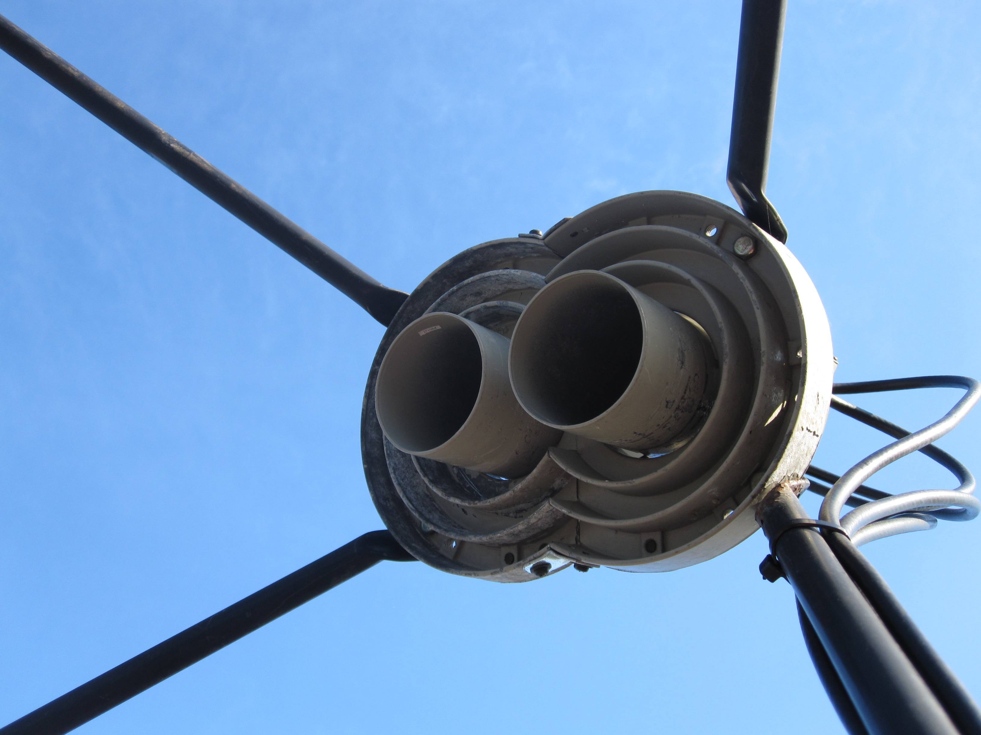

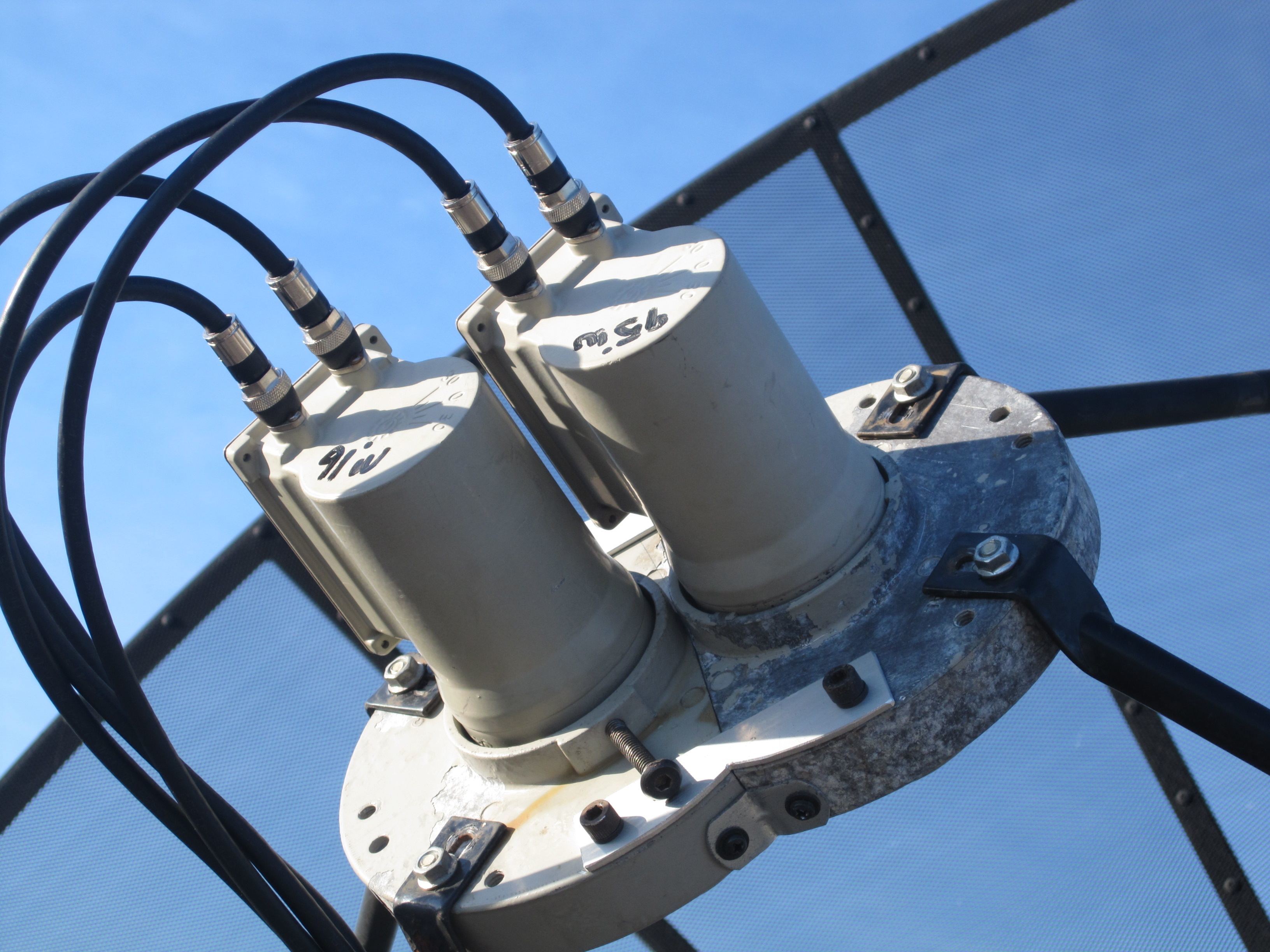

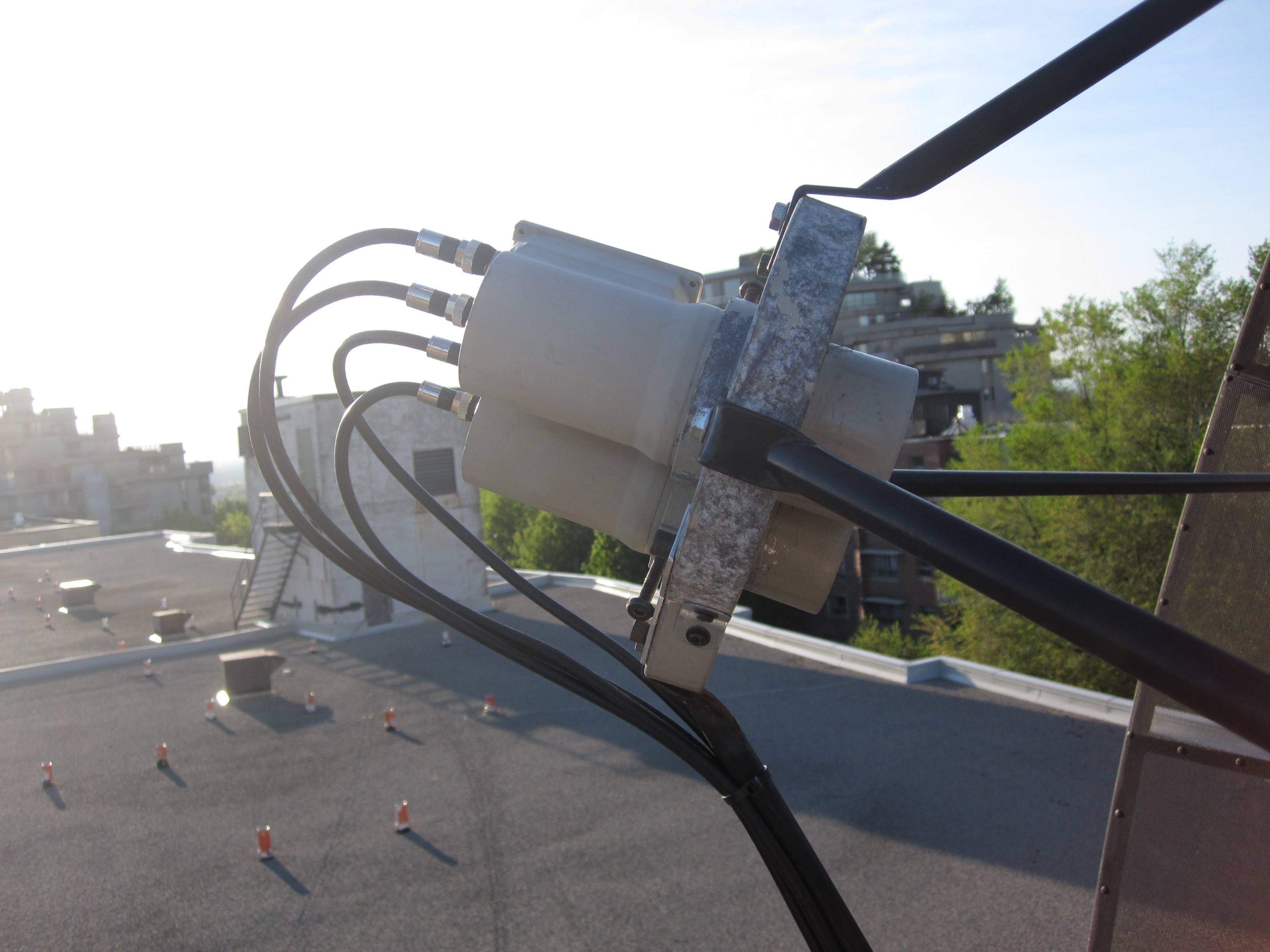

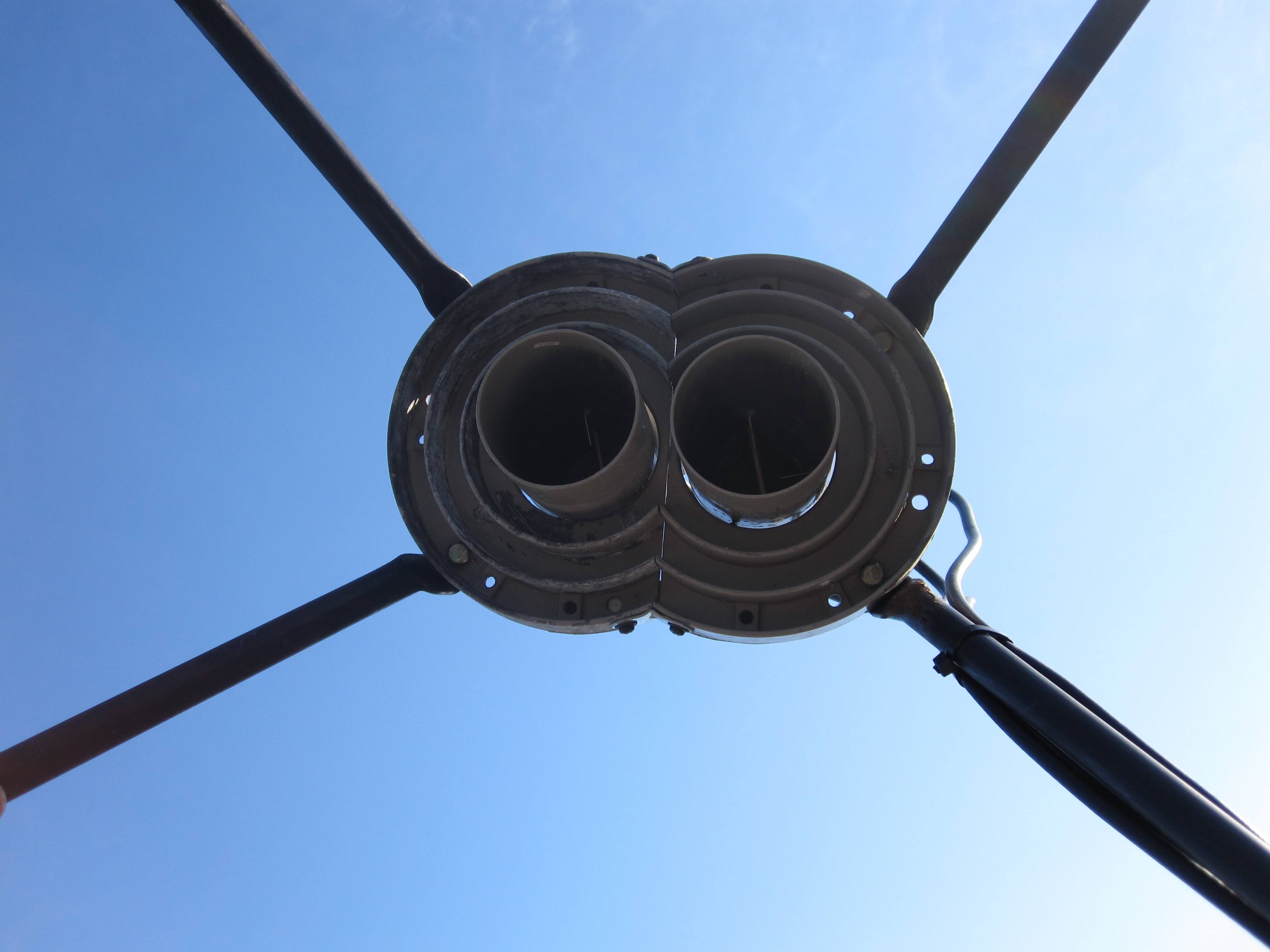

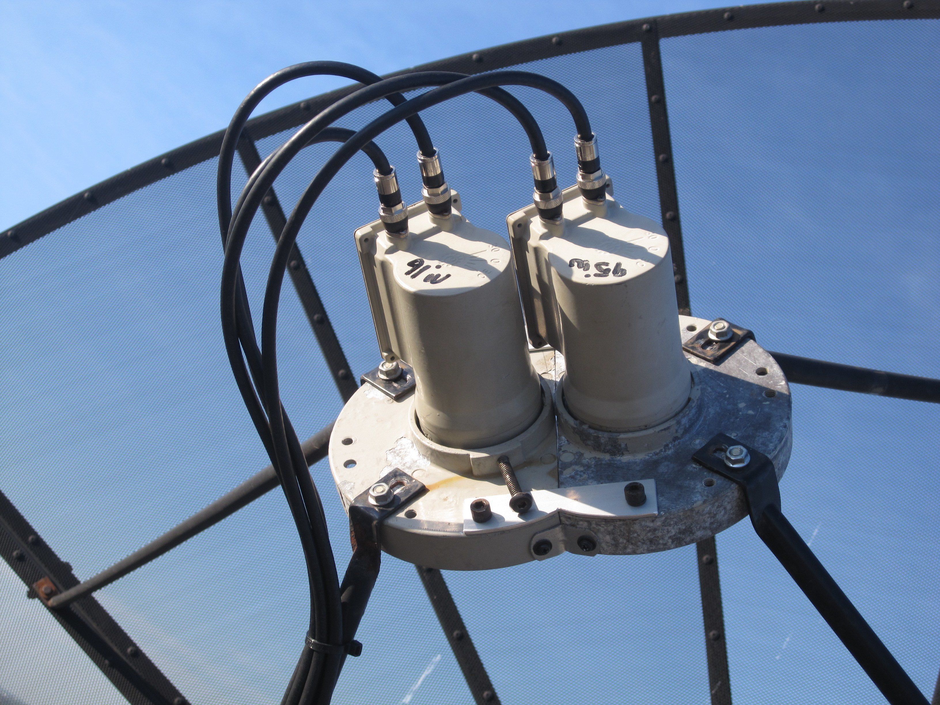

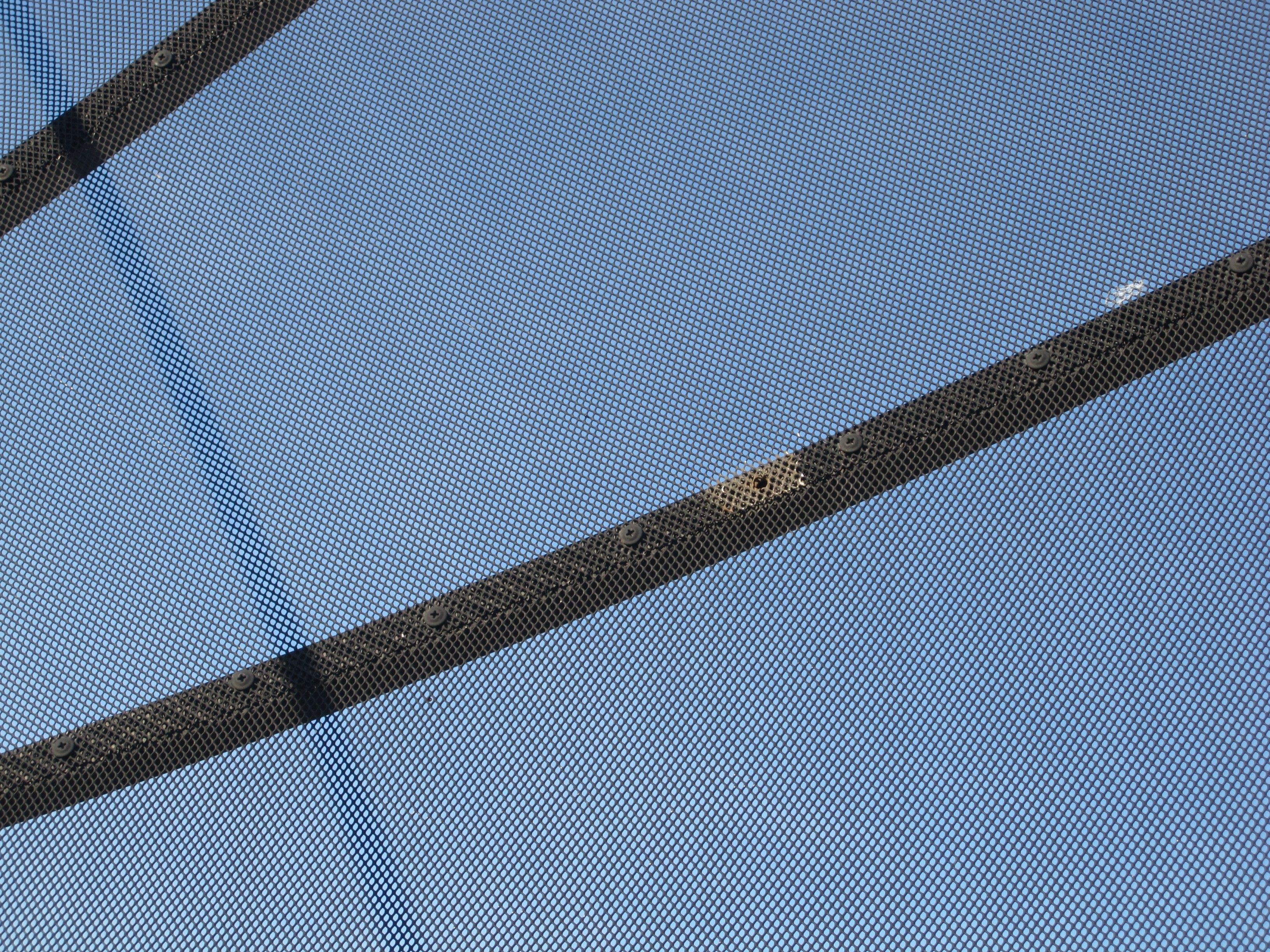

I save this 10 ft and I want to play around so I can get linear an circular whit it and the result is realy good , just I have to change the pocition of the supor for the lnb sa yuo can see in the pig 3 , the signal and the cuality it is 25 % more and the two lnb are 4 degre space , so if I point to 91w the other it is at 95 or 91w and 87w or 95w and 99w and so happy whit the result of this setup, here some pig.
