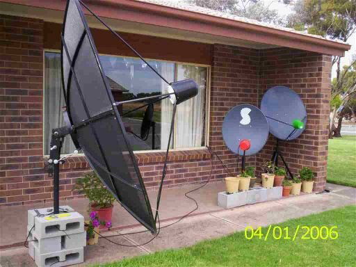

Hello, ever since getting into KU I want to go bigger and get a C band dish. The problem is, I live in an apartment building I know they do not care if I put up a C band dish. I noticed that Galaxy-Marketing still has the 6FT WS1870P still for $69. I would like to buy that dish and try to hook it up. I have a flat roof, I was thinking of putting the dish on a NPRM no one would touch it but I would feel better if the dish was hooked onto a pole mount. I have seen bigger C band dishes that was installed via a wall pole mount I just don't have any pictures to show. I do have this picture of a C band dish installed via cinder blocks. What I am asking is how would I do the same install? Or could I some how install via a strong pole mount? Thanks

I think a NPRM is the way to go. That also make it somewhat portable if it needs to be moved in the future. I have 2 NPRMs on the ground with several flat concrete blocks under them and blocks in place on the tops.
The dish in that photo needs a larger footprint for proper support assuming it's not in the ground. Those blocks are barely enough to balance it. Bring along some wind and it's history.
