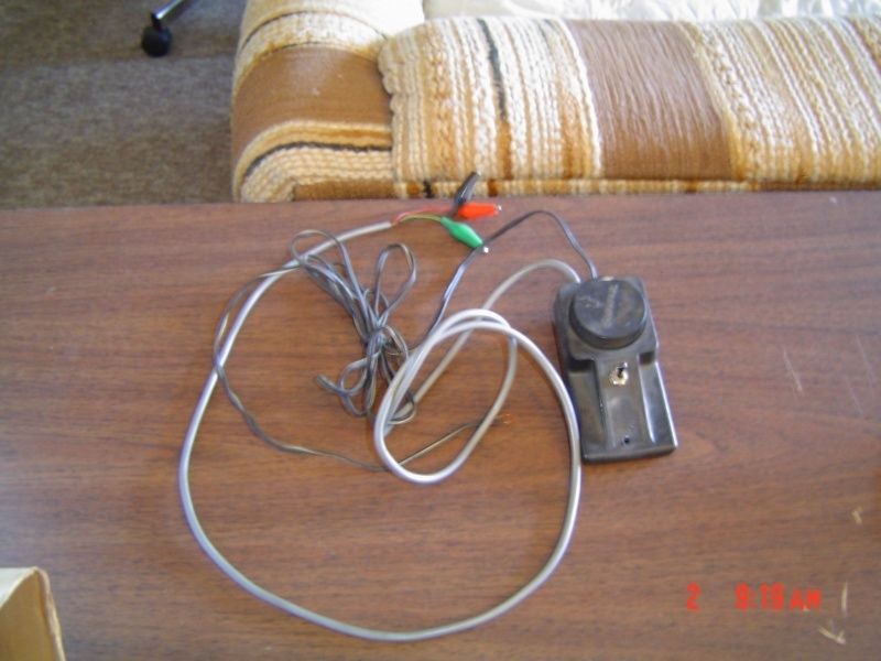

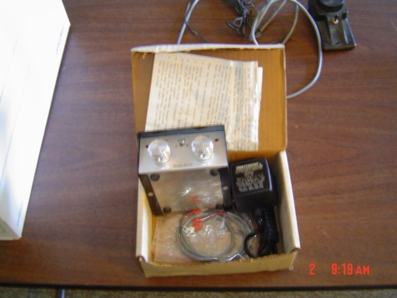

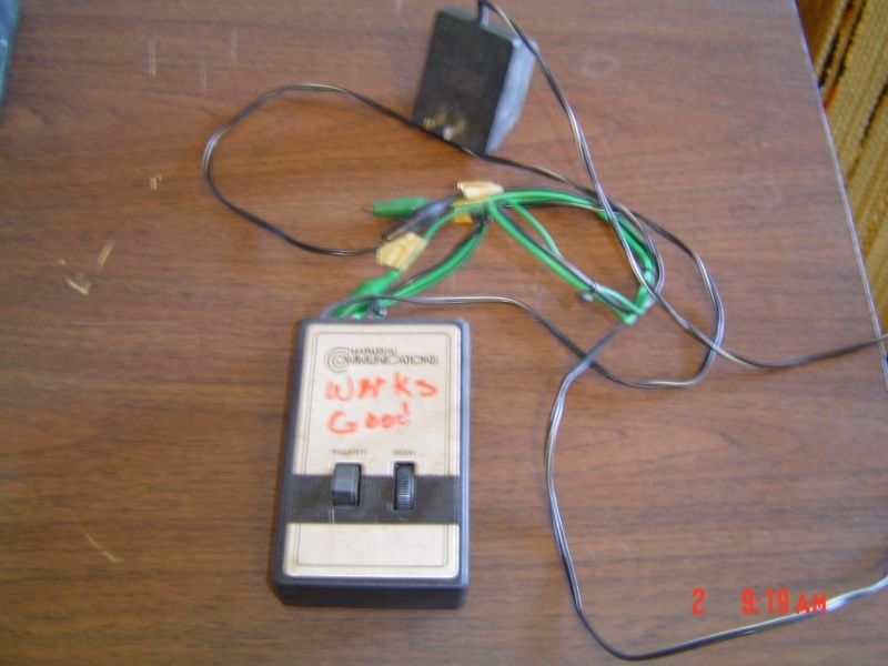

First, I have some polarotor/co-rotor stand-alone control boxes that will control the polarity and skew from inside the house. It uses the same wires as the old analog receivers uses minus the receiver. :)
older-style-chaparall-polarity-controller.jpg new-polarity-controller.jpg chaparall-polarity-controller.jpg

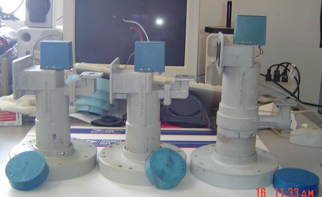

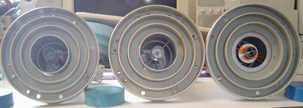

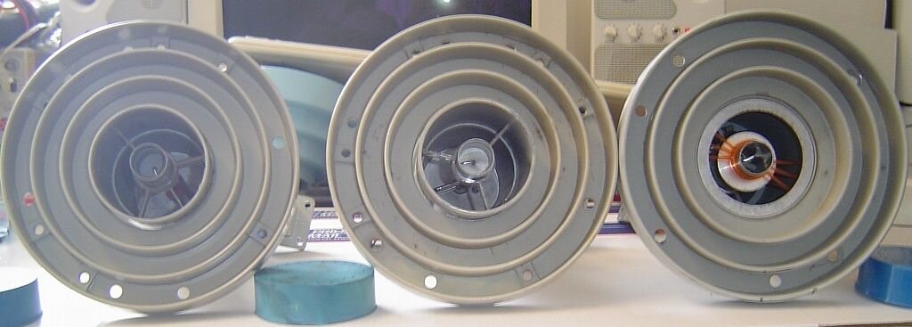

Secondly, if you just want that last fraction of a signal, I have 4 or 5 of the old "patent infringing" Co-Rotors still. These have the ADL probe on the end, and work significantly better than the Co-Rotor II feed-horns.

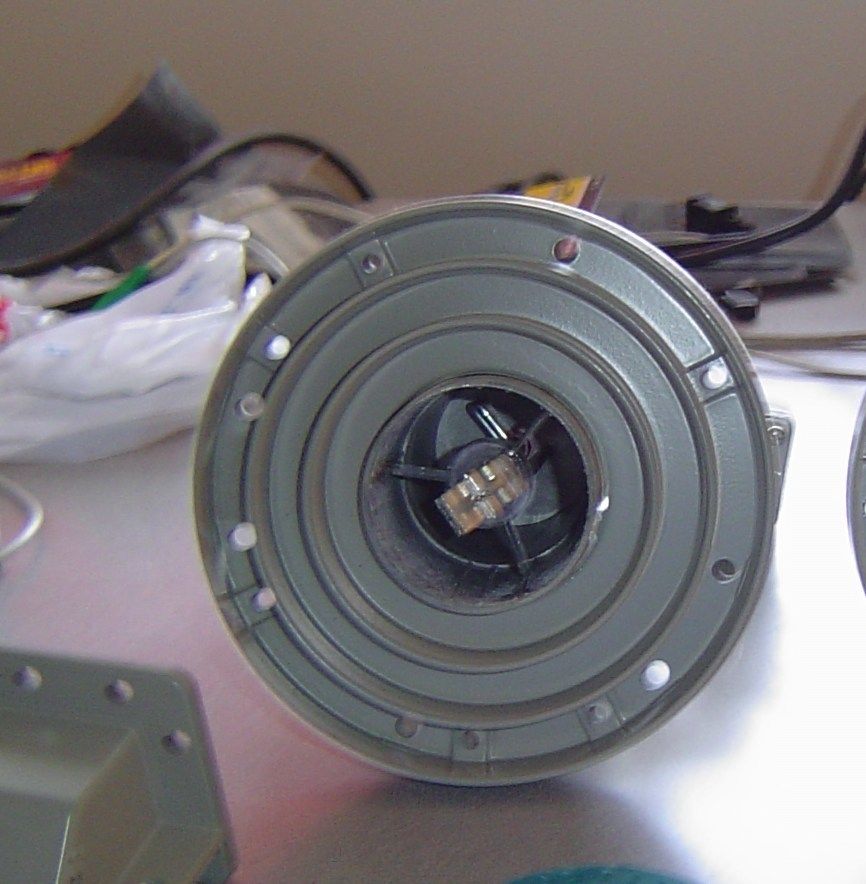

This is the Co-Rotor II probe.
View attachment 66128 View attachment 66130

I don't know the story of the patent infringement, so I don't know its significance.
Here is a thread that explains all about the differences between the original Co-Rotor, and the newer Co-Rotor IIs. It took me a while to find it, but it is worth reading.
Sure, I'm interested in these things, but haven't a clue how to work them. I figure I'd have to wire it up and then experiment.
They work exactly as the skew on an analog, or 4DTV receiver except you don't even have numbers on the screen to look at, so yes, it would require some experimentation, but you would no longer need to have a receiver in the line to use them. The polarity change is a simple throw switch, while the skew is a dial, so you simply throw the switch back and forth, and dial in for best signal.
