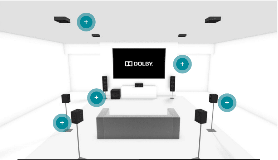

Tons of content already. I have over 20 movies in atmos alone. Yes I do belive this will sprout. Why? It's included in the ATSC 3.0 Standard. DirecTV already gives you 7.1 surround with 4K and has plans for Atmos surround embedded into 4k movies in the future. The content is there. On top of that Atmos sounds amazing. There is an atmos demo of a bee flying around the screen, but the sound is so realistic that it literally sounds like the bee is next to you ear. The entire room is filled with sound from all directions, and the emersion is phenomenal! Anyone who is considering the upgrade, dont think twice. Go for it. I love my Atmos system that much!
http://www.dolby.com/us/en/experience/dolby-atmos/bluray-and-streaming.html
Here is the Atmos speaker placement guide. It's better to have preplaced speakers in the ceiling than the upfiring ones. No special speakers are needed if you have ones installed in the ceiling. http://www.dolby.com/us/en/guide/dolby-atmos-speaker-setup/7-1-4-setups.html
