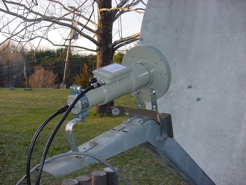

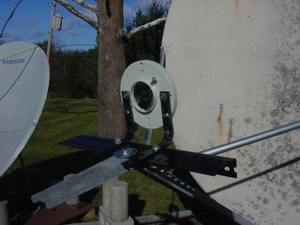

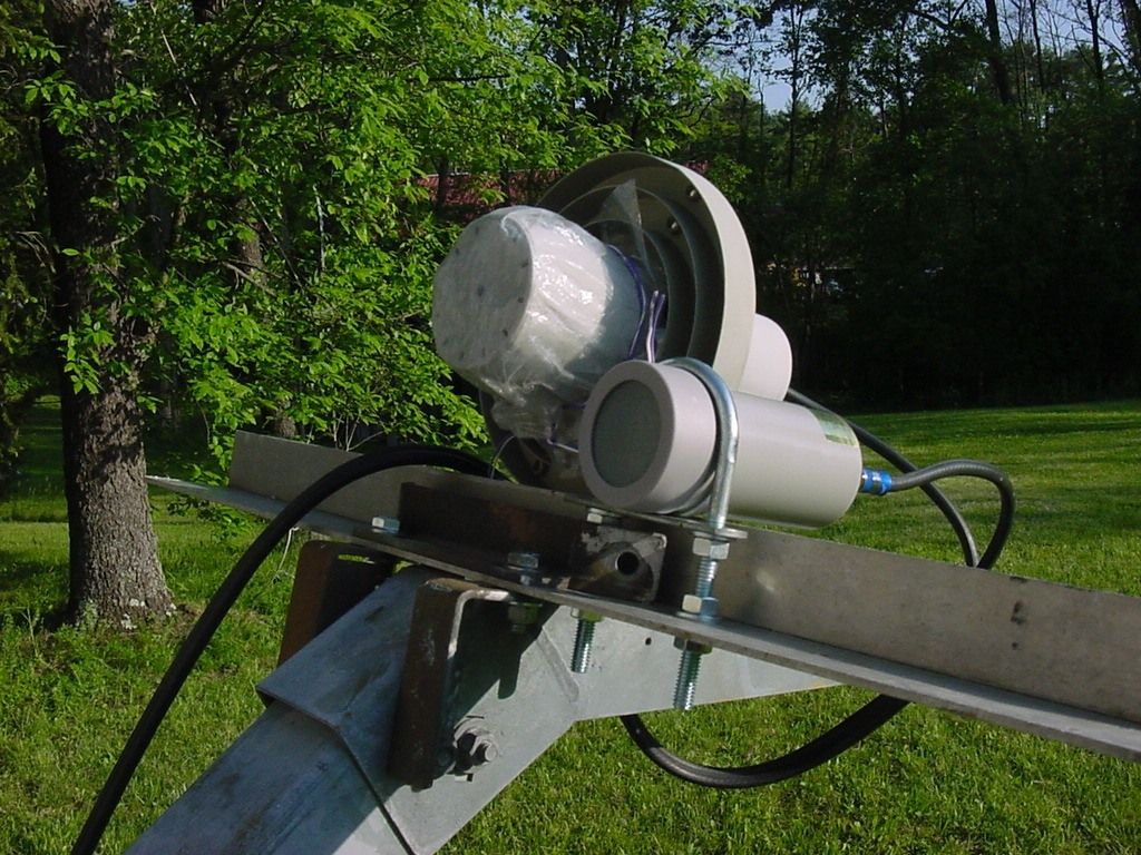

I have 2 Prodelins setup out in the yard. I was creative and rigged up some homemade feed brackets. They work great.
I have one setup for 101°W ku and 105°W C band with side by side LNBFs. A conical scalar installed now (not pictured). The other dish on 99°W C band currently.
I wouldn't bother motorize either one of them. It would be better to go with multiple LNBFs in my opinion.
