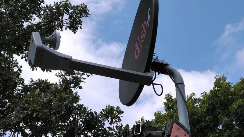

Then, last month, there was this beauty I ran into
3 guesses why this wouldn't get signal and I'll give you a hint. It's not because the lags were only half way in and it's not because it was pointing north.....
Reactions: Bogy and TheKrell
LOL! What could possibly be worse than pointing north? I see the mast is upside down, but it seems to me that would hardly matter if the dish is pointed north.
Reactions: pattykay and HipKat
Hit the roofers with a lawsuit for damaging your sat dish. Open and shut case.
Reactions: HipKat
The mast is it vertical out of the foot plate lol. Customer told me hadn't and wasn't paying the roofers til they repaired that spot after I fixed the dish
