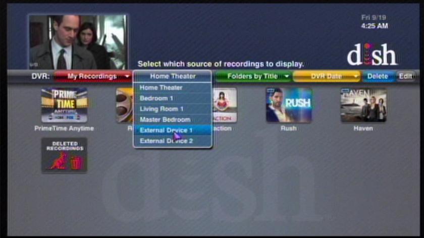

you don't use the menu external hard drive icon to view the recordings on the external drive.
press the DVR button on the remote then on the line that displays the red "my recordings" next to that will be a selection displaying the "name" of your hopper. choose that dropdown menu and one of the selections you can choose will be "external device 1" choose that it will display the recordings on the external drive and you can then choose the one you want to watch.

Is your EHD plugged in to a USB port? You will only see that if it is.
It's just to the right of "my recordings" in gray. Will say your hoppers name. Highlight that, click it, and you will see the EHD

here is a screen image.

To repeat what was said before (but perhaps unclearly)... When in DVR, you will see a menu tab along the top that says "Living Room", or whatever/wherever you have designated for the Hopper name. Click THAT, then you should see your EHDs.
Reactions: ChadT41
Thank you VERY MUCH guys ,i just let the box settle down around 24 and the first update last night...now i see everything in EDD and plays VERY WELL
