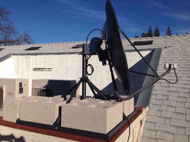

Her is a photo of the non-pen with a motorized 90cmon my shop.
Reactions: fred555

I certainly like the idea of the non-penetrating mount. It would be easy to move if I wanted to try for a different satellite in the future. Also, the soil here is very hard at abut 12 inches down and I am not as strong as I used to be. This one at least has free shipping, http://www.solidsignal.com/pview.as...oof-Mount--30-Mast-with-1.66-OD-(SKY32816KITB). Yes, I was just at Lowe's and the fence posts are certainly not very precisely made. I appreciate all of this advice!
