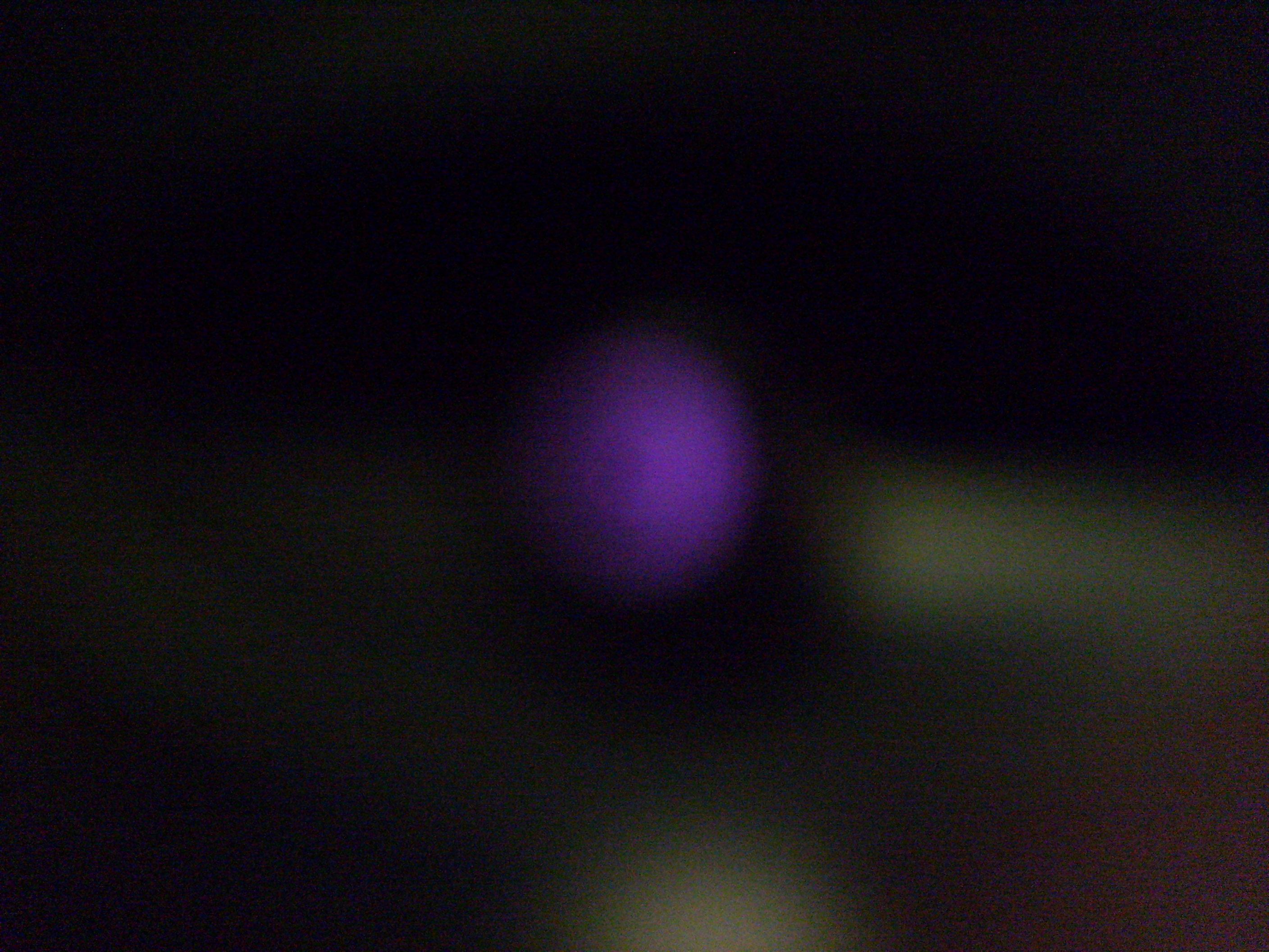

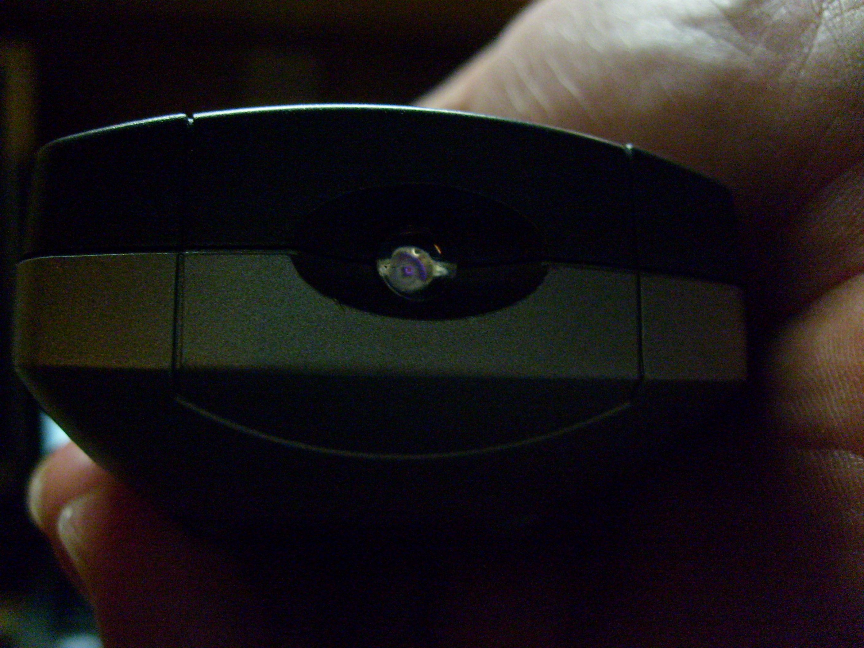

A Tip To See If Your Remote Works!
It just could be the remote. There is an easy way to check to see if your remote works or not, look and see it blinks when you press any button. Now, your naked eye cannot see inferred but cameras can! I never tried a digital camera by just holding a button and clicking off a picture but video cameras or CCD cameras can see the flash inferred emitting from the remote . An old trick a former radio station engineer told me about. I will try to snap a picture of my CNX Mini remote to see if digital cameras can see it on post it here at the end of me typing this reply! And if your camera has a preview LCD screen, a picture is not really needed! You will see it working right off!
The answer is YES! :D
A digital camera can see inferred emitting (Most remotes Emit Purple Light) from the remote when placed up to the camera lens! Now you can see if it is actually your remote working or not! Hope that helps!
Kevin
