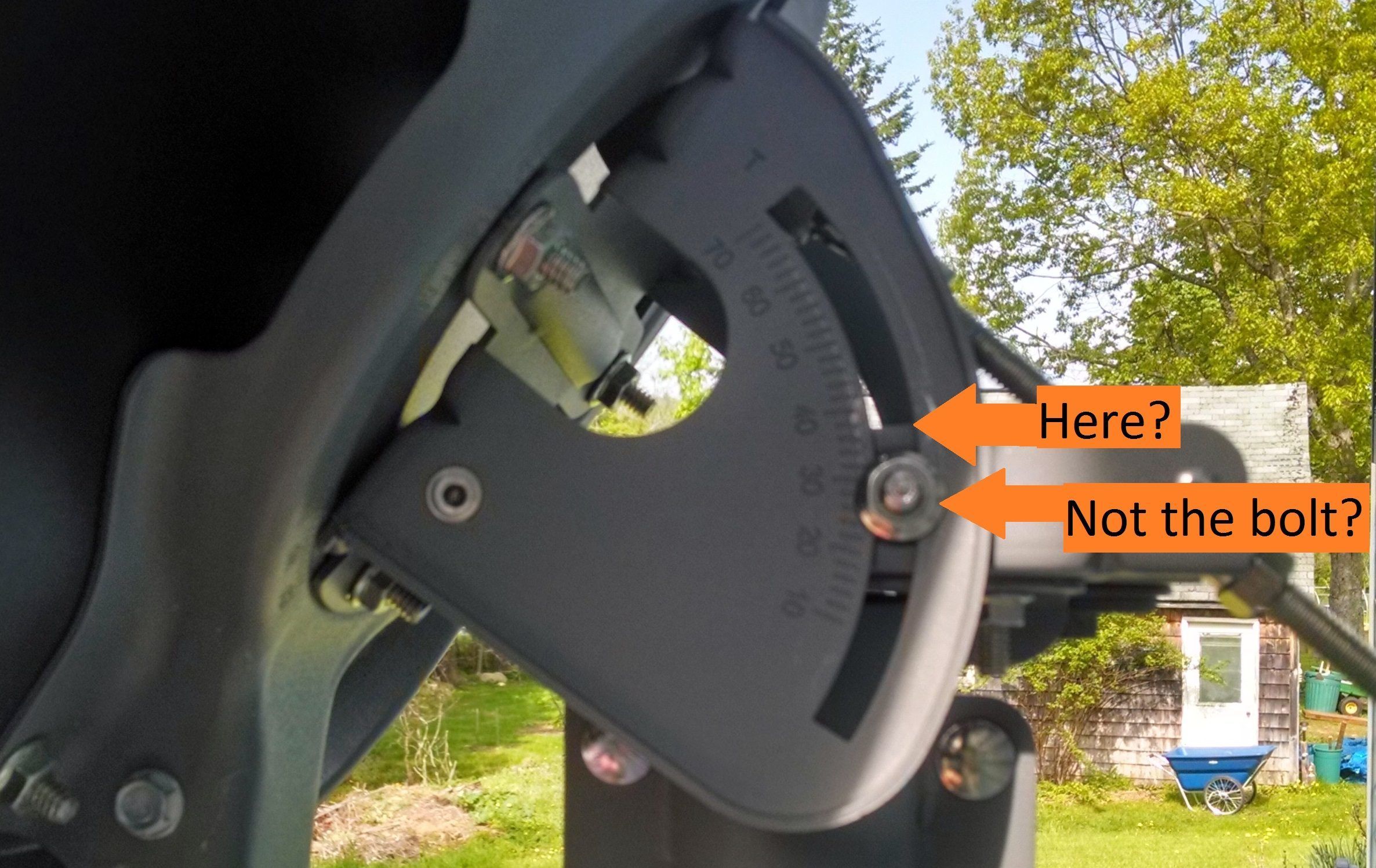

Attached picture is how it is set now.... my zip is 044xx... every resource I've looked at says 38 deg inclination... How could the dish mount be so wrong?!?!

The picture resolution is awful, but it looks like it's set to 38 to me.
Your dish is showing 37 degrees, it's not the bolt but the bracket that lines up with the markings.
It would appear that the previous installation had the mast significantly off-plumb.
Use a tool like dishpointer.com to determine your dish settings.

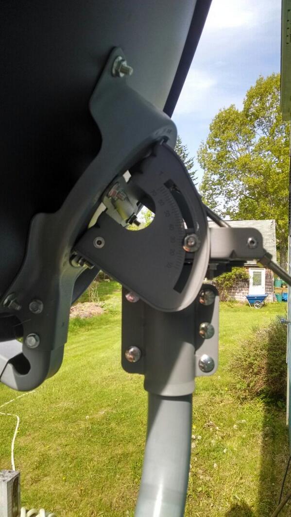

Better picture. I take it I was measuring in the wrong place? I was using the bolt.

Reactions: ds2600 and TheKrell
