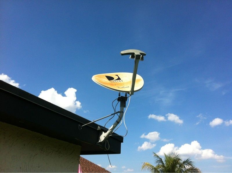

How many pods are there on the lnb? Does the dish say Slimline on it?
Which lnb does yours look like?
<img src="http://www.satelliteguys.us/attachment.php?attachmentid=75873"/><img src="http://www.satelliteguys.us/attachment.php?attachmentid=75874"/>
The second one and yes it says slimline

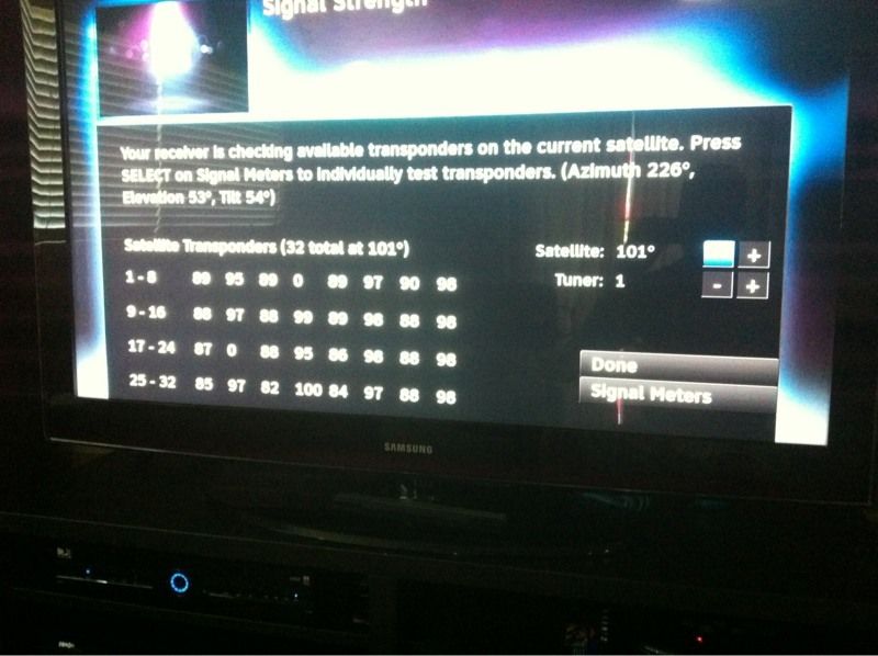

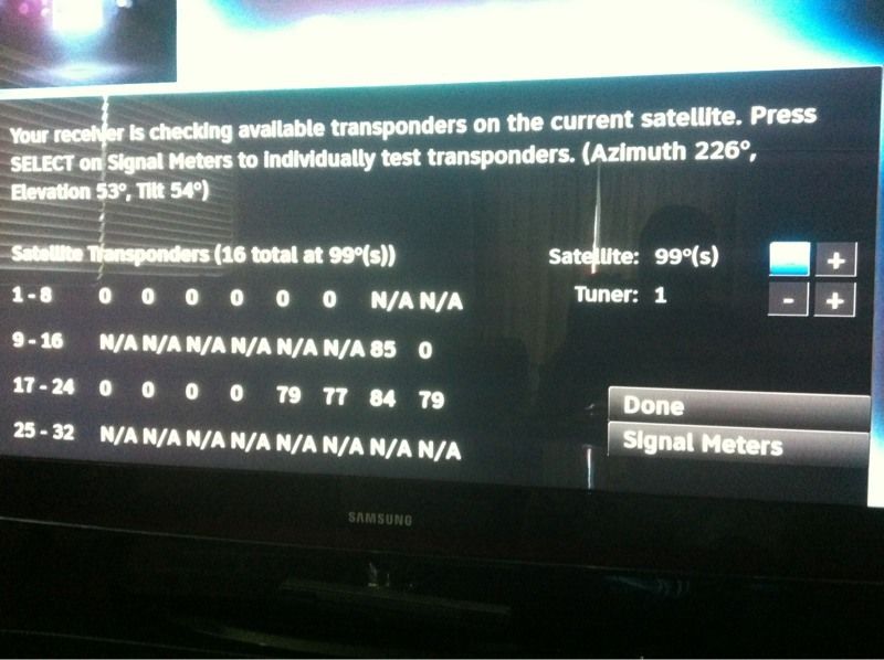

raoul5788 said:
jstcruzin, since your sd locals are on 101, you must have an sls3 lnb. That means you don't get signals from 110 or 119, only 99, 101, and 103. Can you post your signal levels for those satellites? On 99s the only transponders that matter are 15, 23, and 24. Don't worry about 103s. None of your channels come from there.
Pics of 99s and 101 signal strength
Unless your package requires that lnb to get 119, I'm surprised they installed one. Your spot beams are 15, 23, and 24. The numbers are a little low, but not terrible. You said you get nothing on 119 and nothing higher than 71 on 110. That's way too low. I suspect your dish needs realigning.
