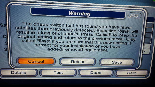

Last night I lost HD on ESPN, SD is fine. Still out today as is HD on 122,138,158,167. I also have AAD for ABC CBS and FOX in SD and they are also in Complete signal loss code 11-12-14. Dish's are clear of snow,cloudy no rain. Already tried unplugging have not called CS yet. Also I do not have the Protection Plan. Any help would be appreciated.
20131222_141747_resized.jpg Previous sceen showed green OK on both satellites.
Check all coax and connectors. If good, I suspect the LNB.
Do a System Info to see if you have lnb drift. Box A will give you the results.
On the pic I sent do I click cancel or save? Also the ADD channels are on a separate dish pointed at 119 could both LNB have gone bad? Will go check coax now.
Solved it! Thanks every one. Coax going into grounding block was the problem. The center wire was rotted out. When I upgraded to HD they reused the coax from the 119 dish that was from the original install that I did myself in 1997! I just did a temp fix for now. My question is who is responsible for the rest of that old grey coax?
