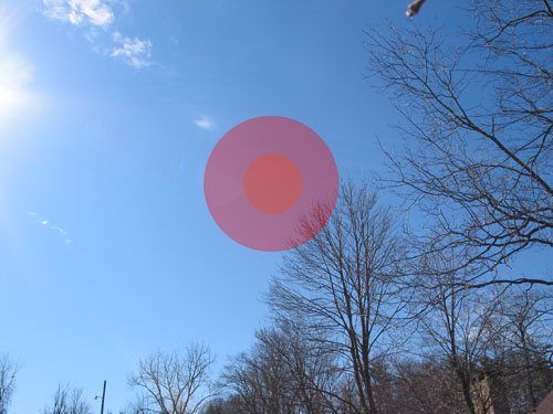

I'm thinking at this point I may be screwed out of my DVR. As much as I dislike Dish Network I love the damn 510 DVR we have. We've used it the past year and frankly we don't know what the hell we did before it. The place we are moving to has free cable which is handy I suppose. But they don't have DVR available in our area. Leasing a DVR from the cable provider is out. Can anyone that's an installer or familer with signal strength check out the below photo and figure if I'm looking at a major loss of signal or something usable to keep the dish? We have trees in front of our dish at our present location but they are are about 250 feet away as opposed to 100 feet away at our new location below. Presently our signal strength is 125 and 123 on 119 and 110. This is the best location I can find and unfortunatly we cannot mount to the house we are moving to since we are renting out the basement. The shaded area is about where the dish will be pointed. The trees do leaf out but not heavily. TIA

Hello Mustang or(dirty old man) don't know which you prefer, but anyway what is your zip code? Also is that a deck I see above where you be installing the dish? You said basement so I'm guessing. I need your Zip but I have been installing Dish and Direct for a few years, so with what I have now You may get 119 ok untill spring comes and the trees leave out but 110 may be blocked by the deck(house). Please give more info your Zip, and town and state, and is that where you have to put the dish from pic(I assume you do or would not have sent pic)...But with what I see it don't look good...Hope I helped or can help.... :)

Bear in mind that the actual location of the satellite is much higher than the point that the dish appears to be facing. It varies, of course, on where you are but a rule of thumb might be that the satellite would be somewhere about half way between the dish and the arm holding the LNB. In other words, maybe you will be above the trees after all.

As for the elevation - just point the camera per the actual Elevation number and ignore what you think the Dish is looking at (which is 20+ degrees lower than reality).
Both Sats show an azimuth angle of 232, elevation angle of 32, and skew of 122. I used a compass and homemade azimuth device using a 180 compass with a straw for the sightline. the 232 line damn near lines up perfectly with the rear edge of the house. The 32 degree elevation is about where the red and orange circle is on the picture. I double checked by setting the spare dish I have to these settings and leveled out the mast up against the deck post and saw the same thing. I was thinking of mounting to a post a few feet from the deck in order to make certain I clear it. Unfortunatly most of the other possible locations are even worse than this as far as tree coverage. The was the closest best location I could find so far. The location I'm at now (before our move) seems to look directly through a similar tree of the same density only further down the street with minimal signal loss. At worst our signal drops to 119/122 when the tree fills out.

The reason both birds come up with the same numbers is that you have the "Dish500" box checked. In reality, for you, 110 is at about 228/35 and 119 is around 238/30 - guesstimating from a close zipcode I found - 00283.
That puts 110 real close to the tree trunk - but I don't think it matters - there's WAY too many tree/leaves to look through. Assuming you aimed it right (and I think you did), based on that picture you're a "no install - LOS".

I can't speak to your clearance on 110 vs. 119 'cause I can't see what you see. All i CAN say is that the picture you posted is a "NO LOS".

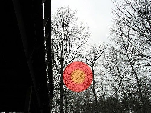

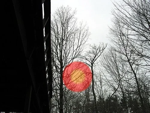

I had to move the potential location of the dish today a bit. I also took a nondirect route to the point in the wall where the cable would go. It came out to about 100' total length from dish to wall access. I haven't posted a pic yet of the new location I've found becase of the rain. It's a digital camera and it would toast it. Looking at it though it is just as clear as our present location, just a little farther than I would like. The weather for the rest of the week here isn't looking good for getting a picture of the new site either. Thanks for all the help guys.
:D
I got a pic of the new location I have now. Aside from future tree growth, which I'm told the tree in question has basically reached height, I should be good to go. The distance is quite far from the dish itself. The only thing now is the distance to the receiver which came out around 100' or so. I still can't run it to the living room because it would be another 68' to the wall plate in the living room. That's well outside the distance for the maximum cable run. No worries though since the DVR 510 has the UHF remote with it.
