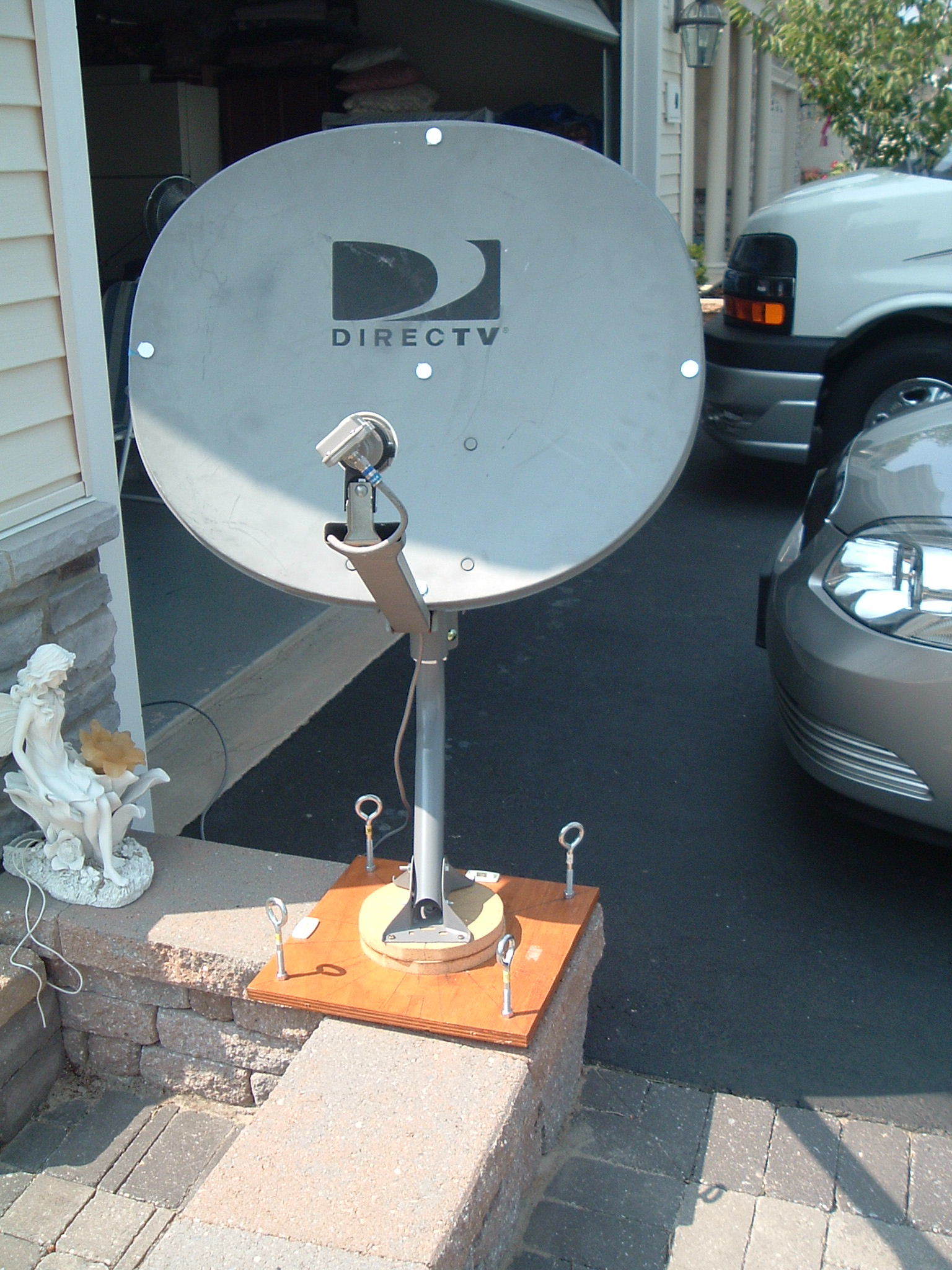

My answer to lazy susan,
Hey Popcorn,

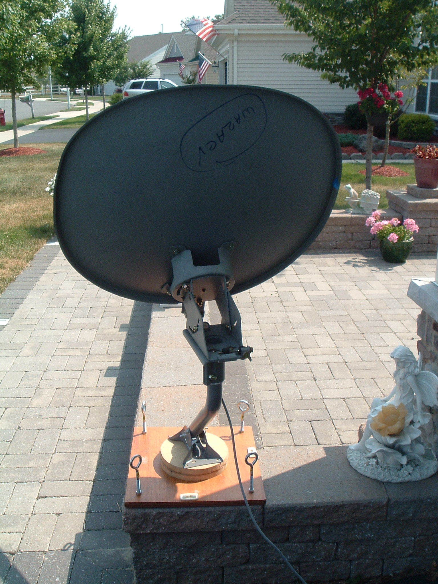

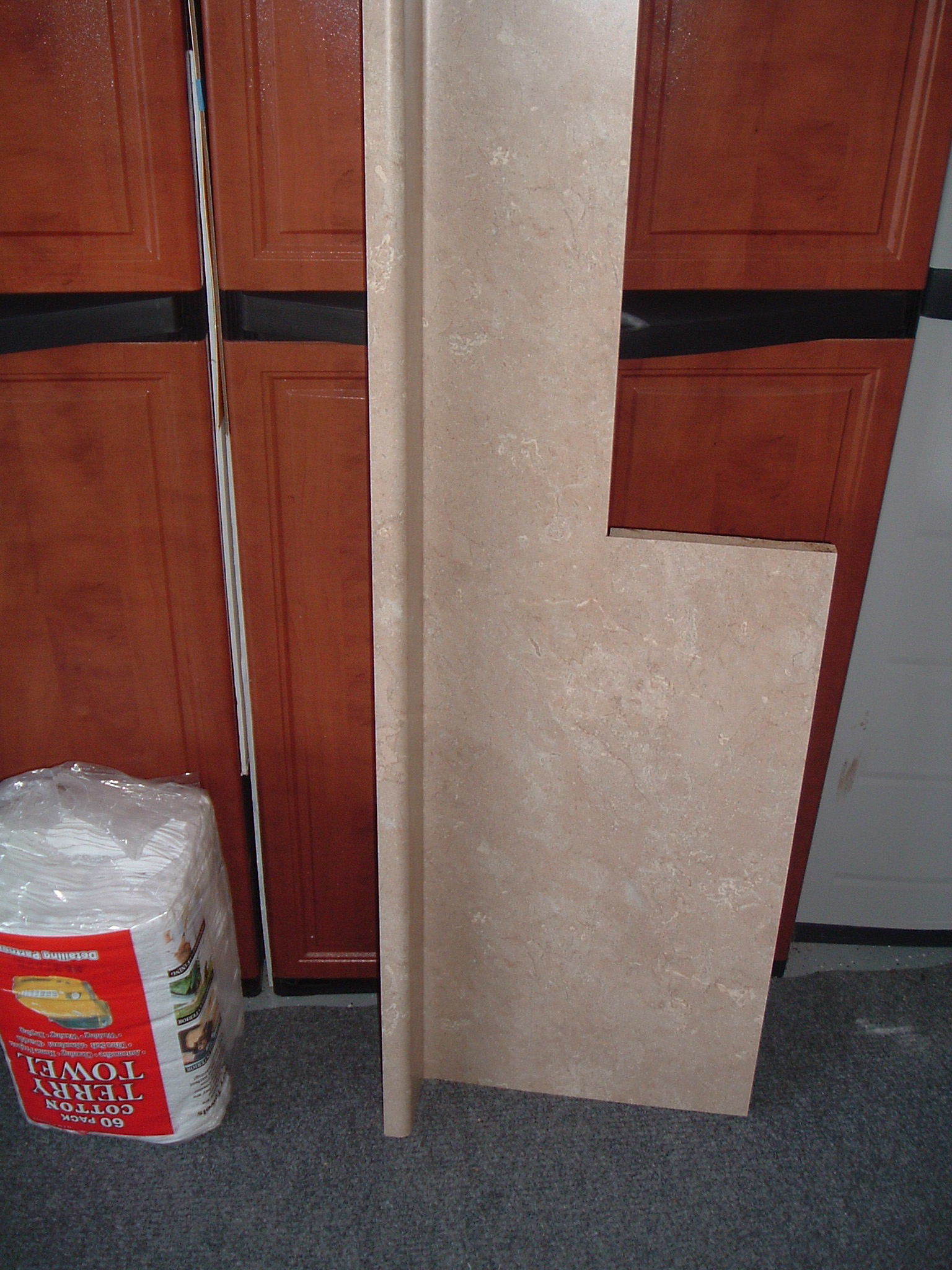

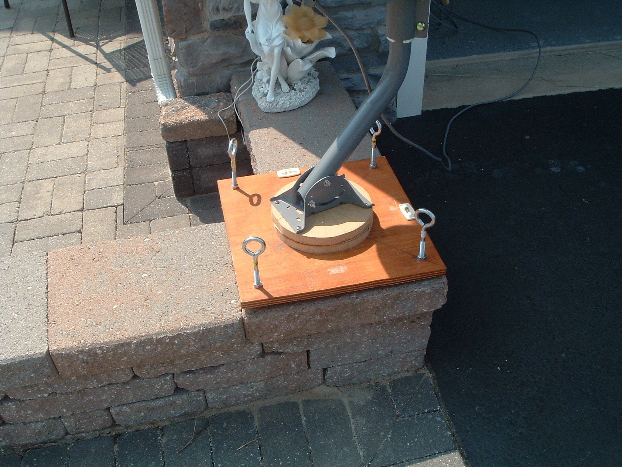

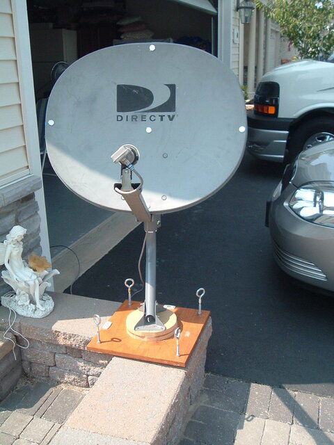

As I mentioned in the earlier post, I did use two pieces of formica counter top faced together to make a quasi-lazy susan. I used white grease in between the formica. You must make the center hole as straight as possible, if you have a drill press all the better. Check out the pics.
mikelib
old school:
I assume the initial idea was to check C-band LOS from various locations on the property.
The lazy susan idea requires three adjustments to go from bird to bird:
(assuming you start out with the base leveled)
- spin the dish for azimuth
- adjust elevation
- twist the feedhorn for skew
Tron's Porta-BUD idea requires nothing once dropped into place.
You just level the pole and rotate the base to proper direction.
There after, azimuth, elevation, and skew are handled by the mount ('n motor)

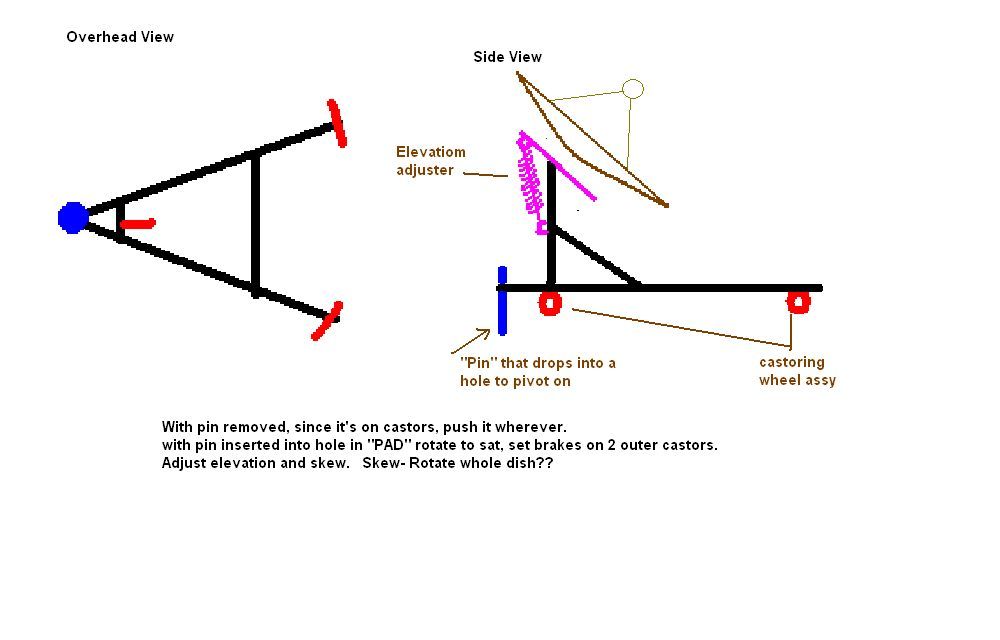

See Attached - Heres an Idea I had a while ago, but never did.
Think you could use your industrial Lazy Susan Turntables to do the skew maybe.

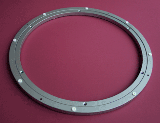

looking for a lazy susan type base? one comes to my mind...
