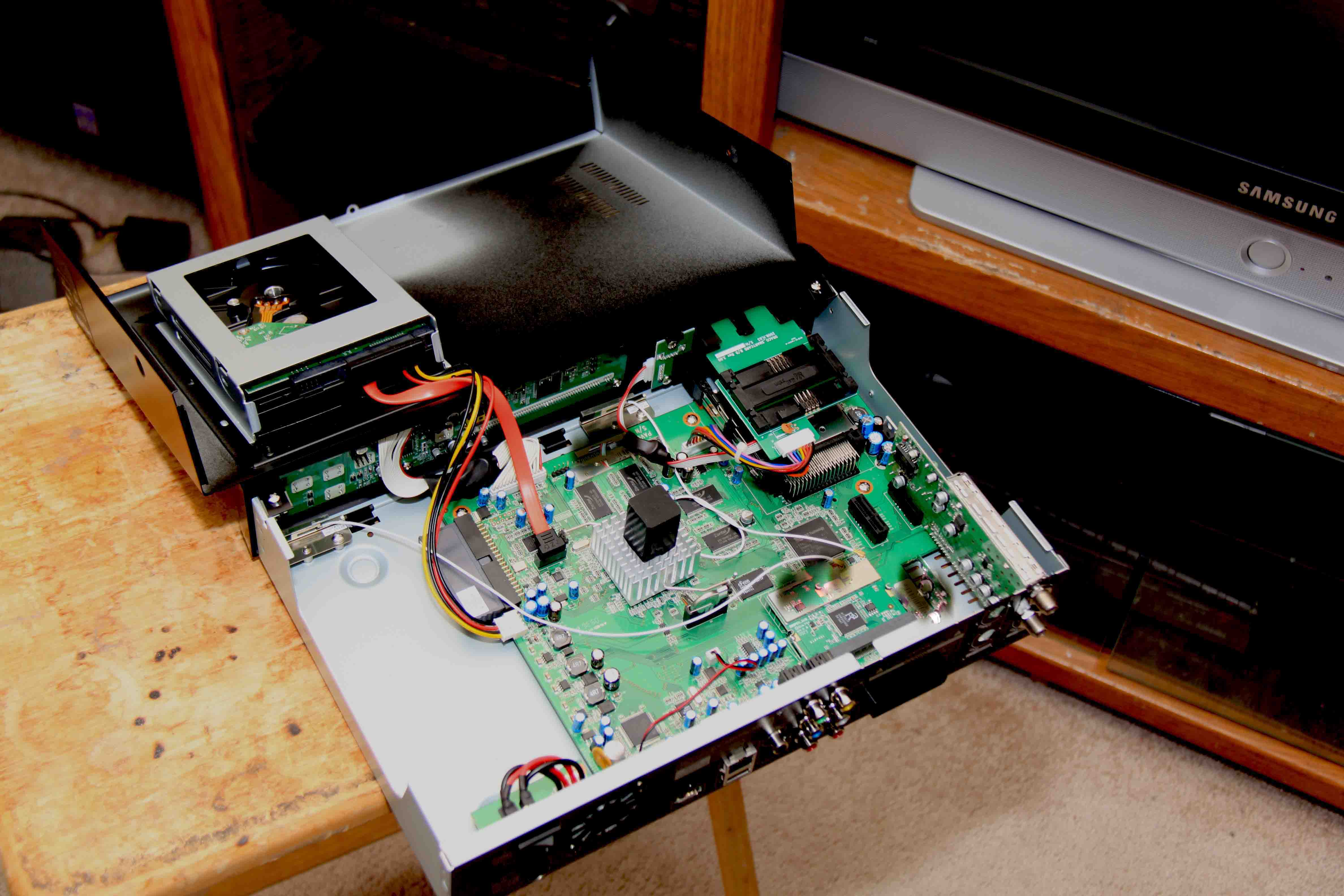

Are you sure it is the external power supply, loose connection on the multicable (whites and black) plugs in the AZbox itself is quite common. Pop the top off and reseat them.

Yeah it is the outside power supply I put a meter the power supply is getting 120 in but coming out I am not getting 12 volts or 24 volts out, and it blew while I was using it I heard it when it blew..
Plus the green light on the outside of the power supply is not on. It is the power supply

Incidently the main board in your box is some upgrade on the ones I have seen. I've not had a Ext power supply apart so I don't know how serviceable they are.

maybe its just my imagination but it sure looked like some serious smoke residue on the inside of the lid of your unit. also a couple of white wires looked really blackened and crispy. i hope its just the picture is not clear. if the wires or circuit boards do look damaged i would suggest asking for a warranty replacement of the entire box also. you never know what other damage has been done and show up a year from now after the warranty has expired.
