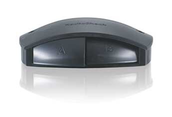

an A/B switch like that is asking for trouble....do you have the same problems without the switch there?....there should not really be ANY switches between your receiver and the motor....it should be a direct cable run....switches should come after the motor....

One of these (pictured) makes a difference, too? Well, I did have issues with resetting the motor even before I put this switch in place, though...

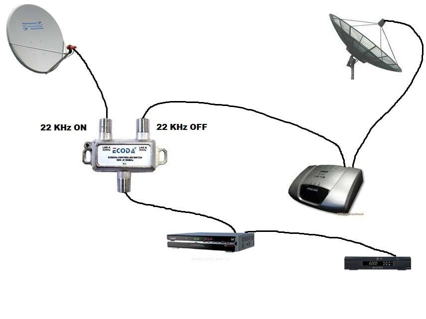

I've read many posts, and I've found somewhat contradictory opinions. Or maybe I'm not interpreting well what I read. Since it's a common belief an image is worth a thousand words, let me show my current setup. I just installed the ECODA this afternoon, and I haven't moved the dishes much (they are covered in snow :-(
So far, I am getting signal from both dishes, without having to switch signal with the A/B input selector I had before in place of the ECODA (first pic).
My first question is: is there anything wrong with the current setup?
My second question is: what can I do to solve a possible issue with the current setup, and what hardware can I use (second pic) in order to do so?
I also would like not to have my second receiver looped - I'd rather have a straight cable from the dish, so I can have on the SV4000 all the channels from whichever sat the CS8000 has the dish pointed at.
Feel free to download the pic and draw lines.
Thanks, guys!
