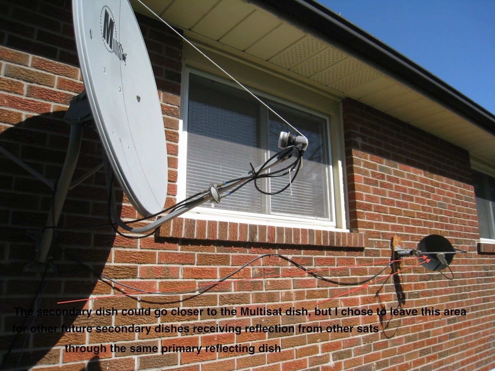

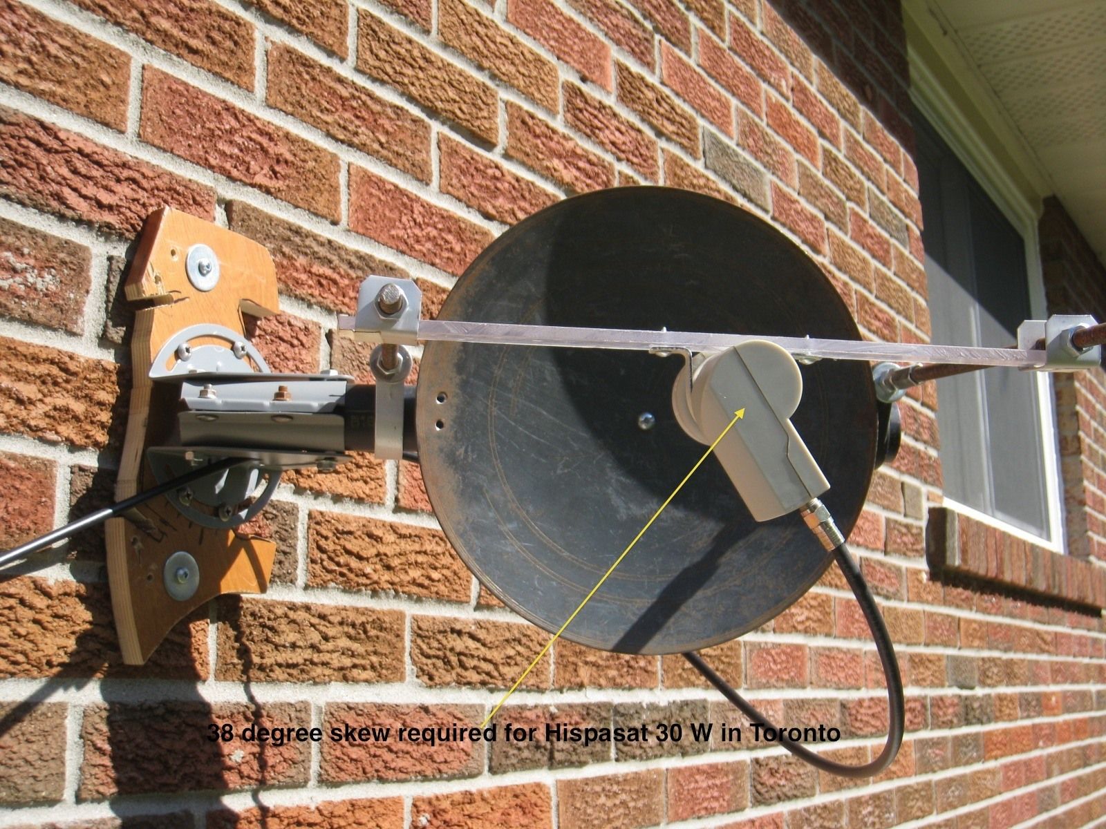

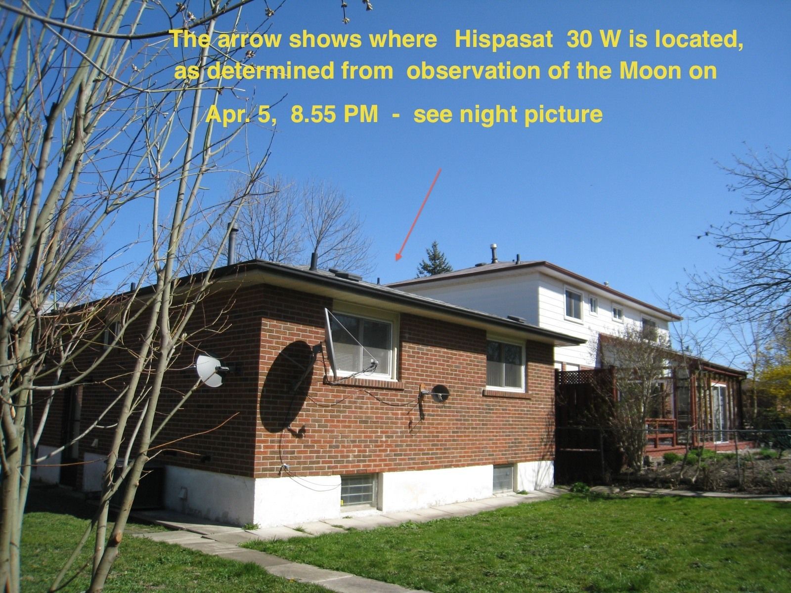

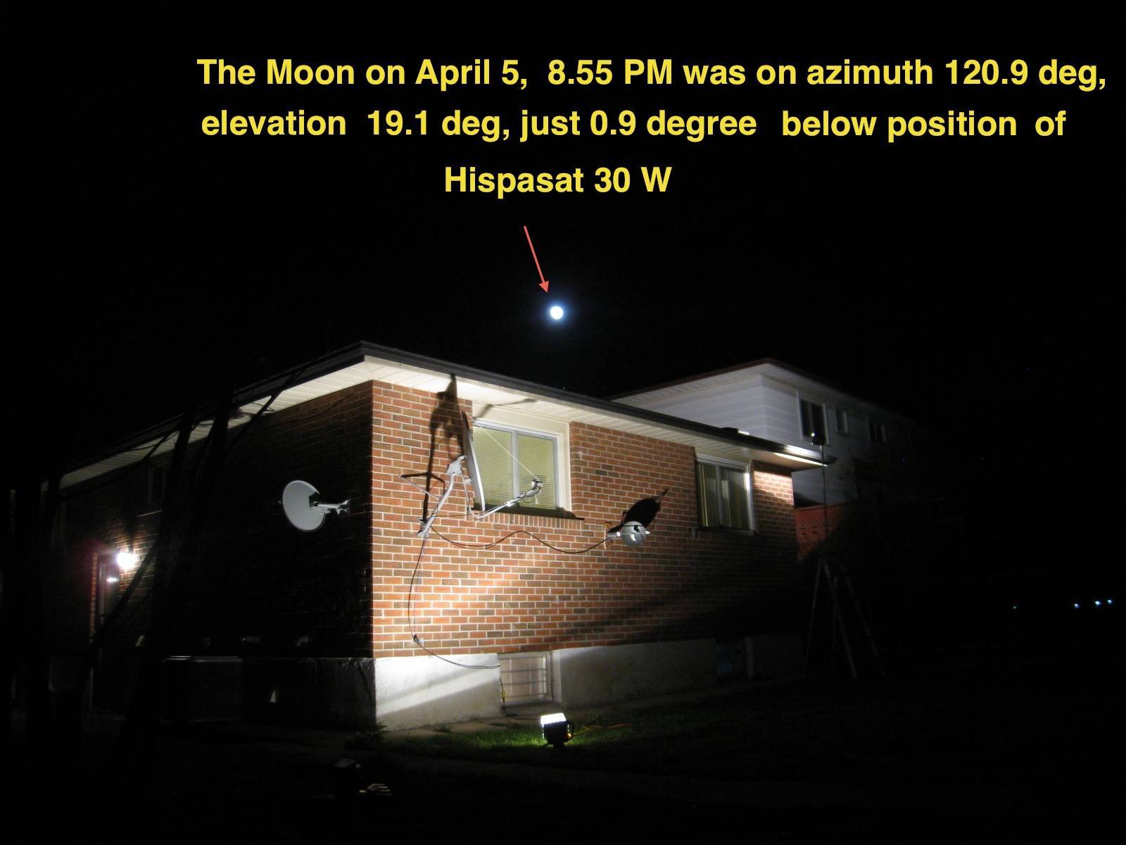

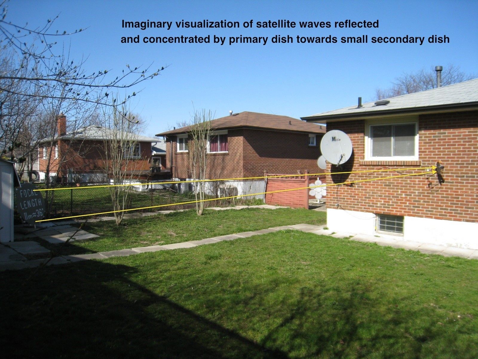

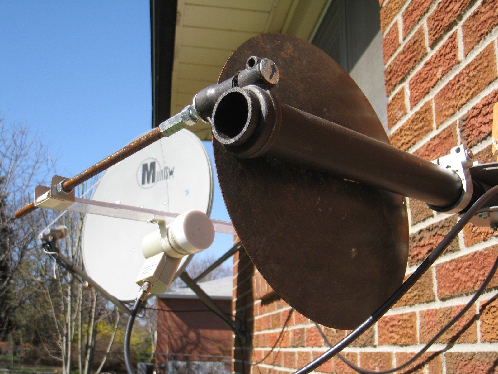

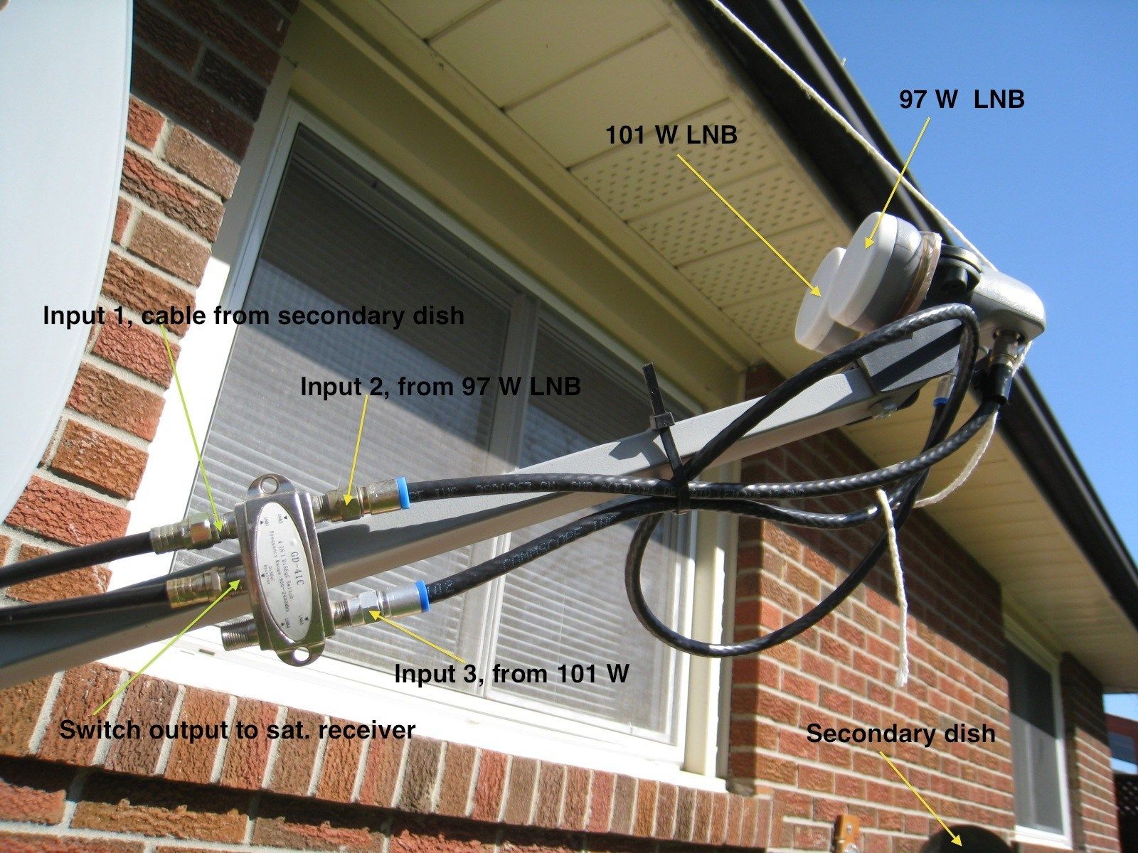

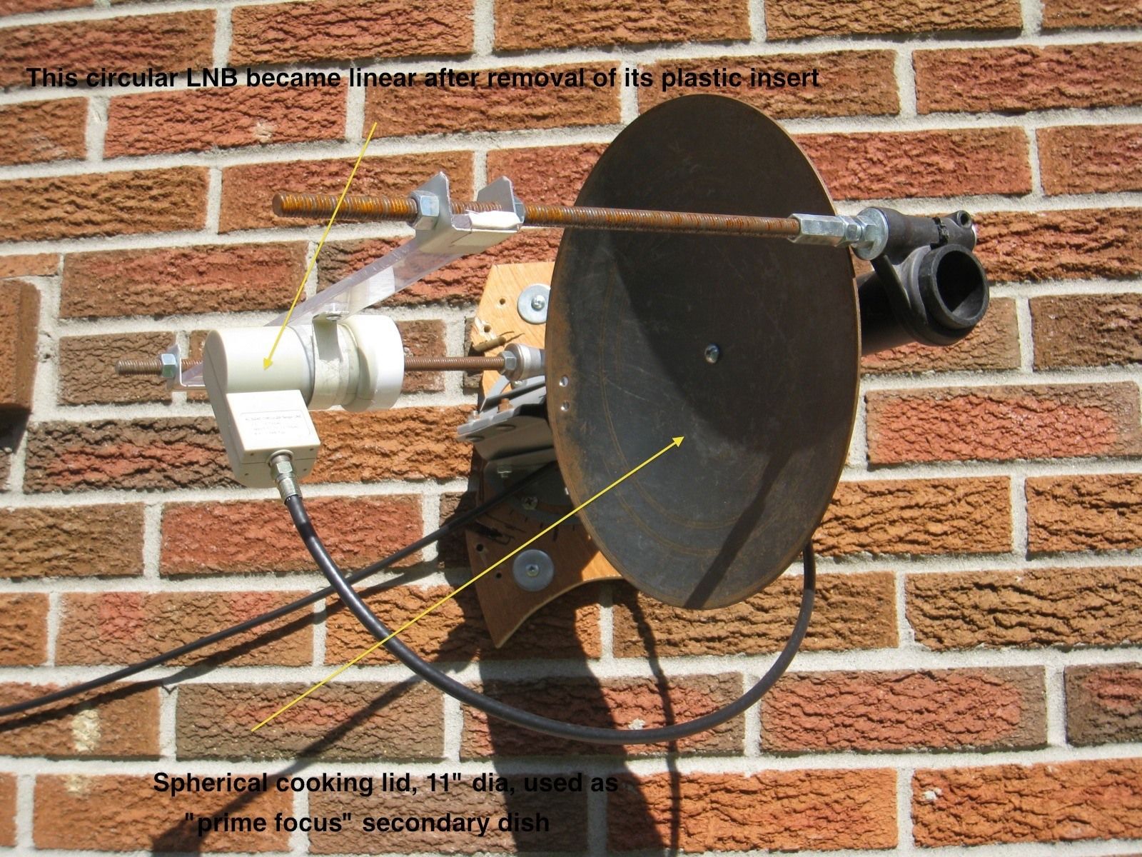

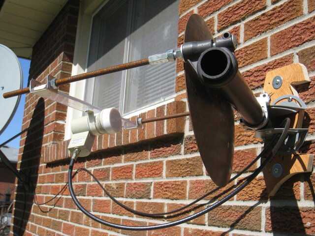

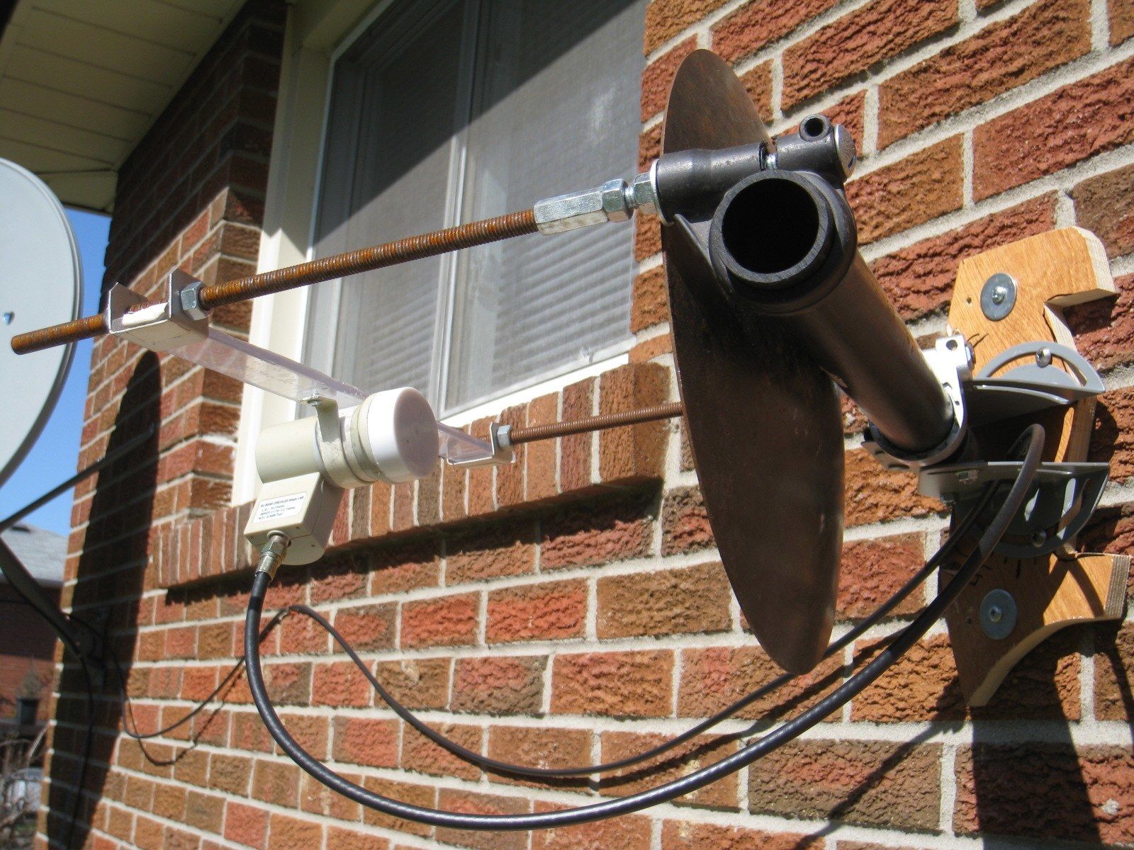

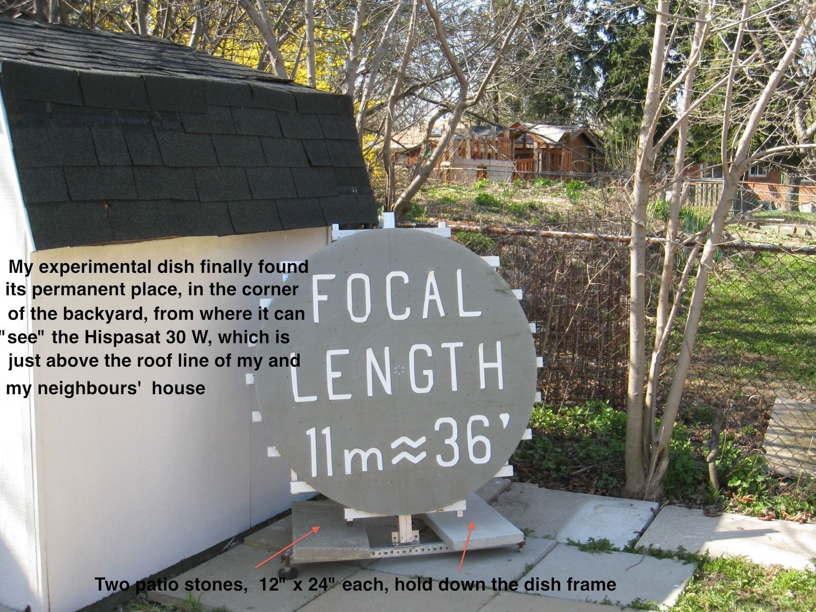

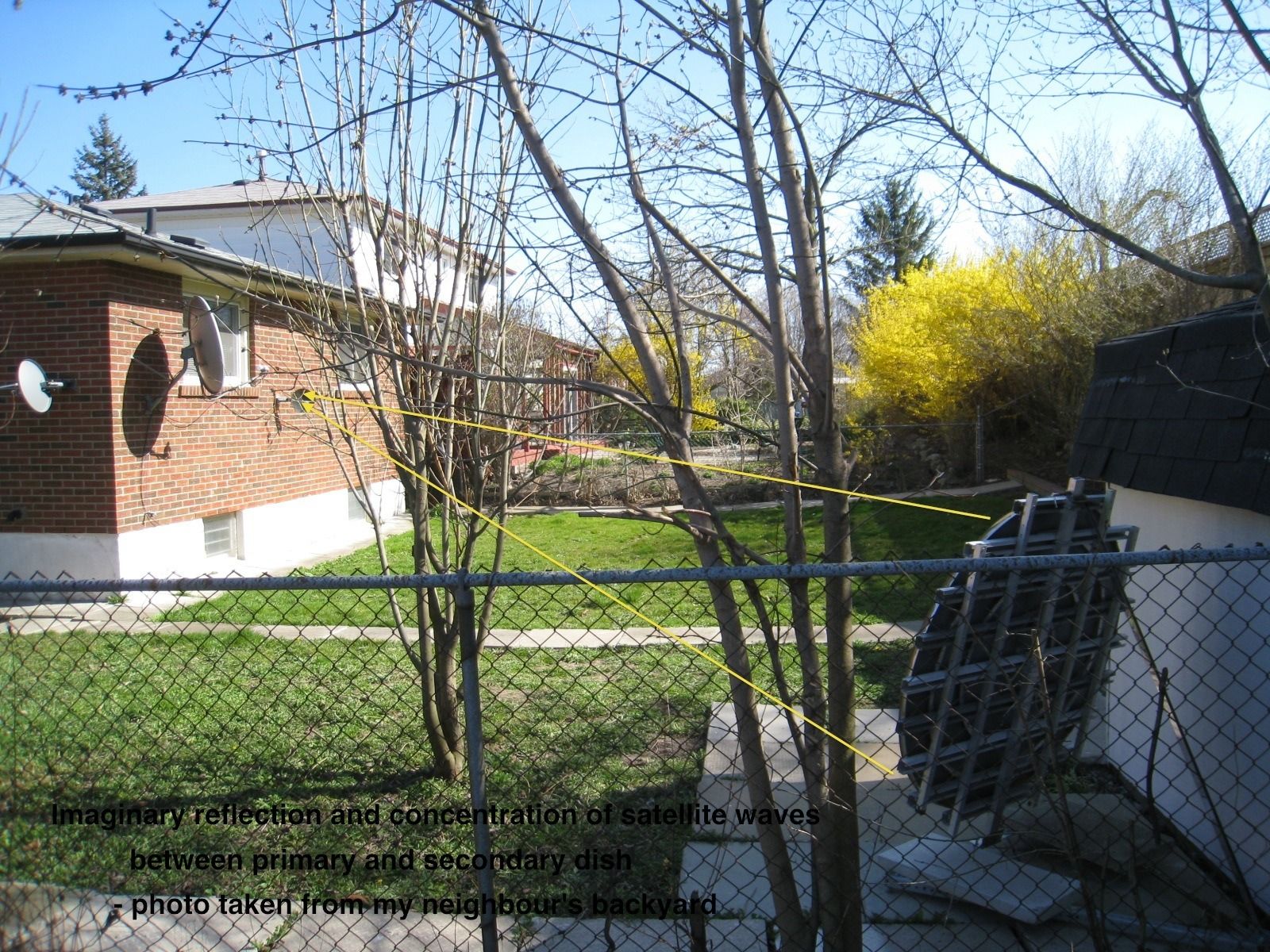

A few months ago I conducted some tests with receiving satellite signals through double reflection, using primary dish of very long focal length and secondary small dish. I described those trials in posts at satelliteguys.us, here, but these trials received less than moderate interest, probably due to their perceived little practicality. I tried my home-built long-focus dish in receiving programs from 97 W and 101 W, and I got it working. However, receiving of these sats proved easier by traditional methods (2 LNB's and a switch). This gave me the following programs: Pentagon, Dutch BVN, and TRWAM (enjoyed mostly by my wife, but also by me) - from 101 W, and Russia Today, AlJazeera, Jewish News 1, Serbian RTS, Padre Pio, Press TV - from 97 W. Recently I upgraded the palette of our programs by adding Hispasat 30 W. This addition would NOT be easily possible without usage of double reflection system. The strength and quality of most of Hispasat transponders is almost the same as S&Q from 101 and 97, however, some channels are weak and pixelating. But let's the photographs speak (recently I learned how to add text to pictures). Cheers, polgyver IMG_3733.JPGIMG_3735.JPGIMG_3743.JPGIMG_3747.JPGIMG_3748.JPGIMG_3751.JPGIMG_3752.JPGIMG_3753.JPGIMG_3754.JPGIMG_3762.JPGIMG_3765.JPG
other than making for rather short coax runs from where you have LOS, what is the advantage of the long focal distance? I see you shortened the run by 36 feet (?) and the dish is that far from the house. Does it act as if it were a bigger dish or ? Sorry I did not follow your previous thread if you explained it then.

For me 30W is only 5-6 degrees off the horizon. Placing a reflector such as yours up on a tower say 40' high would allow a much cleaner view of the horizon; kind of like the old parascope towers used by the telecommunications companies in years gone by. Would be really cool to be able to move the remote reflector (remotely) to tune in other nearby satellites focusing the signals on the prime without moving it.
Have to remember the 90 degree polarity shift (skew) from using an extra reflector.
http://www.satelliteguys.us/free-ai...iving-fta-signal-after-double-reflection.html
The link to this previous thread is here. There is some advantage in avoiding running coax through the backyard.No need to dig a groove in the grass and bury the coax.Also some satisfaction from making something from the scratch (not using factory made dish) and seeing it work. Cheers, polgyver

did you use 2 secondary dishes when you had it set up for 97 and 101, or did you use 2 lnbs on 1 secondary dish?
I used 2 secondary "dishes" (spherical lids, small), each with own LNB. It was temporary, one-time-use setting.
That looks really fun! How is the large dish made?
I built a frame with aluminum square tubing and used curtain tracks, to which I fastened concentric aluminum rings of various height : outside ring was 3/4" high, and inner rings were gradually lower, the central disc was about 1/4" thick. To such a structure I glued ("no more nails" glue for metal) thin steel plate which took its concave shape with very little pressure. It has 46" dia, and is less than 1/2" deep. Unfortunately, the sheet metal was not pristinely flat, it had some distortion, and because of it the focal point ("sweet spot") is "hazy", big, not well defined. It forced me to use secondary small "dish" to collect the waves more precisely on a LNB.
