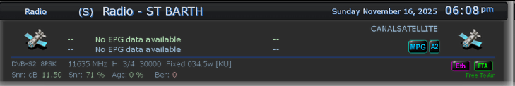

The weather finally cleared up this morning and I was able to get reception. Mikekohl you are right, you definitely need pinpoint aiming . I had to raise the elevation nearly a degree. By the way, I did a scan and there is a new channel in the clear CCS Movie. My favorite channel is Radio St. Barth
Radio St Bart is on 11635/H/30000. It's one of the weaker transponders, so in my case the weather has to be near perfect to receive it.
Thank you.. My receiver was showing St Bart @ 11099H45000. Not sure if it used to be there or something got screwed up.. Thank you. I had 11635 arleady scanned in. I had to delete the stuff @ the old frequency, and then change the radio stuff on 11635 to TV in the service list to get them to show up without having to go into radio mode. I wanted to listen to St Barth to give it a listen... Chillin to it now... I also had to re-hide all the encrypted channels. Slick now.

I am getting 11.00 dB on 11635h

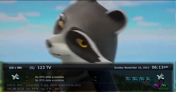

10.25db on the hard one 11100v
