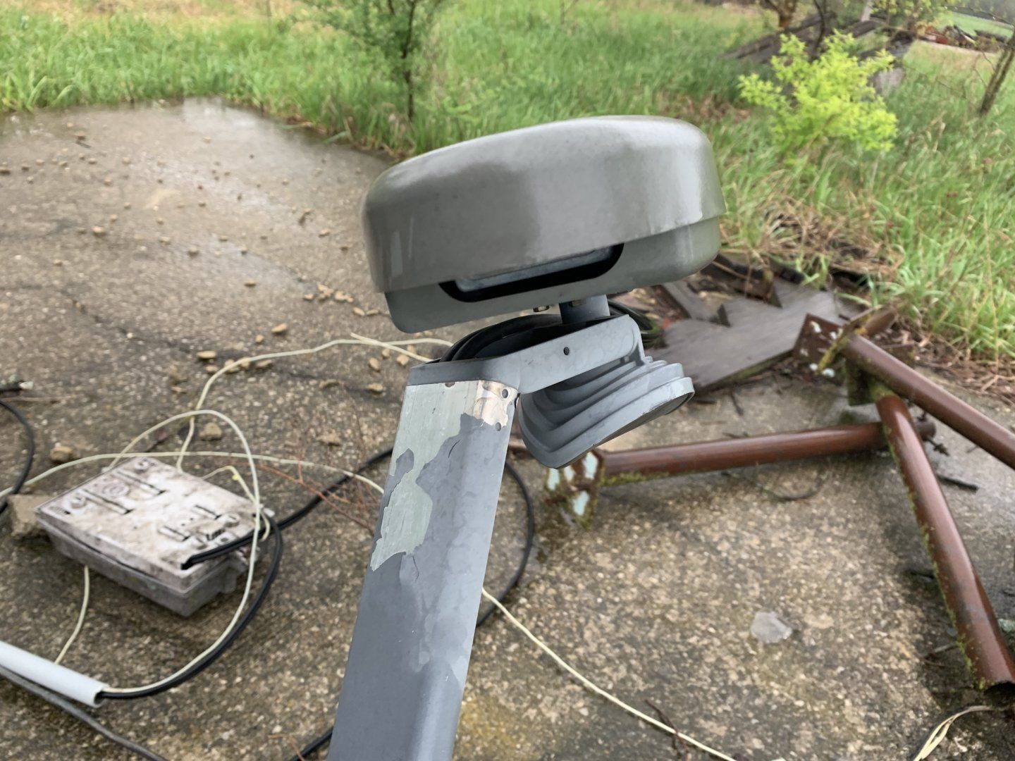

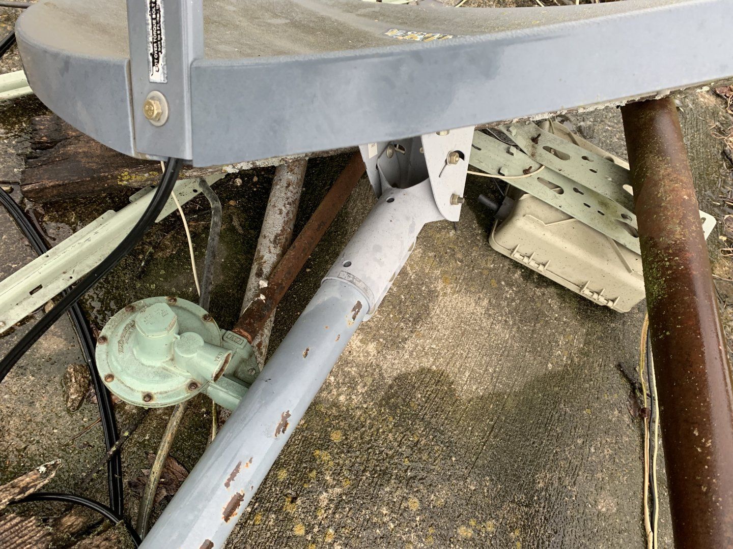

Not sure; it's near my house and I saw it laying on the lot of a house that burned down a long time ago. I'm not sure I should have even been on the property but it looks abandoned. If the dish isn't completely roached I'll try to find out who owns the property and ask them if I can have it.
The 84E dish has a special designed scalar. I see it in the pictures. I would suggest you use that if possible. There is a chance the LNB attached to it is like one I have that has a V port and a H port to use with a simple multi-switch. That dish may be FTA ready :)

Yep, if you don't use the special scalar, any offset lnbf you use in it's place will only see the middle/circle part of the dish. In other words, you won't be effectively using the entire dish, only a smaller portion.
So in other words, I need to cross my fingers that the original LNB still works or else the dish is trash?

No, the scalar has a c-120 flange mount on it. You can mount any c-120 flange ku lnb on it that you'd like. Even if the original one is good, AND is a H/V model (not all were) they were like .8dB noise level. So not all that good compared to newer types. The lower the better.

If this is an 84E, would it be a 1 meter?
.84cm, which means it's basically a 33 inch dish. A very good one however. Where these elliptical dishes excel, is in receiving multiple satellites at the same time. You can mount a bar in place of the center lnb, and mount multiple lnb's along it/ above /below to work for your location. Realize that the dish doesn't skew as it's built, you skew the lnb(f). Though in the past I have mounted a fishing boat seat ball-bearing mount between the dish and the mount, and used that to skew the dish. You have to drill a hole and thread it for a self-tapping screw, so you can lock it down in the best position after skewing. The boat seat mounting hole slots are almost perfect from the factory. You only have to ream them out a little bit.
