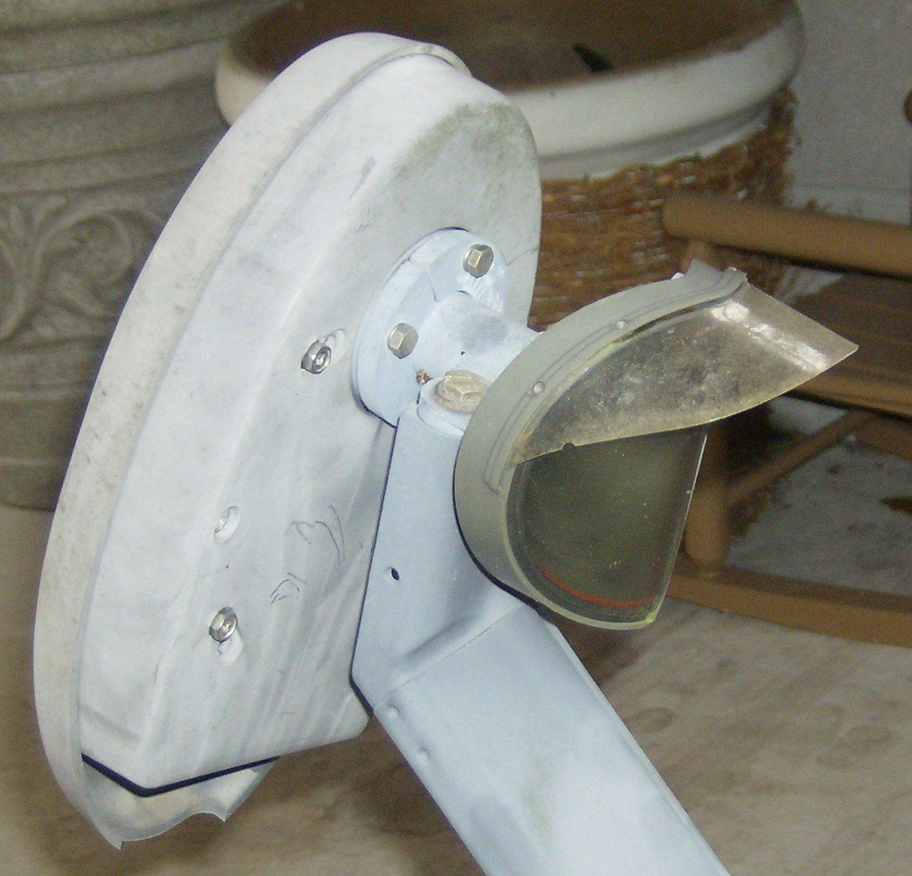

Looking at my feedhorn/LNB set-up, is it as easy as removing the "Dove Bar" cover and swapping out the LNB's, or will I need to rig up something a little different?

i beleive the whole thing will remove (dove bare and feedhorn) when you take out the bolts . then the new lnb will bolt directly to the holder . I also found that these hughes/direcpc lnbs are a good match for the dish.

Looking at the mounting tabs in both pictures....
it appears that the horn bolts down directly to the end of the dish's arm.
So, there would be no way to skew that beercan, unless the same slip-attachment is present.
In other pictures of Primestar lashups, I assumed the mounting had a U-clamp over the LNB neck (just a guess - I don't have one).
That would certainly let you adjust skew on a round dish.

Okay, the best answer I can come up with, is that the beercan and horn pictured above does have a slip connection between them, and the LNB can be rotated while the horn is bolted down solid to the dish's arm.
hrmmm... on round dishes , it would be sufficient to skew the LNB some way.
The horn could be rotated, and the dish should still work okay.
On the -quite wide- dishes , the horn could not rotate relative to the dish.
And, for the -wide dishes-, shouldn't the entire dish be skewed to maintain alignment with the satellites?
I don't think skewing just the LNB on a -wide- dish is the right thing to do.

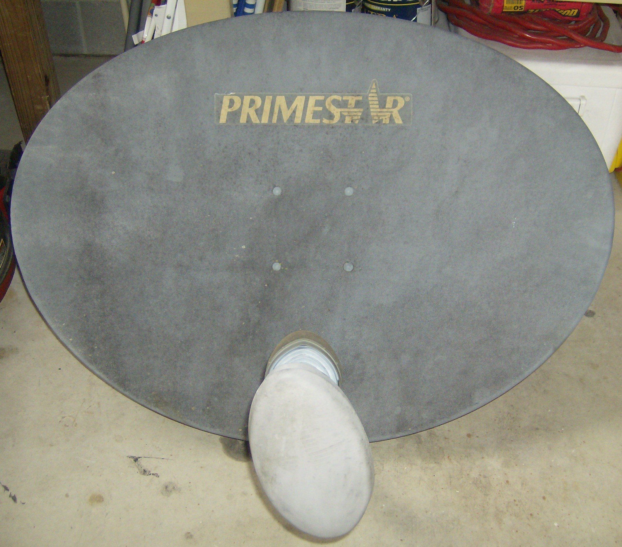

My dish (pictured) does not skew, but the LNB does. Is this considered the "oval" or "egg" dish?

I have three elliptical P* mounts that skew. I think that they were the mounts that the HITS system used though because those were the mounts I got from my former buddy at Charter cable. But there are mounts that skew for the elliptical dishes.
