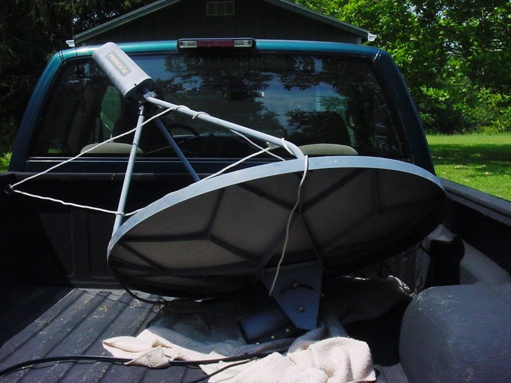

In my search this past week for a 4DTV receiver locally, I finally found a Primestar dish. I never paid that much attention to them before becoming a member and reading about them here. I brought it home this morning. The former owner said it was used briefly in place of an old BUD that leans against a tree now.
These things seem to ruggedly built compared to the FTA dishes I have. I just need to locate some 3" pipe. The one it was on was so rusted I didn't bother to cut it off.
I'll be doing some research on old posts to learn about the LNBs and tips.

you got the big dish version :)
Primestar had 3 model dishes
37x27 oblong
40x30 oblong
1m round
That will be a nice dish for a fixed spot :)
* congratulations *
I think that model would be my first choice.
Appears to be the round dish, not the elliptical one.
Finding a larger dish of that type, such as the 1.2m, is relatively rare.

I measured it at 43" tall by 40" wide. I think it will gather a good signal. I think I will point it at G10 to try it out and eventually to X4 when I find another DSR905.

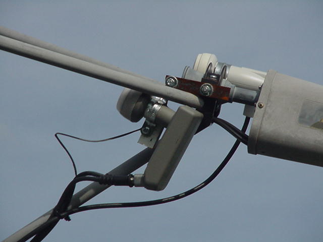

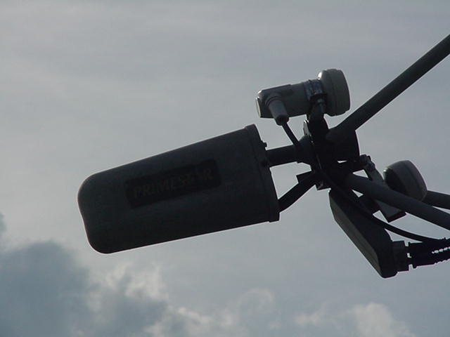

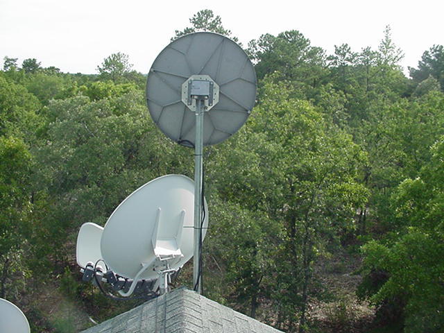

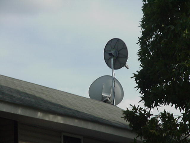

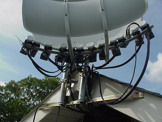

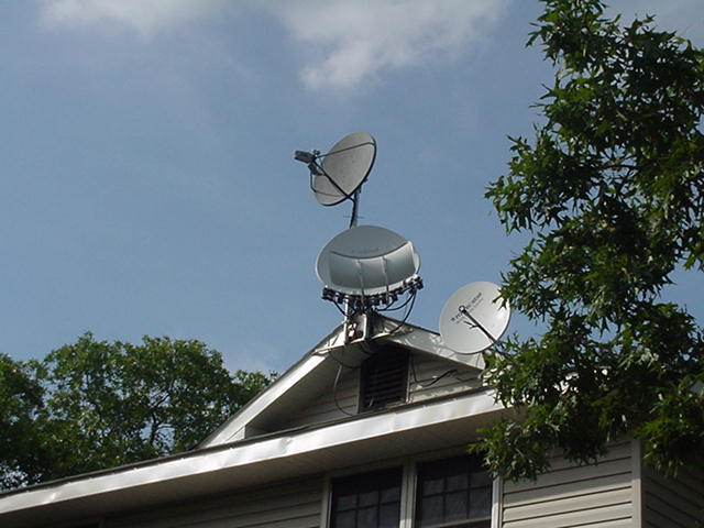

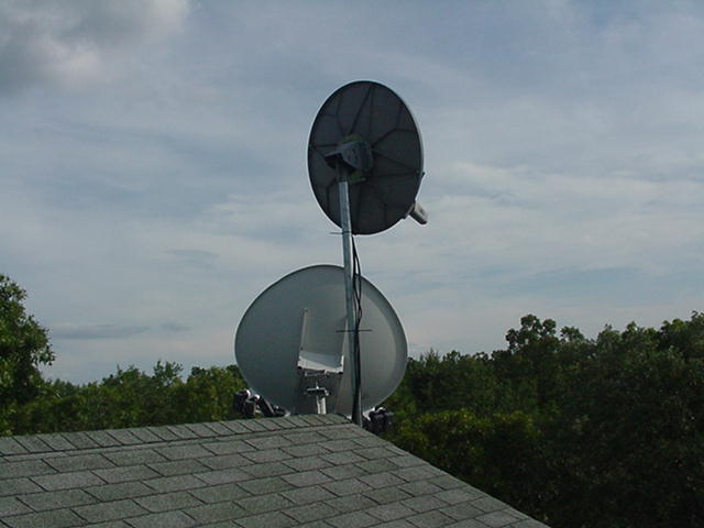

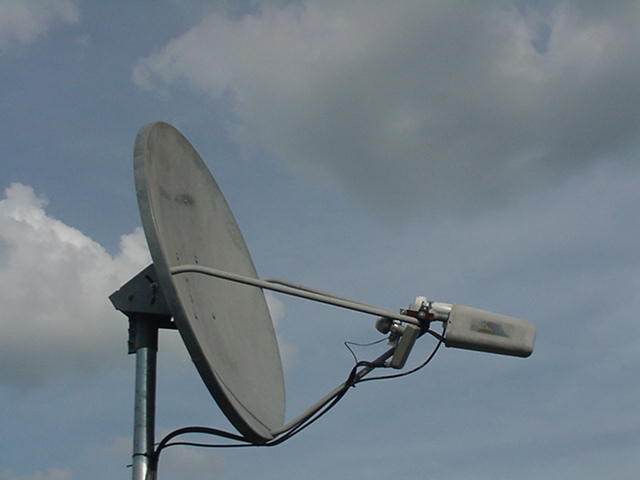

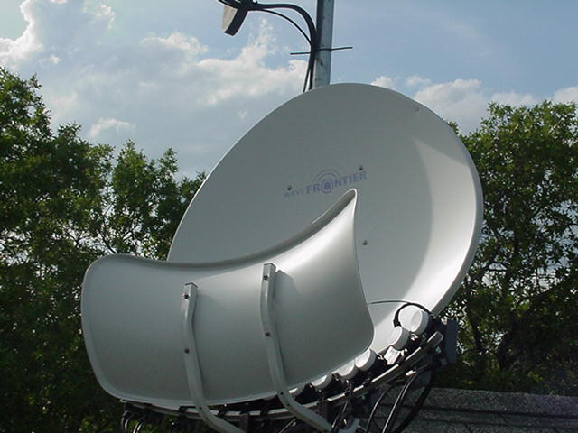

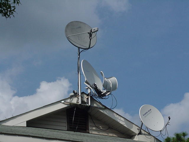

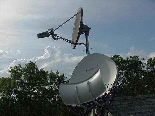

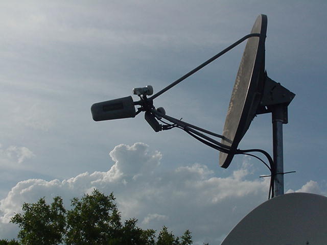

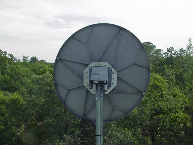

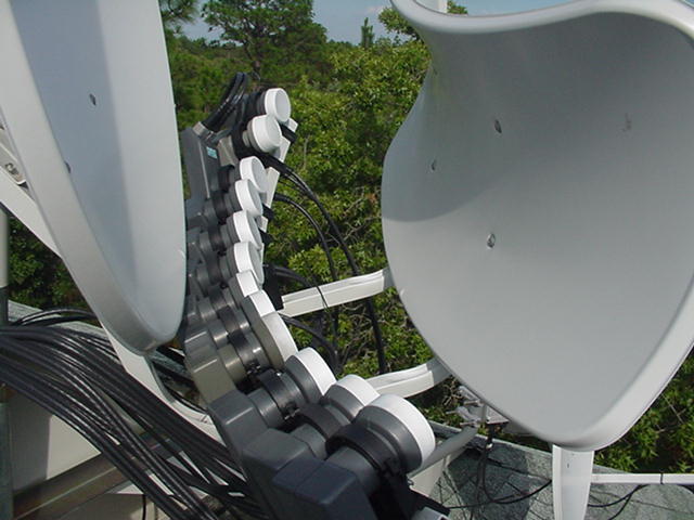

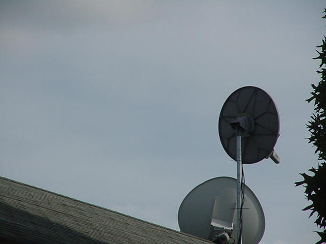

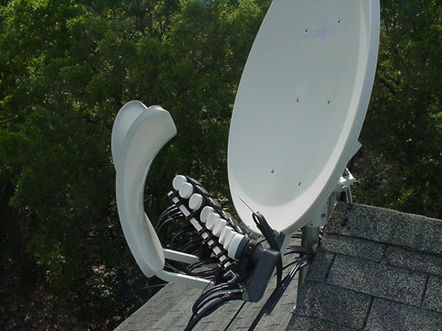

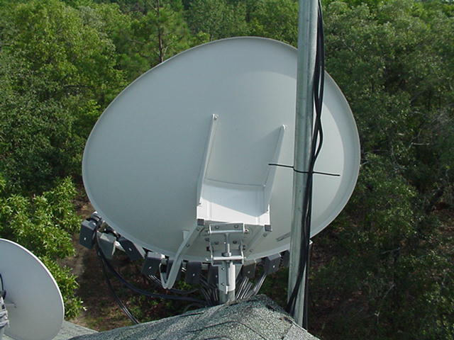

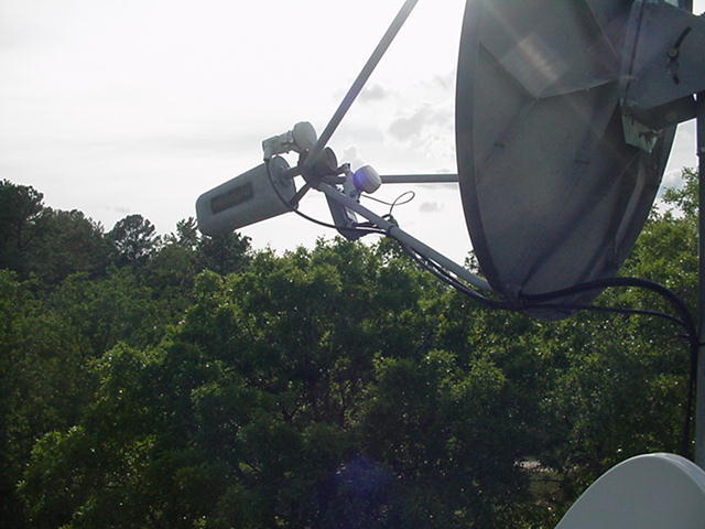

I have my (actually my sisters now) 1m P* pointed at G10 (for RTN), with a side strapped lnbf pointed at T7/IA7/G27 (for WSTV), and another side strapped lnbf pointed at E7 (for NASA, Angel One & audio). I think they are very Good dishes. I have a single lnbf for G27, and a twin lnbf for E7, with the P* lnbf for G10, and the P* is used for a complement of a T90 dish with twin lnbf's for 72, 74, 79, 83, 87, 89, 93, 97, 101, 103, and 113, with a reversed twin lnbf for 110.

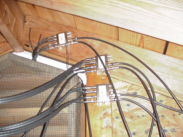

Hey Al how bout a pic of that setup if you can. I was thinking of doing the same. :)

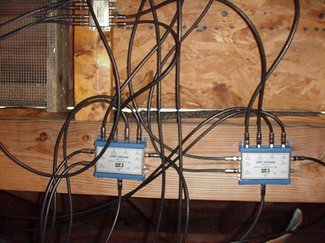

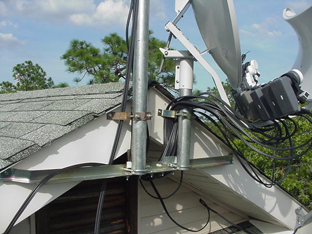

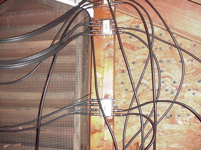

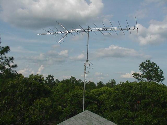

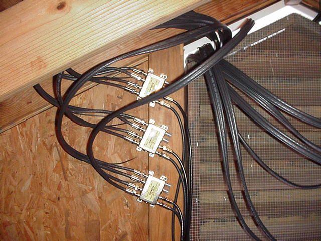

I'll give it shot, bare with me, my 1st attempt at pictures??????
Al
Edit: the first four are from the ground, the first 2 looking south, next looking north, next looking east.
the last four are the switches in the attic. 2 @ EMP-CENTAURI bx1, 7 @ Zinwell 4x4 Multi-Switches
all the remainder are from the roof of the 2 story garage/house/shop.

Hey Al!
Those are fabulous pictures!!! :cool:
You are a brave man to make all those adjustments on the peak of the roof like that.
It takes everything I have just to get on my roof. I can put it out of my mind as long as I don't get too near the edge. But you, you must have been hanging out over space tuning those dishes in.
