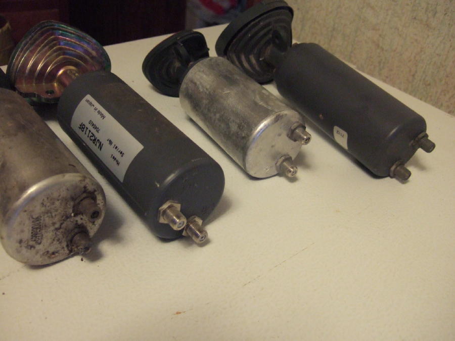

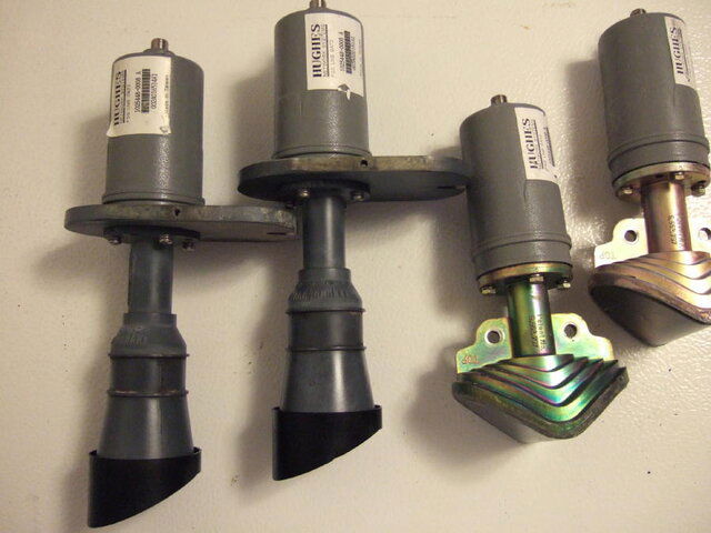

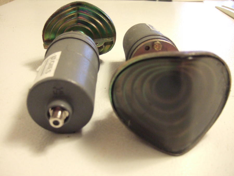

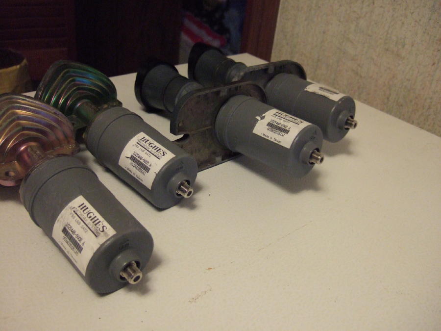

ok some more information the old primestar lnb's that i had were the two output type one for H and one for V , so i found a deal on some more single output lnb's i converted a few to fit this type dish. photos below.
the photos are: new retrofited (DirecPc) lnb's , the backs, new lnb front & back , old type dual output (H&V) lnb

both the old Primestar LNB & Newer DirecPc LNB I used are made by Hughes.
