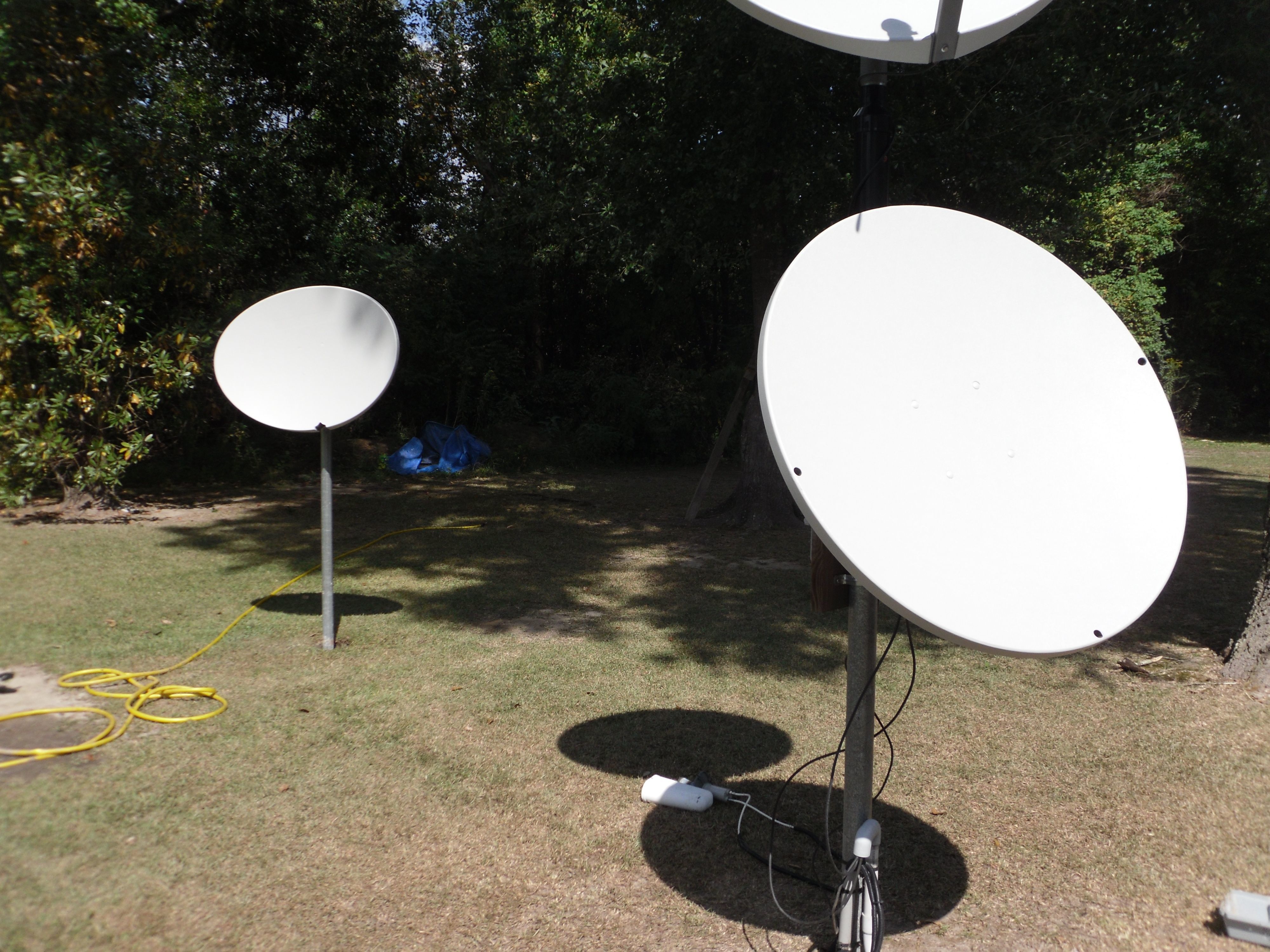

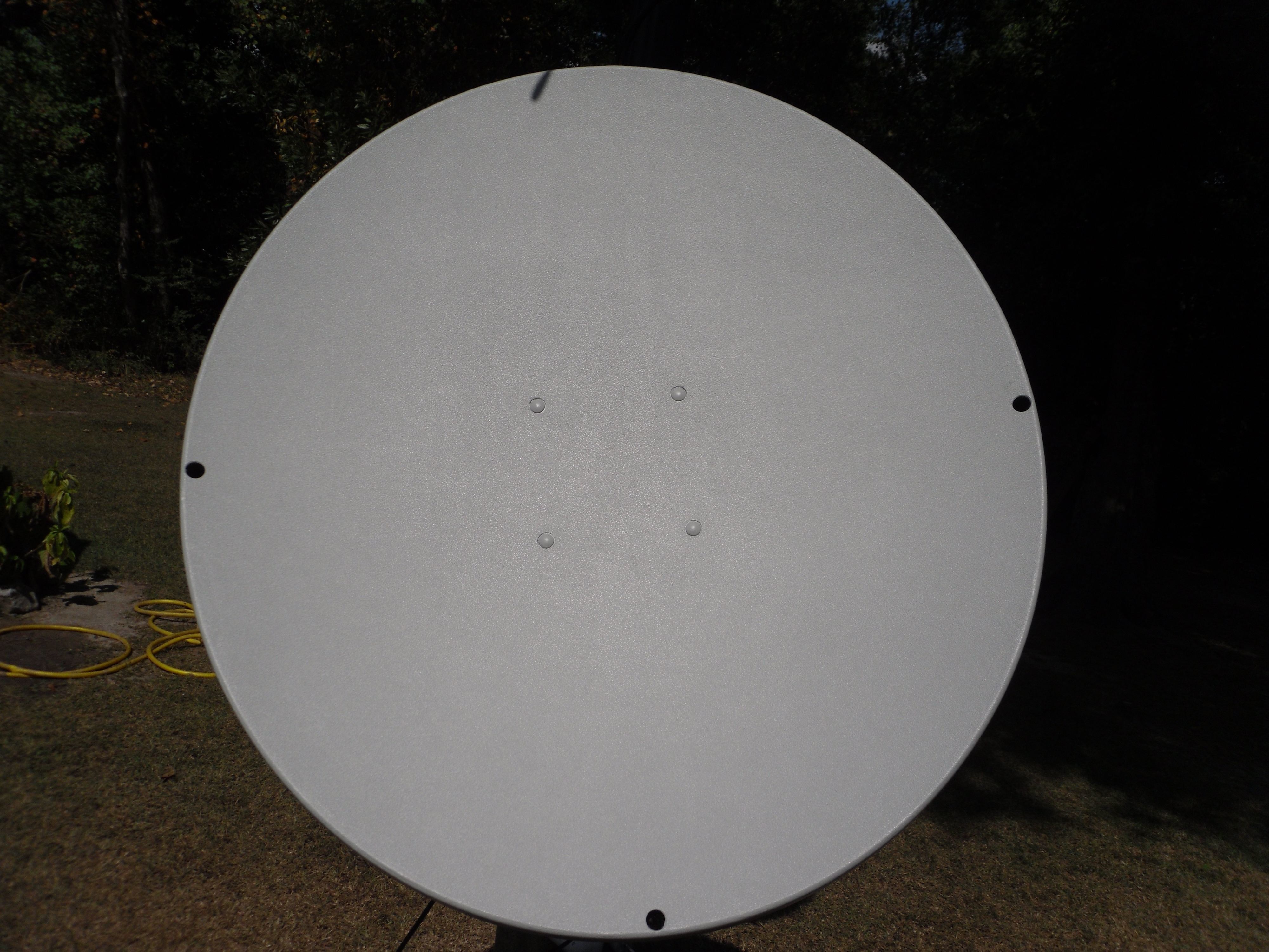

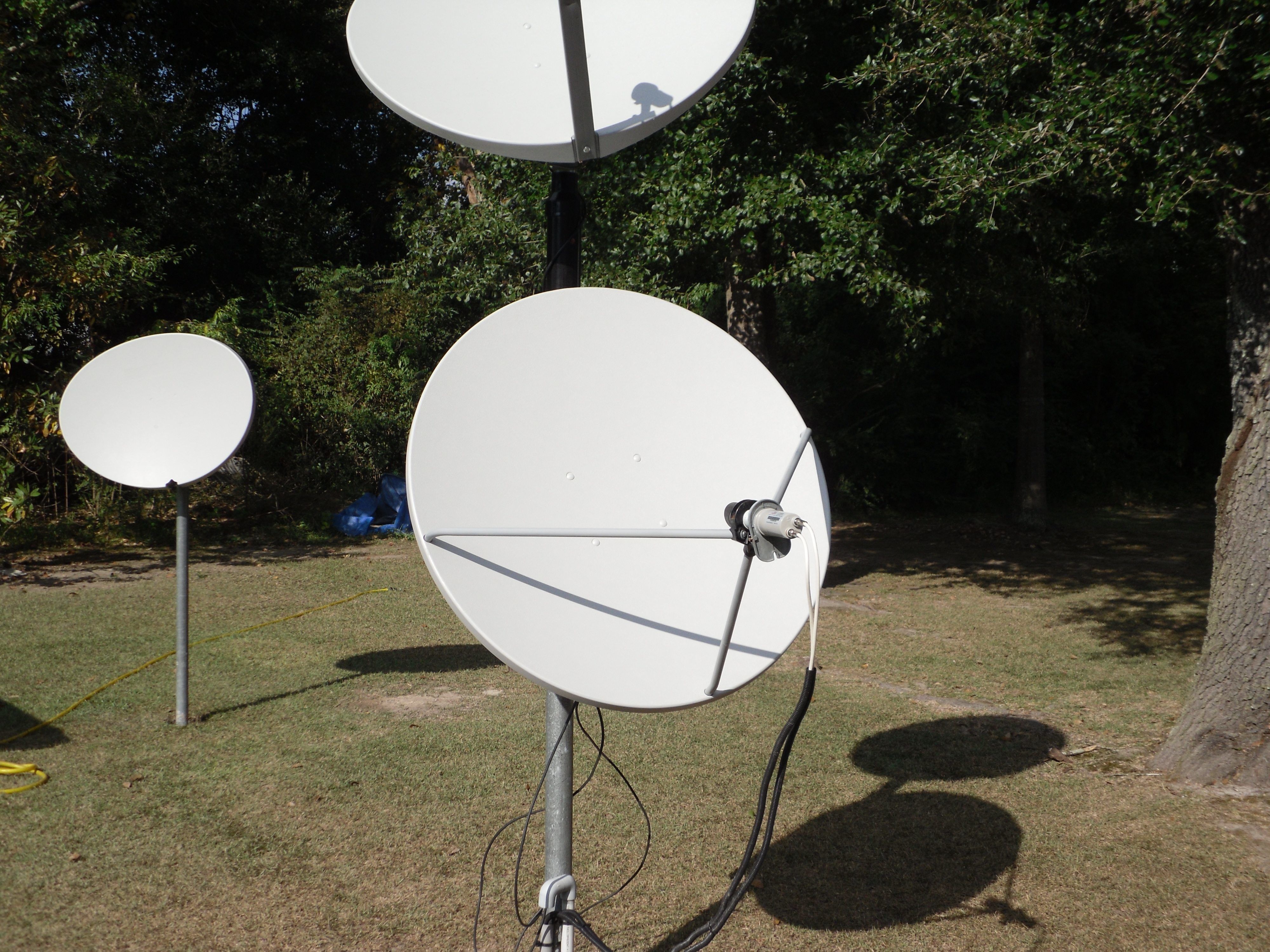

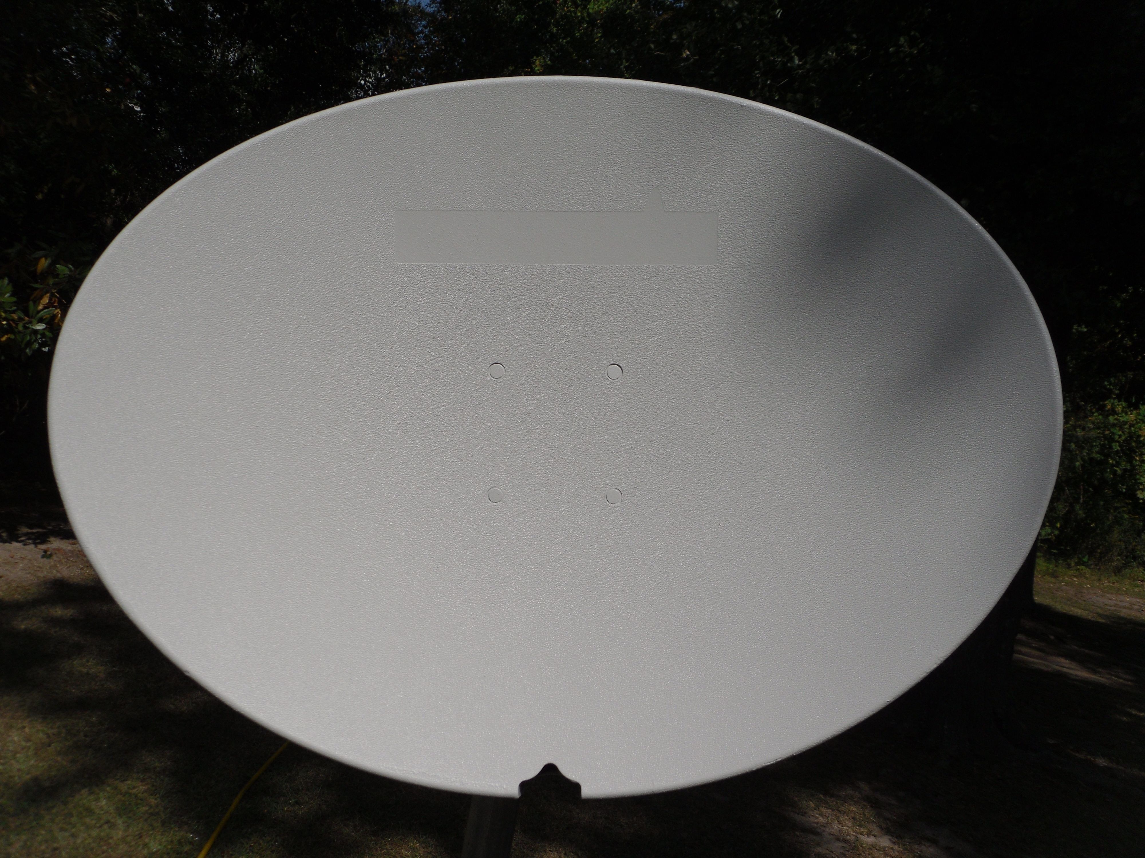

I never have really liked the finish on my old Primestar dishes, so I decided to spiff them up again, and try something new. I was walking around the Wal-Mart the other day and went into the paint section. Being a dedicated cheap ass I am always looking for cheap ways to do stuff, and what did I come upon? A gallon of Dutch Boy EXTREME ADHESION latex house paint, and at the rock bottom paint close out shelf price of 12 bucks a gallon. And it was gray! I says to myself, self, that sure would look nice on your dishes, wouldn't it? :D
So I brought it home.

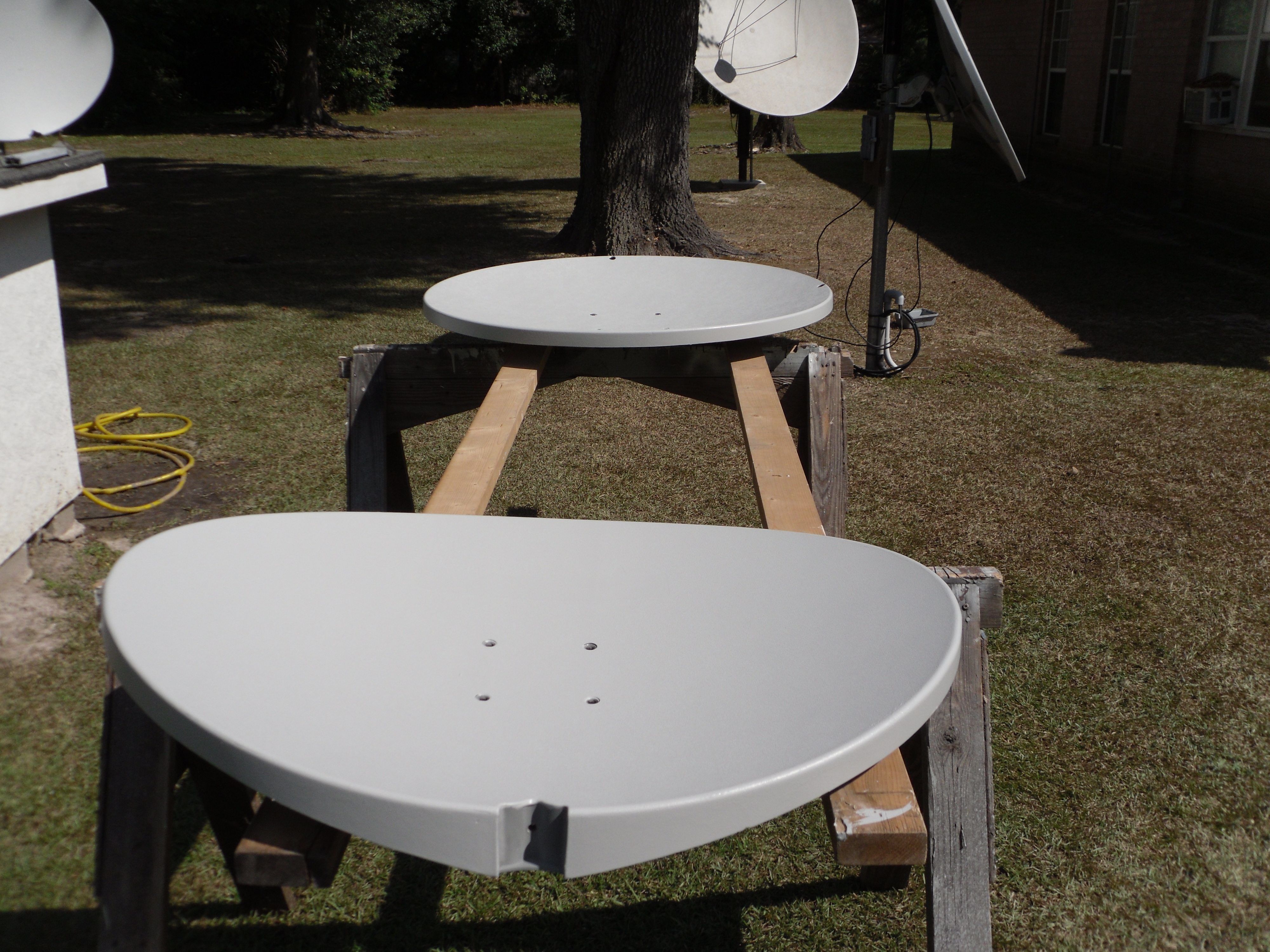

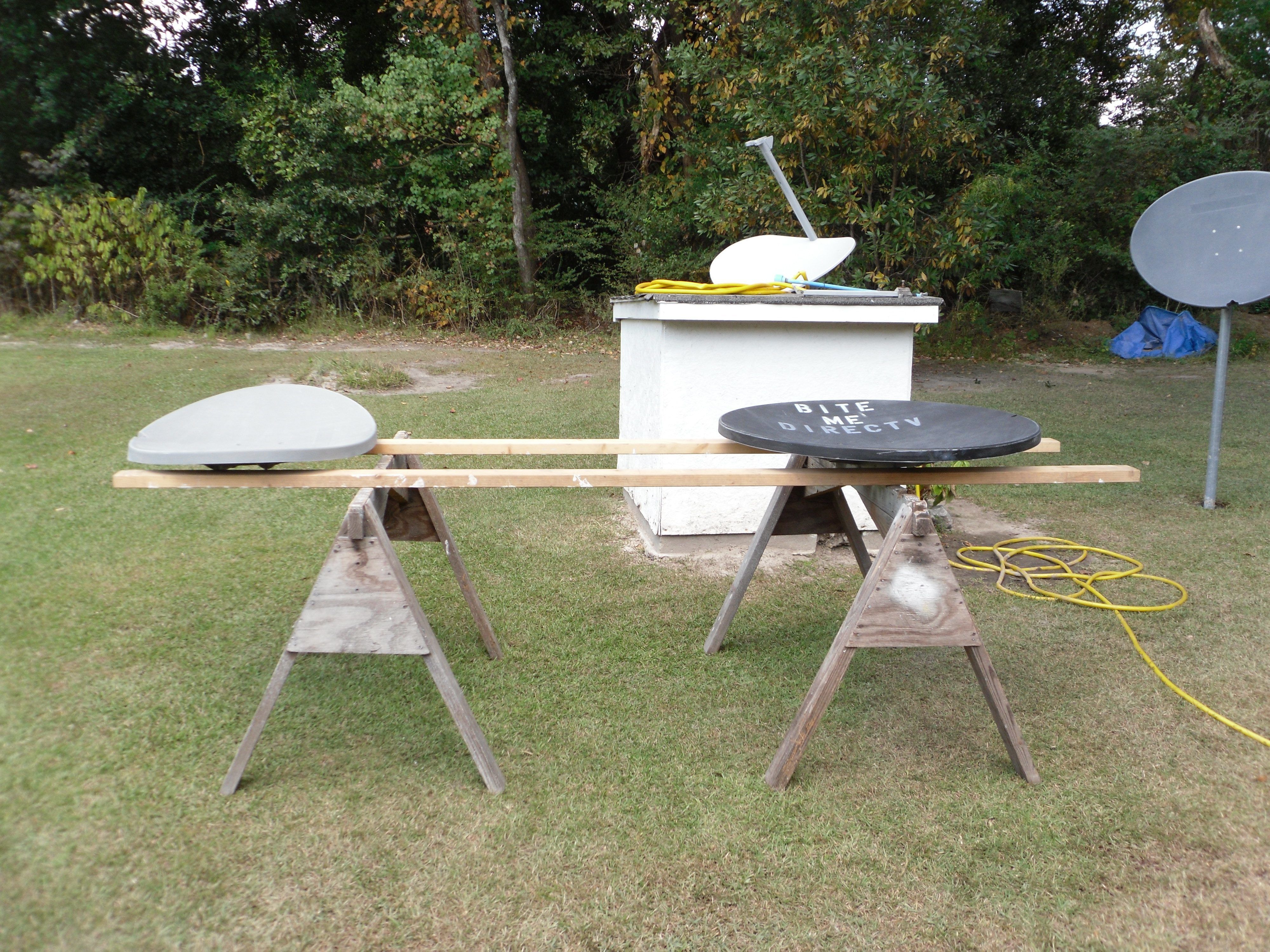

Today I decided to spiff them up. I first cleaned them all with Castrol Super Clean, that stuff will take all the grease and oil off anything. Then I cleaned with soap and water, to get the residue off. Then I let them dry while I had some lunch.

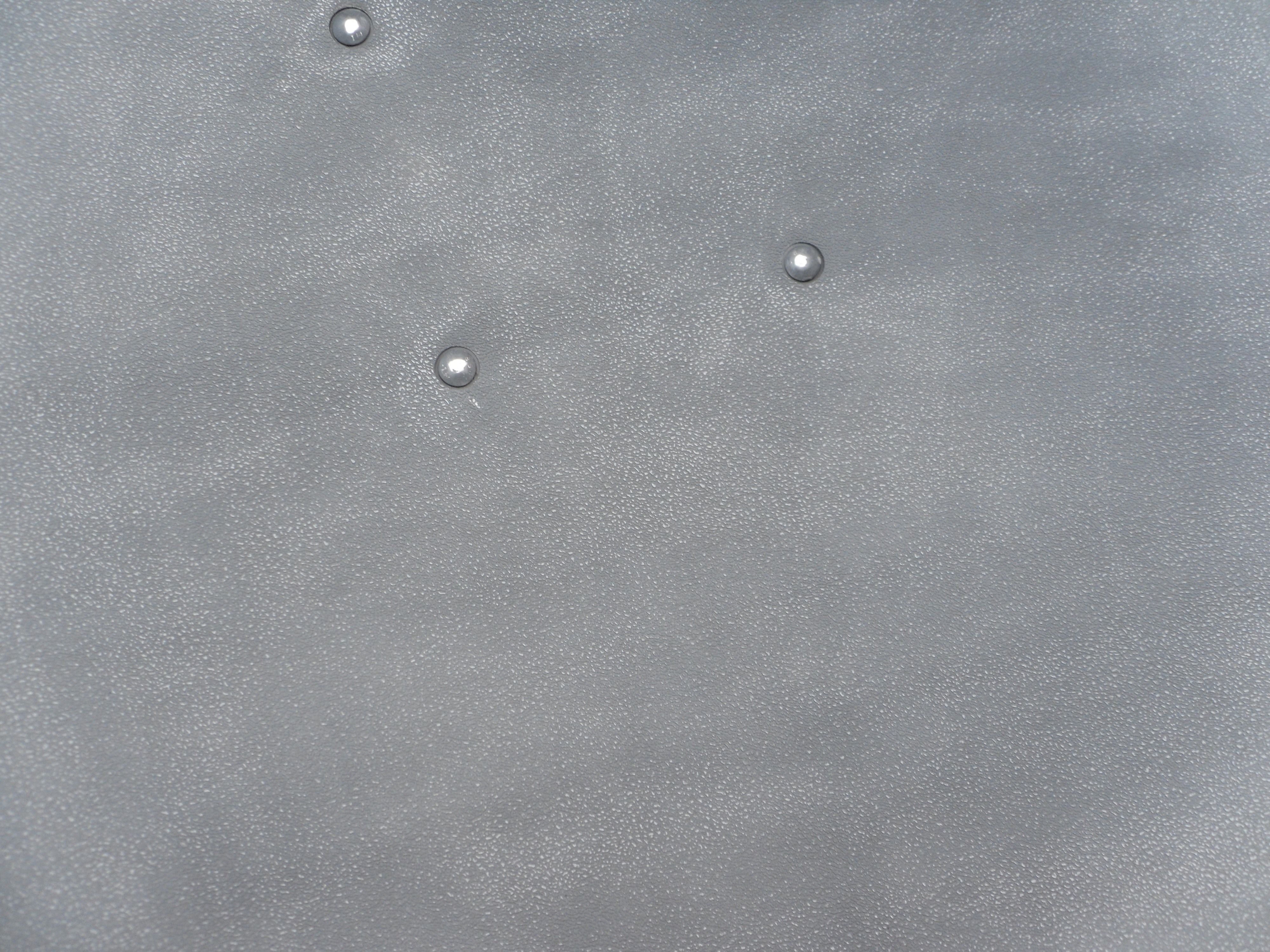

After lunch, I took some 150-grit sandpaper and gave each a light sanding, just to give the paint a little tooth to stick to, wiped them off with a tack rag, and had at it painting. I used the shortest nap 4"roller I had in my paint locker, and rolled 'er on. I did four dishes, and by the time I was done with the fourth dish, the first was dry enough for a second coat. So what you see is two coats of 11.00 paint.
On the 1m dish I took the feed arms off, scuffed them off, primed them with some 98 cent primer, then shot a coat of clear over that. They don't match exactly, but they do look pretty good I think. :D
Now, will the latex paint stick? I have no earthly idea. Stay tuned. :D
Pics below, attention dialup users, they are bigguns. :)

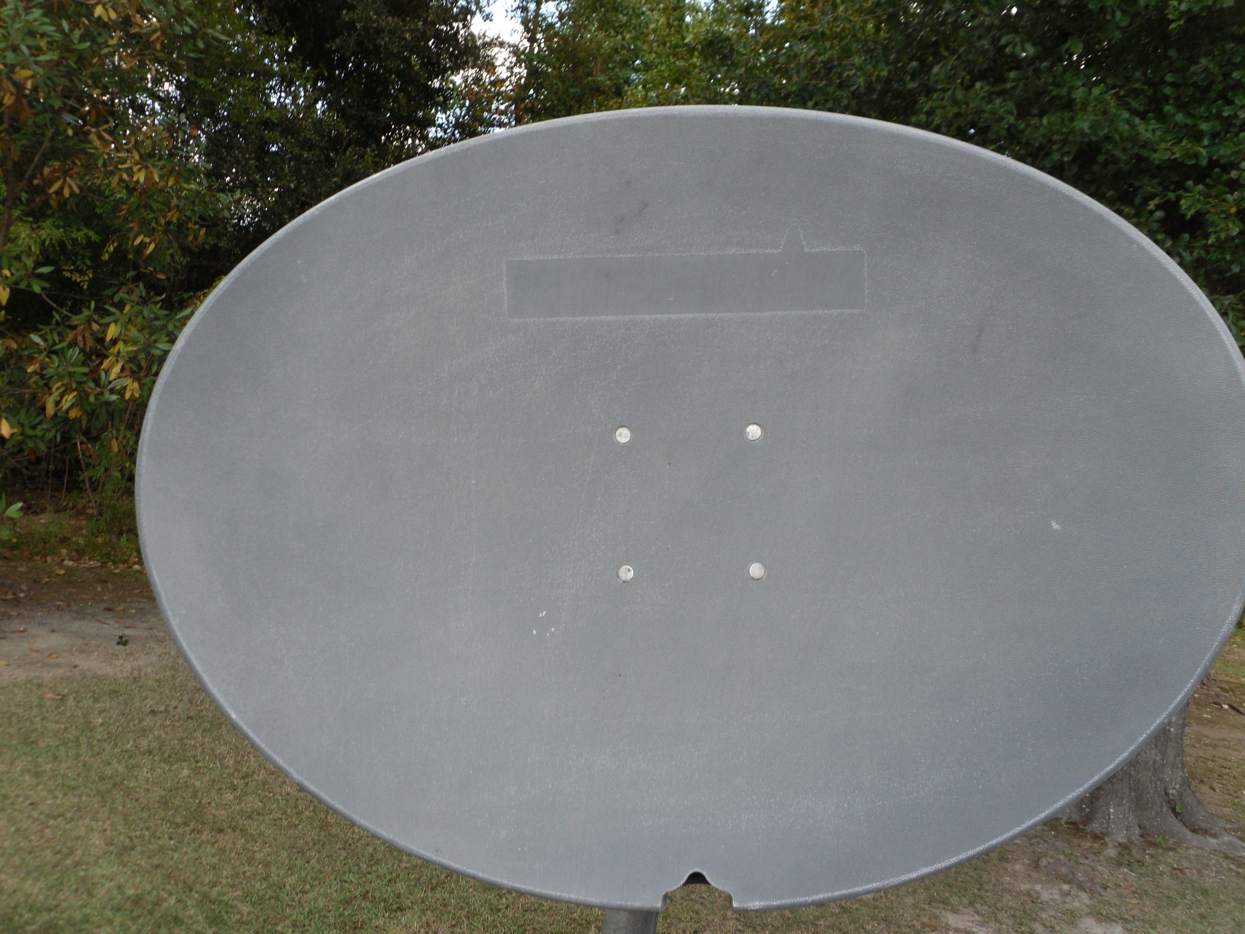

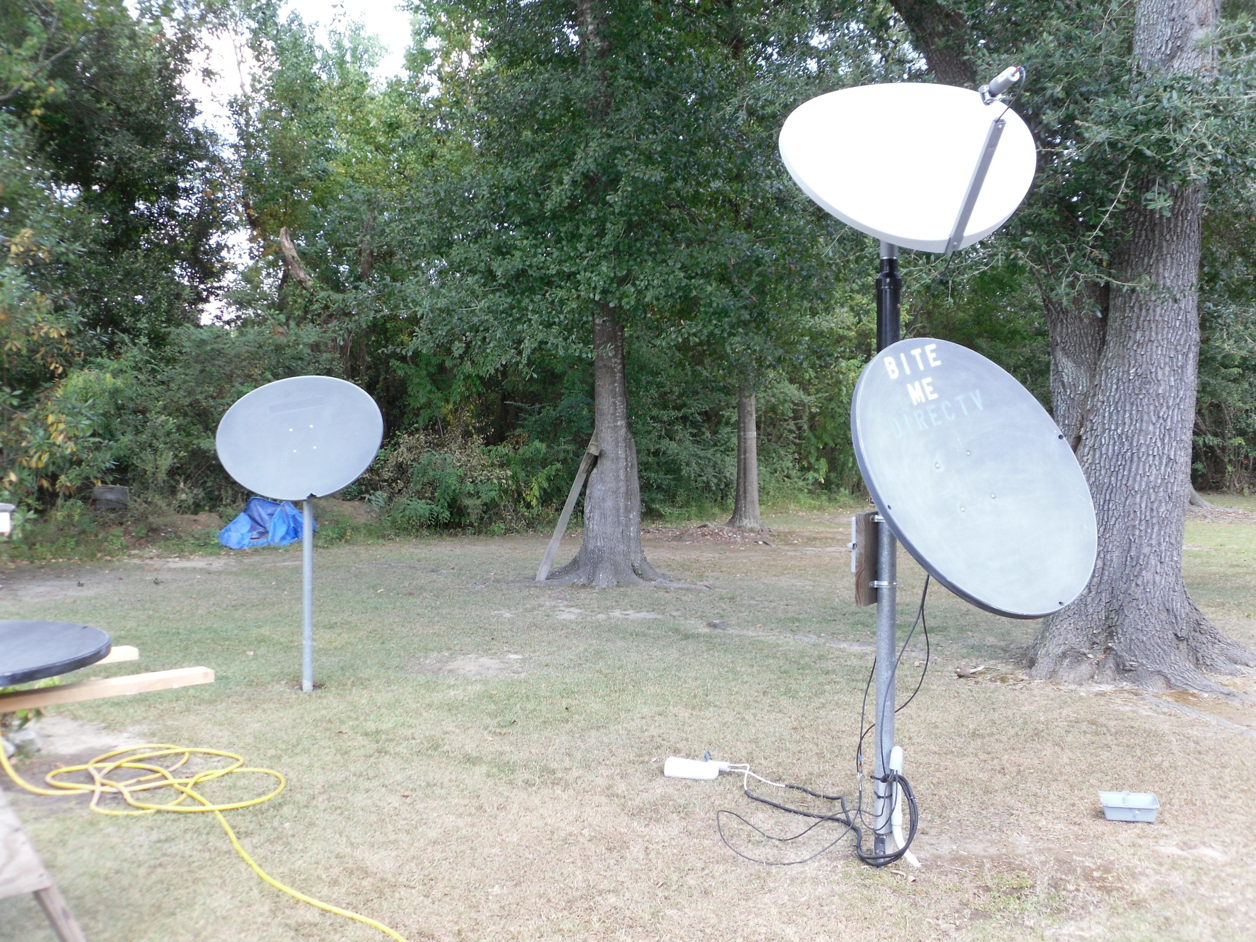

Looks good to me, though the BITE ME stencil work was a nice touch on the previous paintjob. The first picture the lighter colored oval dish next to the tree, I can not see the mount for the lnb to the arm. Probably an illusion but it looks cool in the picture.
Thats a metal bracket I fabbed up. It doesn't work that well at all. :(
I really need some factory arms for those dishes, because I suck at freeform LNB mounting. I have lots of dishes, but no LNB arms for them...LOL
I looked at the other pictures and I can see the metal mount now. The sunlight probably washed out the color on the first picture. That is a better job than I could have done fabricating a mount. That arm looks the same as a GLobecast dish I had once. It had a mount that slide into the rectangular arm. Maybe you could find one of those and give it a try.
