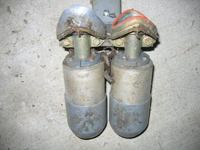

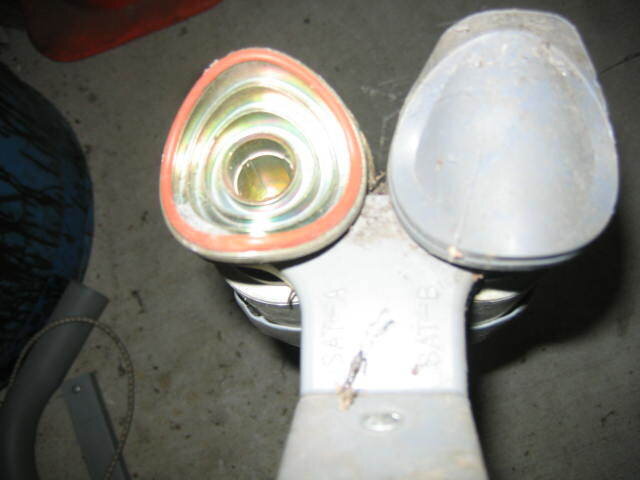

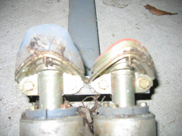

Is this what you want? This is off of a HITS Primestar dish. If this is what you want PM me. The LNB's are 4 degrees apart, BTW.
Oh, and disregard my attack spiders. They keep prying hands off my P* equipment.
