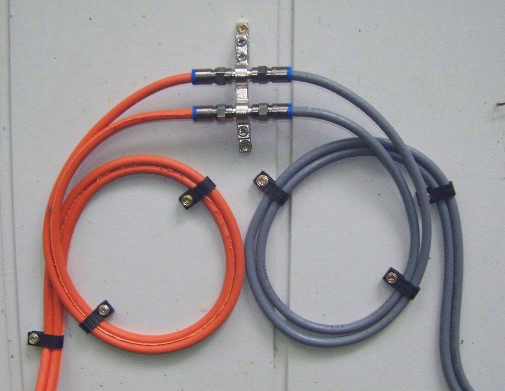

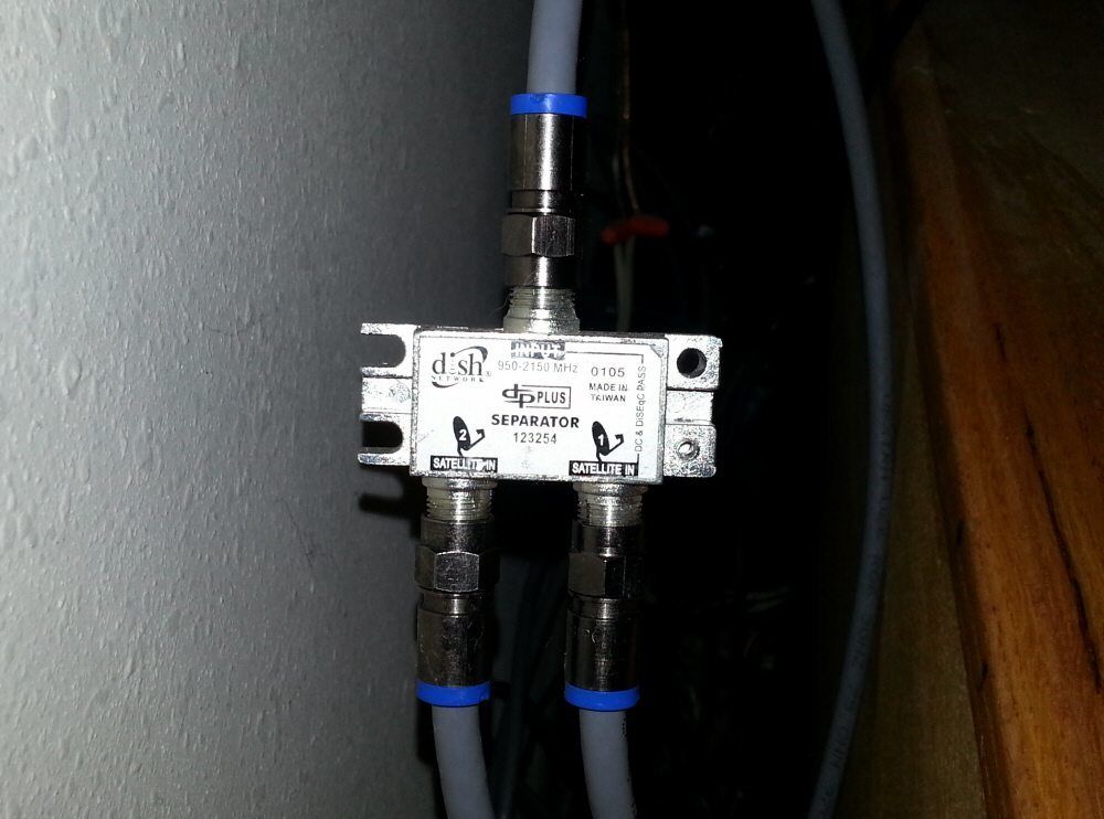

I have a question about my wiring. Remember, I will have ONE Hopper with NO Joeys:
I have a dual coax coming from my 1000.4 that connects to a grounding block on the side of my house. From that, 2 coax's go through the wall behind my TV set. Each one of those coax's goes to a separator allowing there to be a coax going to each tuner of both receivers. So, in essence there are 4 end-points.
Will the Solo Node just replace the ground block and be mounted on the side of the house in place of the the current ground block?
At which point, will the dual coax's coming from the 1000.4 connect to the #1 and #2 DP Plus connections on the Solo Node?
Then, a single coax will come from the "To Host" connection and go through the wall to the back of the Hopper?
Sounds like you have it right. Replace the ground block with the node. Host port goes to the hopper. Done. Should be a very simple install. Make sure they keep the second coax in good shape and do what you can to protect it from the elements, you can use it if you ever go to two Hoppers (but you'll still need a third run from the dish at that point).
