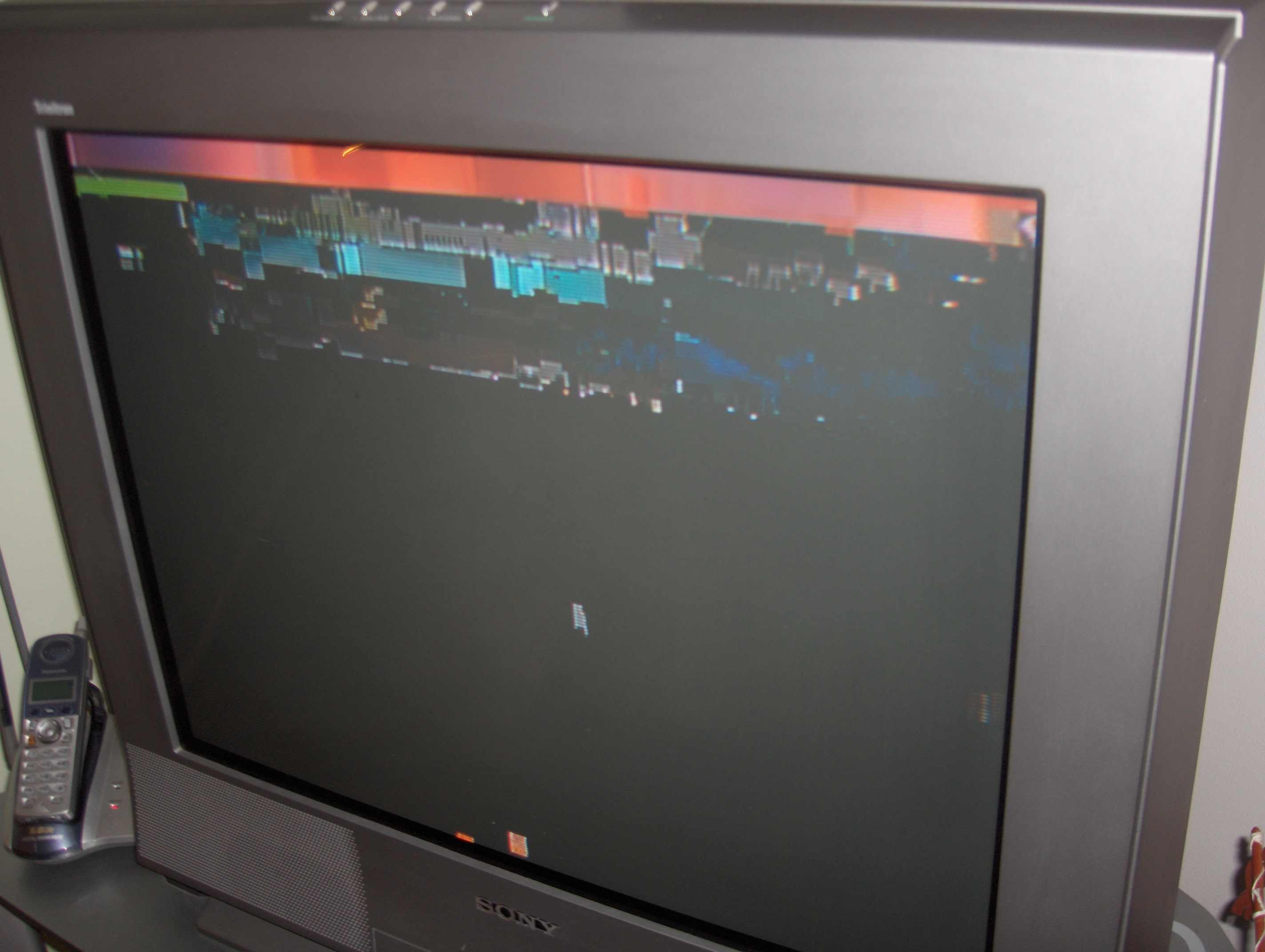

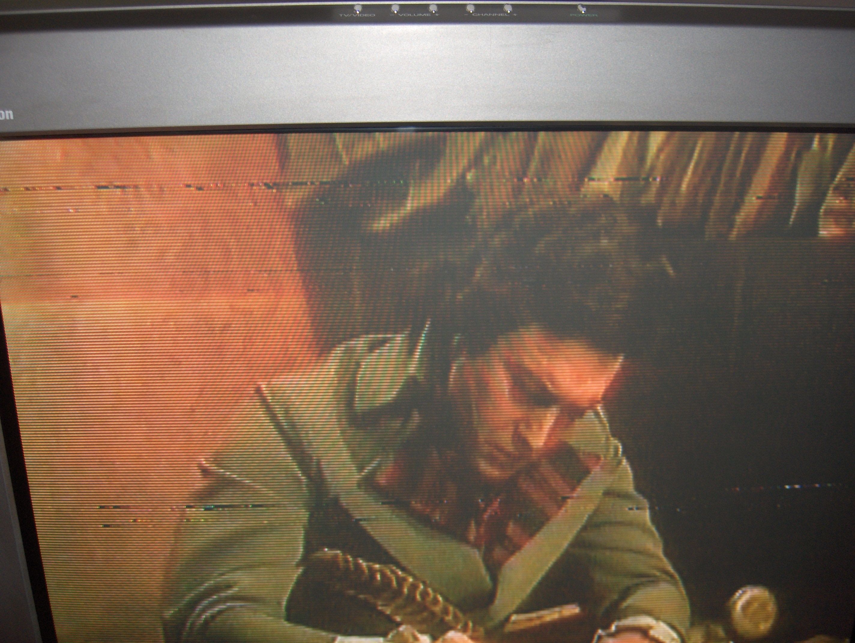

How can I load some pictures here ... I took 2 pictures ... one from the digital and analog reception on my TV ...
when you type a mesage goto the advanced window and manage attachments ( also its a mountain pic onthe mini toolbar if you already have a host) but its easier to goto manage and upload that way
Here are the pictures:
The first one if from the digital NSS806 C Band and the other is satellite 135W
As you can see there are some horrizontal lines on C band analog and the picture on digital is completly funny.
Has anybody seen anything like this before ?
Gregom

This is a tough one to crack!

Tell me which channel on 135w so I can look at it here. I didn't know there was any analog left on those western sats on cband.
Turbo
I get nasa on satellite AMC6 72W before I was able to catch on AMC6 and AMC7 but since i got this line i am unable to catch the other Nasa channel from the west coast satellite.
The channels I was looking on my C band analog is channel 5 on satellite Galaxy 15 133W Horizontal POL.
See if you have those lines... I bet you will be ok ... I get those lines on all C band analog.
Gregom
Yes they all look fine here, shopping channel clear as can be, ARTS and the EWTN channel , fox news is back I see and its good too.
