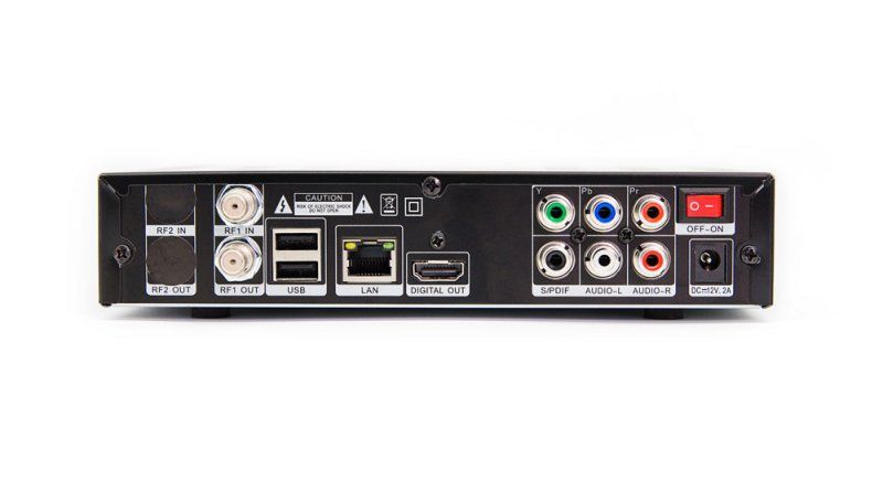

Here's the picture that shows the back of the satellite receiver.
What would you do IF there's NO VIDEO OUT RCA????
Hope all helps with answers.
ECruzBUD

Ok, based on that model, the RF1 and RF2 are:
1x IEC 169-24 female for LNB signal input,
1x IEC 169-24 female for LNB signal loopout
...which would not be the right signals that your TV would understand. You need to go with the HDMI to RCA converter similar to the one I posted above.

The receiver itself must handle and overlay the closed captioning information. It should appear on all the video outputs (including outputs that are being converted to another video format).
That being said, the receiver's options for color, font and size may not lend themselves to comfortable viewing on a composite connected television.

Unless I miss my guess, the receiver doesn't "pass" CC. It renders it and overlays it on the video image.
Converting from digital CC schemes to line 21 probably isn't economically feasible and as I said previously, it shouldn't be necessary as the receiver should render the closed captions all by itself.

Any HDMI to composite converter will work.
