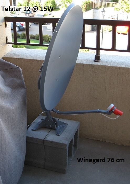

H/W: 76cm Winegard Ku offset dish
+ TechSAT TRACKER II+ LNB(0.2dB)/Smart Titanium Unv LNB (0.1dB)

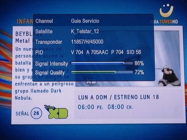

I am receiving most channels listed on LyngSat for Telstar 12 except for problems with 2 transponders (25/26) beaming TuVes HD signals:
11860 H (I managed get 6 channels 'unscrambled' out of 38?)
tp 25 TuVes HD DVB-S2
MPEG-4
Betacrypt 45000-?
8PSK
(Sig-Q ~ 5-75%)

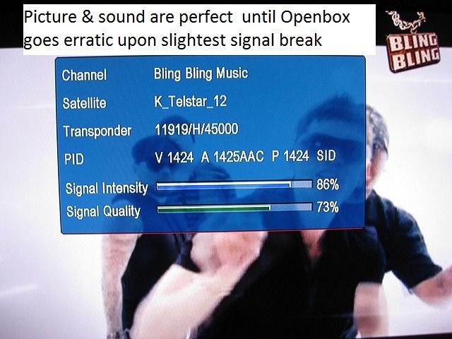

11920 H (99% channels scrambled, except for blingblingmusic.tv)
tp 26 TuVes HD DVB-S2
MPEG-4
Betacrypt 45000-?
8PSK
(Sig-Q ~ 5-25+%)
I'm not sure if I am lacking signal strength/Q in order to maintain a decodable
signal for the very high symbol rates (45K+) or simply it is my receiver that is
unable to keep up? I noticed when I shutdown my receiver and reboot a short time after the channels come in fine for a few minutes and then quickly degrade until I can no longer watch and the signal meter goes erratic (ie. signal loss?).

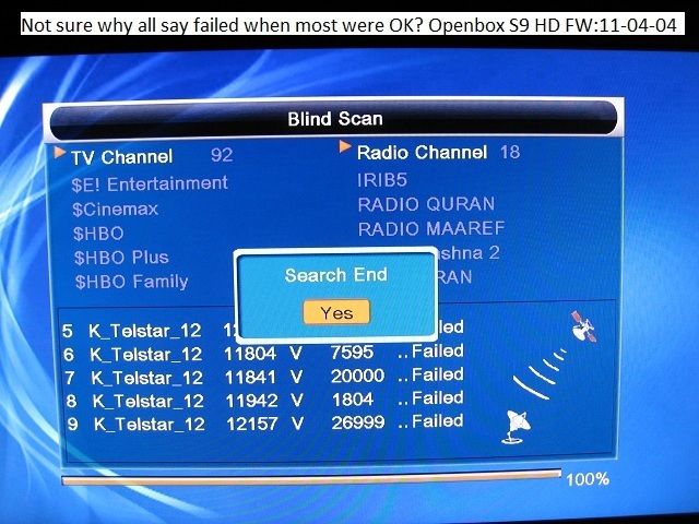

Also noticed that my Openbox S9 HD has some problems with the 'blindscan'
as it was unable to detect these bottom frequencies:
11709/V/3195 0308 0256 MSNBC U.S. (Sig-Q ~ 50-65%)
11711/V/2800 0308 0256 TANDBERG 2 (Sig-Q ~ 40-60%)
I had to manually add them in my TP list.

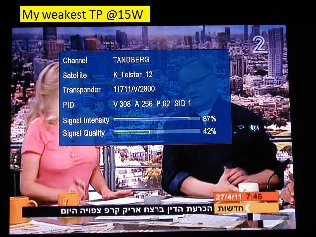

ps.: I am getting an additonal channel NOT listed on LyngSat: Tandberg CH2 from Israel. This seems to be the weakest channel I can reliably receive:

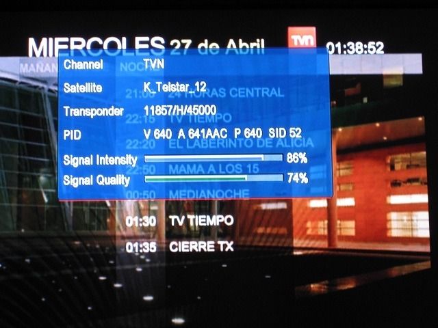

I'm receiving 116 channels from Telstar 12 in Michigan. 11 of them are ITC. Chilevision along with others have scanned in at SR 45000 on my OpenBox receiver. No problem with high SR here.
I've been looking for some NBC backhauls from London supposed to be on this sat. Anyone seen them?
Good to hear Pixl, and what is your signal quality on Chilevision? As for the 'scanning@45000', I have no problems -- just getting a stable decodable signal is the problem as it varies after only a few minutes between 5-75%Q -- yet the 11840V@20000SR-TP is always solid @70%Q.

My Q on Chilevision is 65 to 72%

I just tried your FW Pixl, and no change! The high SR channels start to go erratic after a few minutes and I must reboot the receiver in order to get them back. Today all TPs were @75%Q, yet same problems. It seems that as soon as there is a 'break' in continuity of the signal, the 'error-correction' does not adjust properly and the signal becomes unrecoverable. And just a quick wave of my hand in front of the LNB, or if a plane flys overhead in LOS the channel cannot recover @HI-SR. Thus, I am quite convinced I have some 'buggy' hardware. I doubt any FW update could solve this if I have a bad batch of chips in my box. :(

What are your settings (Frq/Pol/SR) for your London feeds... I'd like to see if I can spot them? Also what is you signal Q on (11711/V/2800 0308 0256 TANDBERG 2) it is my weakest TP?
