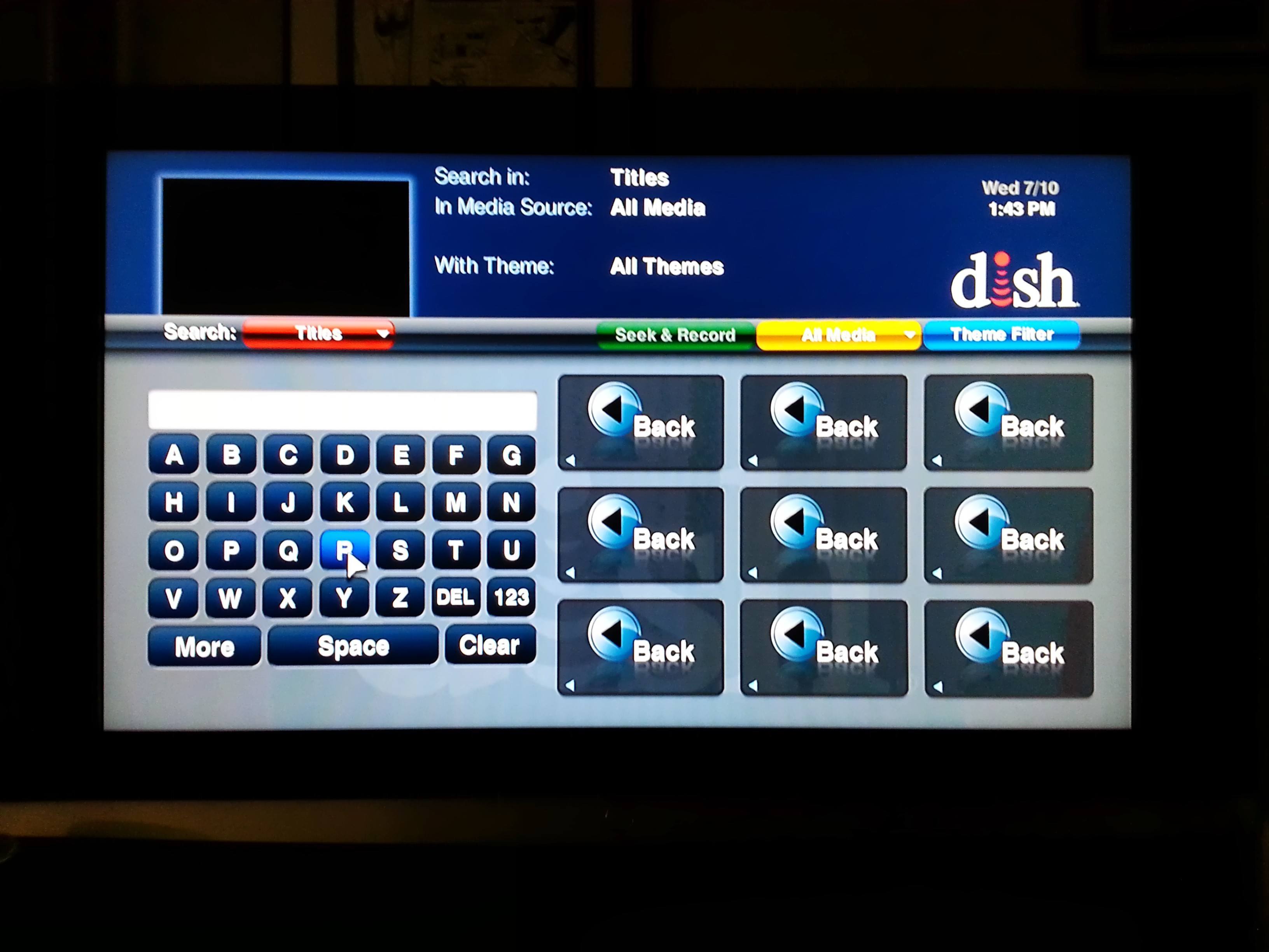

In the past few days, i've noticed some weird behavior on my Hopper (and Joeys). When i hit the search button, no matter what i search for, nothing comes up. Additionally, when i first hit search, every available space for search results to show up pops up with a Back icon in the box.

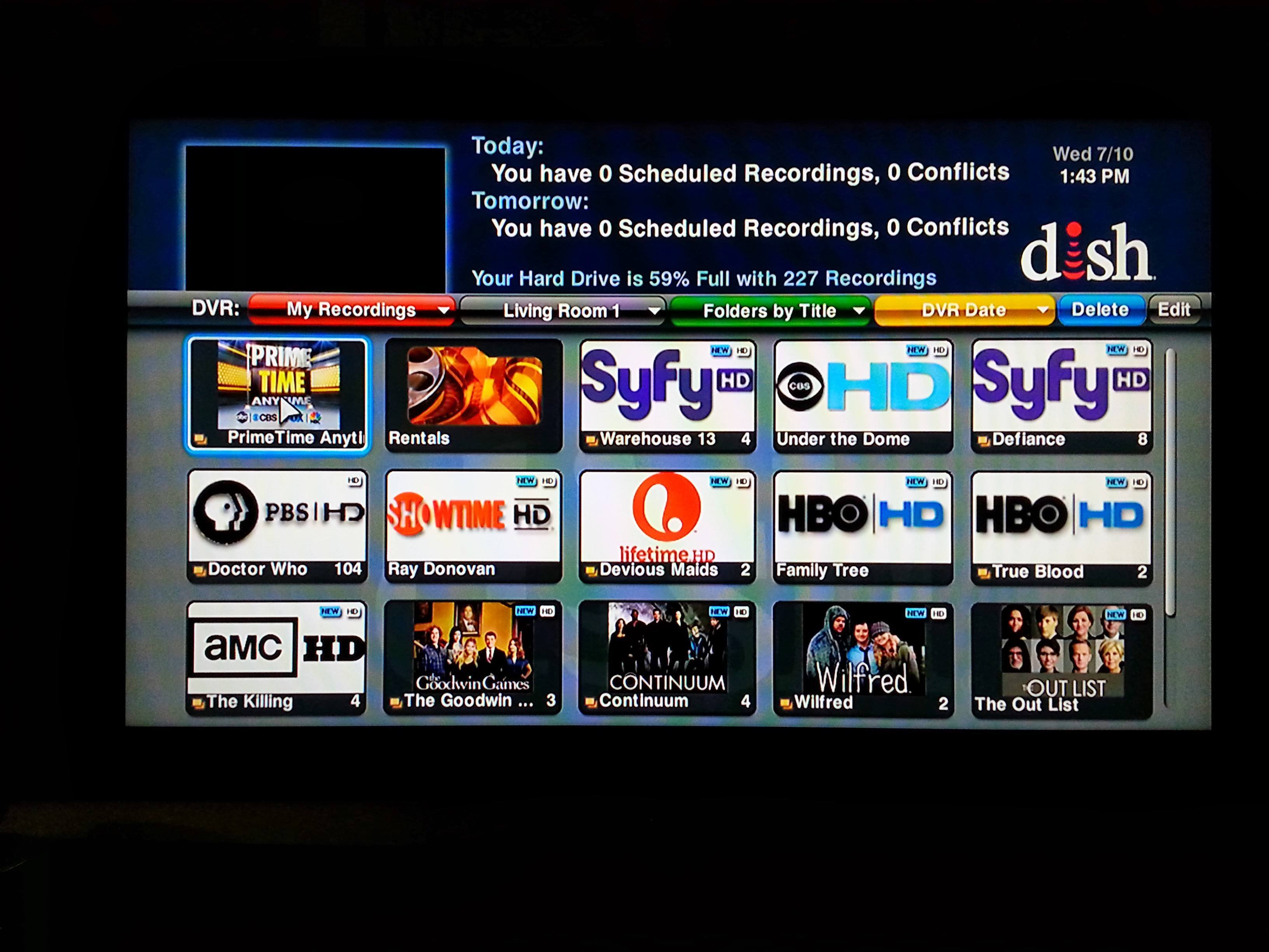

Also, programs i recorded in the past several days have just the network icons, not the icons for the individual programs (i.e., instead of seeing Julie Chen's smiling face for Big Brother, i get the CBS eye instead).

Rebooting did nothing for me. Here's pics of what's going on.... when i hit search:
And this is what my list of recorded programs looks like:

When i type anything into the search field, where it says "Back", every box has the word(s) that i'm searching with no actual real results. I have had some intermittent signal issues of late. For example, this morning, i lost some of my local channels for several minutes (including the same channels through OTA, which i thought was odd), and earlier in the week, my Hopper got stuck searching for a signal. I'm not sure how to know which arc i'm on. FWIW, i'm in the Chicago suburbs, and my dish is pointed southwest.
Make sure the Search class is Titles or Descriptions as appropriate and
that All Media or Program Guide or My Recordings is selected. (It is set by where you came from.)
Else you may be looking in the wrong lists.
