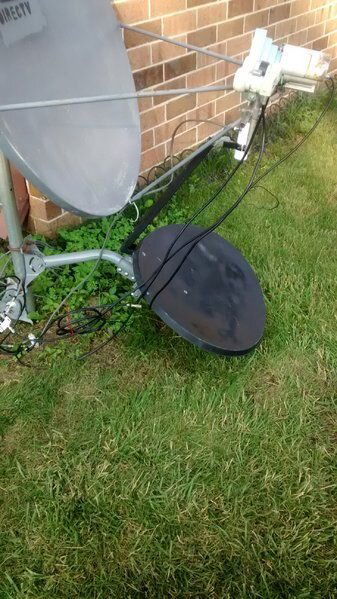

Today I inverted my first dish on 97w its 40 degree elevation. I took the elevation down to 0 then bumped the j pole forward to 60 degrees elevation I got the signal right off the bat all of 97w is coming in. Very happy.
Here is a pic for you guys.

Dan, what happens when they mow the grass?
Reactions: PopcornNMore
I take the reflector off during the week put it on during the weekend so it gives me time to reflect on the past weekend. He He ha ha.
Reactions: Cosmo Blatz
Side benefits: 1) Gets the rainwater running off the 1 meter a little further away from the building. 2) Very low wind resistance. 3) [I got nothing more]
Disadvantage: being flat black, I can imagine the neighborhood cats 'resting' on it on a cool, but sunny, day.
[that's all I got]
Would it affect the cband on The 1 meter?
It could. A couple of months ago I mounted my 1 meter level with and beside my 6ft dish. I had it pointed at 85W. As soon as I went back into the house I noticed I had lost 83W on the 6 footer. I went outside and spun the 1 meter to 99W and 83W was back.
I think you just help me figure out what I want to do next. I'm curious if the signal strength for the inverted dish is consistent with the dish being upright?
Its about the math and the dish is small its just a toy not something I would tell people to do. 36'' dish is the best way to go. Its about the same results as a right side up dish.
Inverting the dish should make no difference on the quality. I used to use a Star Choice 60E inverted and sometimes right side up and I couldn't tell the difference.
