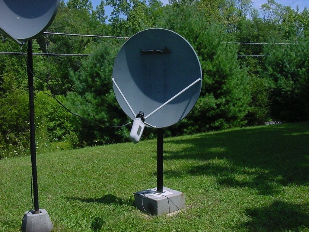

It took about a month and this weekend I finished the Primestar dish project. Currently pointed at G10R using only the vertical side. I pointed it by eye comparing it to the 76cm next to it and hit it first try! First time I ever did that with a dish. I love that elevation adjustment bolt for fine tweaking.
That's an 8' pipe with 5' above ground with a 16"x16" block buffer above ground all with concrete. The ground took 2 days in the evening to dig with a post hole digger in 90 degree heat. I built it strong in case I want to mount my 180cm Fortec there in the future with a polar mount setup.

Nice work, the block is something I wouldn't have thought about. But then, I
worked construction for a couple of years and promised myself I'd try not
to ever touch another concrete block for the rest of my life!
Thats' a beaut from the front.
Can we see it from the back, too?
Fixed or motorized? I assume the former.
How big a pipe ya got?
I know the fence posts I use for experimenting isn't going to cut it, and I need to start thinking about real big stuff. :)
Now ya got me thinking about blocks in addition to cement for holding the thing down.
Great food for thought.
Thanks for the pix.

The pipe is 3" and heavy duty. It is 1/4" thick. A guy from work had it leftover from moving a hot tub and didn't need it. It looks as though it was used for plumbing in a previous life. The largest pipe sold around here is 2 and 3/8", 16 gauge for fencing.
I only watch the Equity feeds on G10 so vertical polarity is fine.
