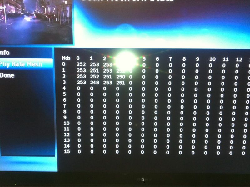

That 4 digit code is only given of everything pans out good. It's called "installation verification" for a reason. If the dish is slightly off or it's not keeping a solid signal which would be caused by everything you just described it will pop red X's and won't give that code. The only thing is doesn't test is the db level which needs to be between -25 and -55. And thing lower that -25 is considered too "hot" and can burn up the receiver and anything over -55 can cause a receiver to be more prone to rain fade. If you have a SWM system you can press the guide and right arrow button on the receiver at the same time to pull up mesh rates. Only available on Receivers with built in decas. You want to see 220 or higher on all numbers, if you have a lower number then you have a cabling/connector problem.

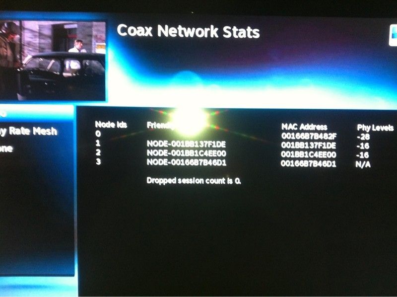

I tried the guide and the right arrow and it does not do anything on my genie.

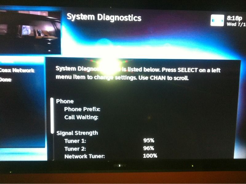

Sorry for the quality, using my cell phone. These are the screens from hitting the guide and right arrow at the same time

PHY levels read -19,-15, and -25 As for your second screen shot my numbers are pretty much similar to yours.
Then it seems everything is more than likely fine. I've actually lost signal more this year then in the pasts. Many people I've talked to have seen the same as well, I can only think either something is going on 23,000 miles away or something in the weather is getting worse. For peace of mind you can always keep calling until you get a tech out, with me not being there to look at your system I can't say everything is perfect but it seems like it is. ;)
