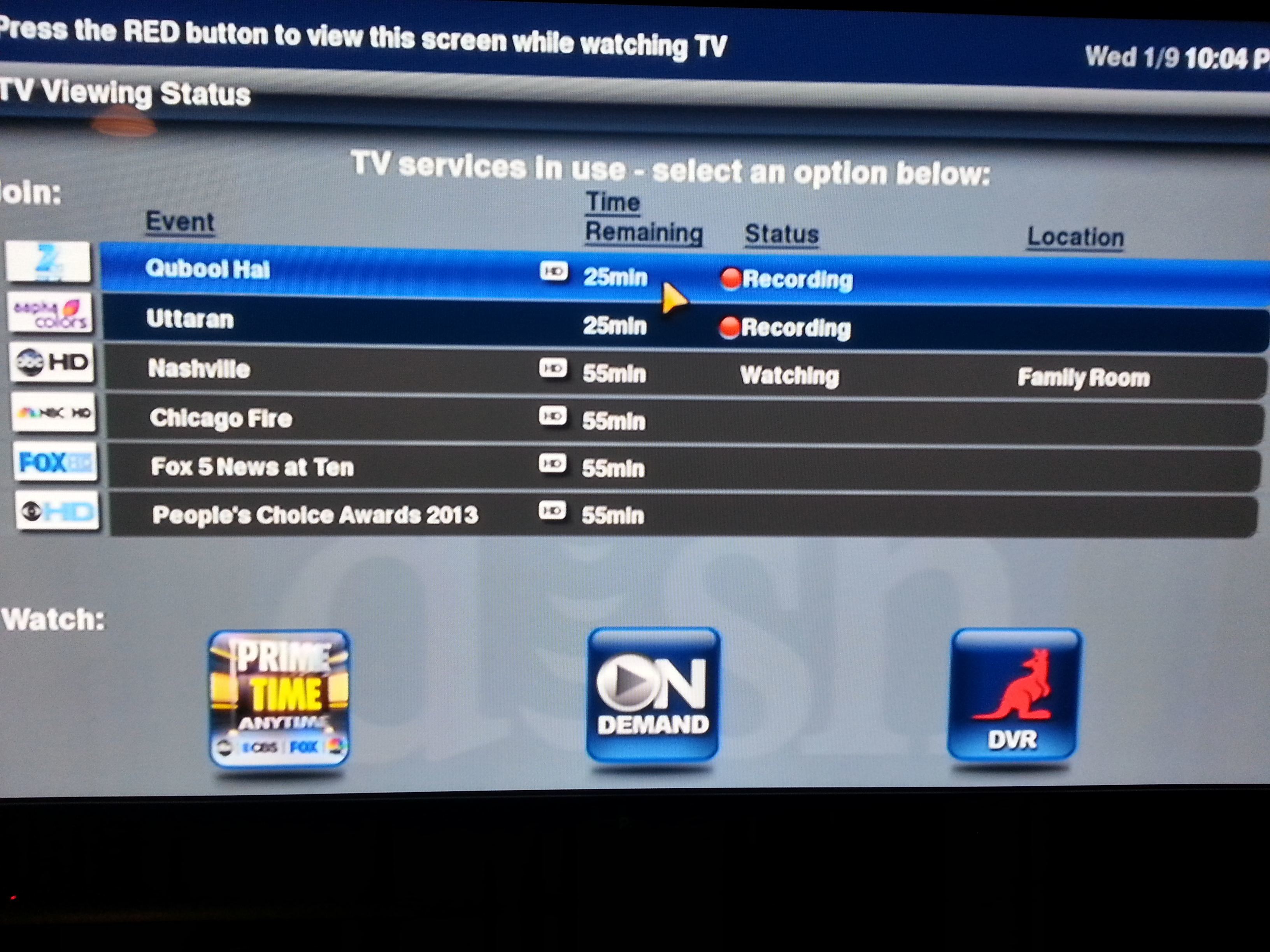

My issue is that it seems that PTAT is taking up a tuner and recording shows even though I have it turned off. ABC, CBS, FOX, and NBC networks are being recorded and I have no idea how to stop it. In addition, the "PTAT" yellow logo doesn't show up in my guide.

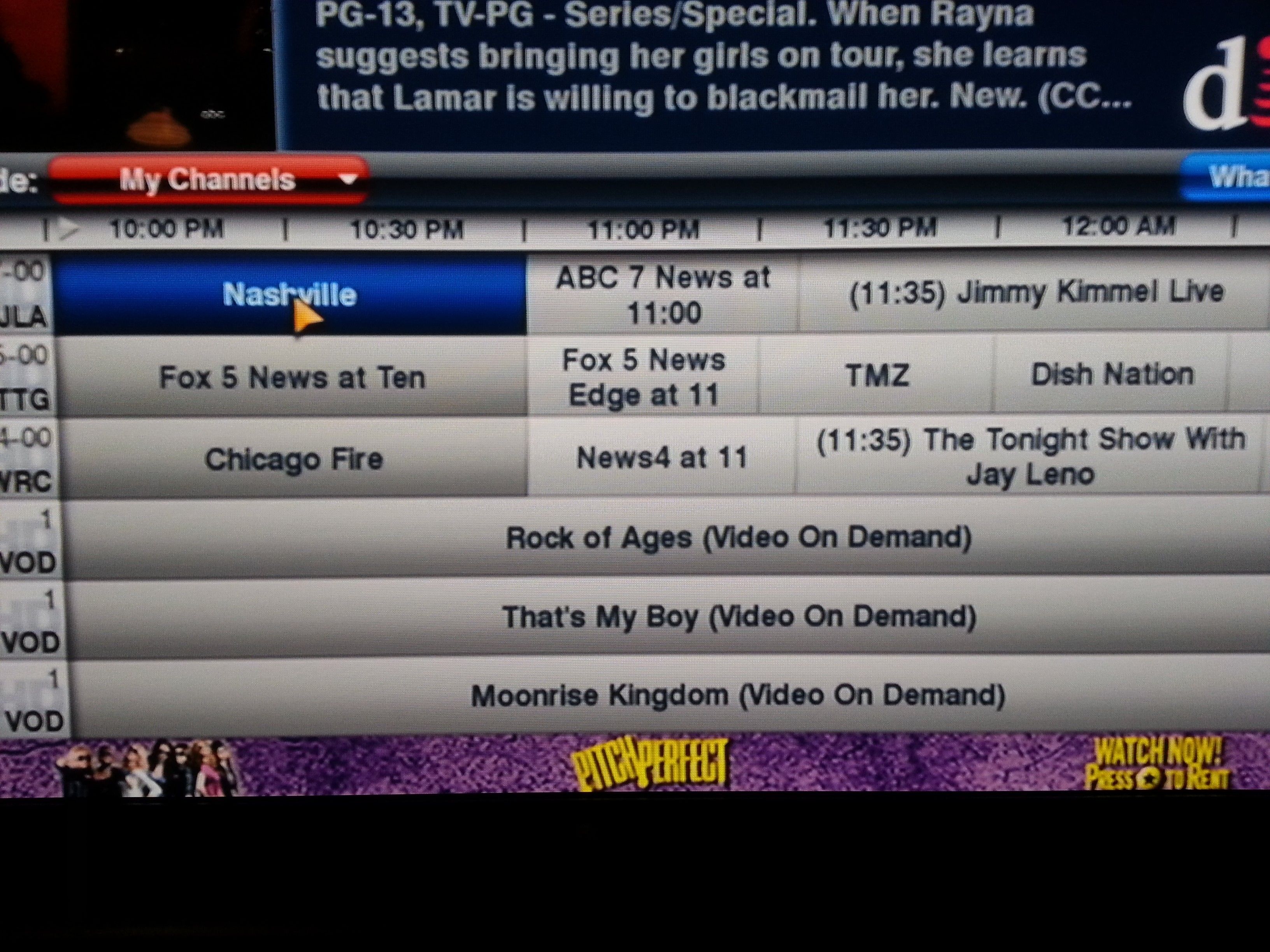

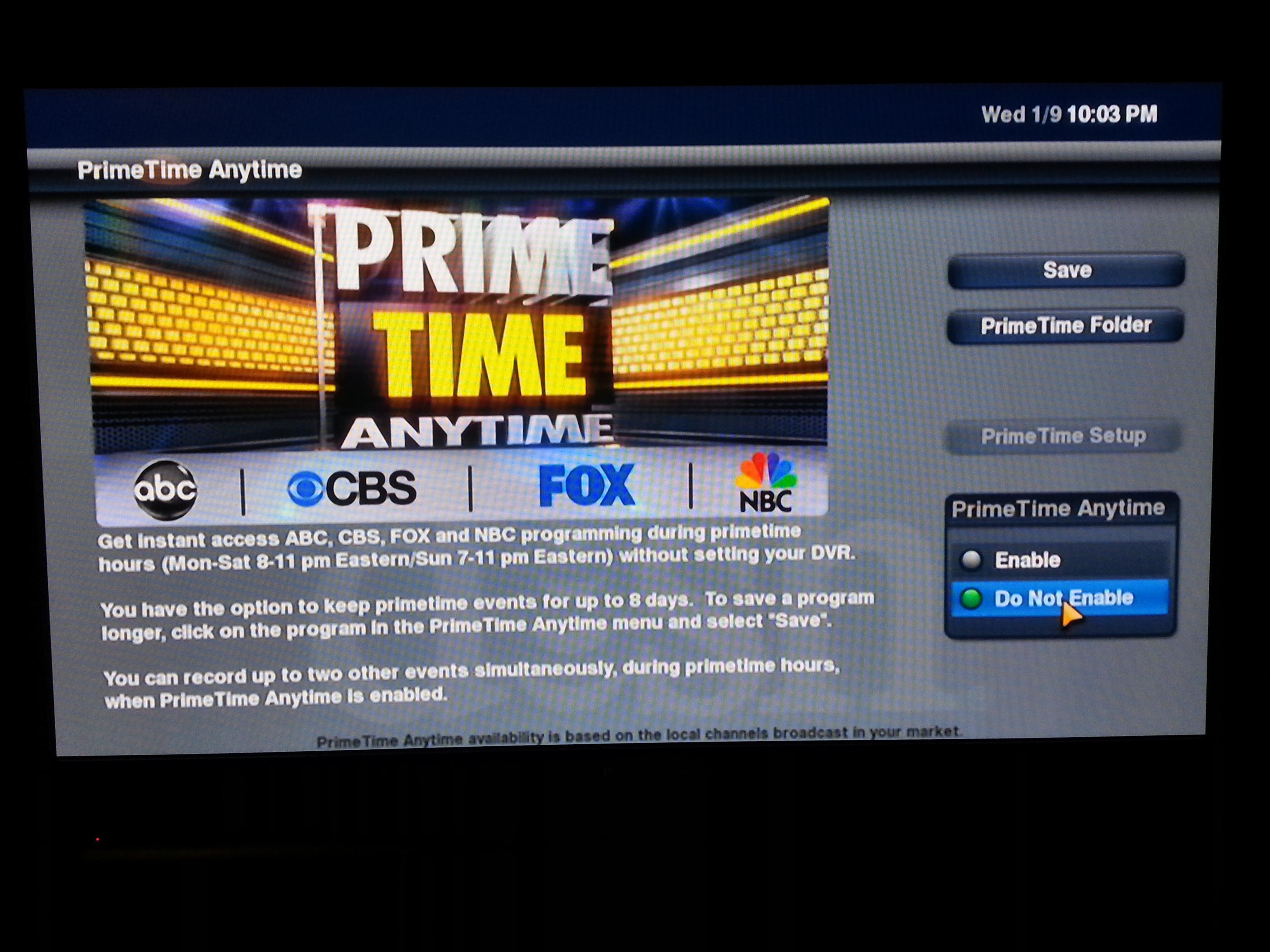

I have attached pics to show that:
1.) PTAT is disabled
2.) The guide doesn't show the yellow "PTAT" logos
3.) My tuners and what they are recording
Thanks in advance for any info on the issue!
***EDIT: The PTAT shows aren't being recorded, I just can't change the channel on the 3rd tuner like I usually can.

Here is what I think is going on based off of what you descirbed, but I could be wrong. It sounds like all your tuners are in use at the time which is causing this problem. If you turn to a big 4 network then you will see all 4 big 4 networks displayed on tuner 3. Lets say you are watching Fox and someone else in the home is watching NBC. Well you are both sharing tuner 3 because of PTAT 24/7. If your other 2 tuners are in use, recording or someone else viewing something different, then that is why the TV Viewing Status screen pops up. Even though you are trying to change the channel off of FOX, the person viewing NBC is still watching and using that 3rd tuner. Or if the Joey is powered on and left on a big 4 it is still holding that tuner in use. I would bet that if you went and checked and turned the Joey OFF that is tuned to a big 4 network, then you will be able to change the channel on tuner 3 normally.
