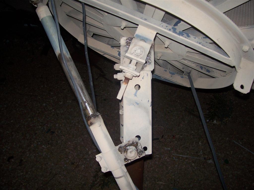

Anyone else notice from his pictures (aside from the fact that they take forever to load) that it doesn't look like the declination angle is adjustable? Although being as how the dish came from his location it's probably already set and not likely an issue.
Should be as simple as moving the actuator until the dish is at it's very highest point then rotating the entire dish, mount and all until you find your true south satellite, adjusting elevation as necessary.
Make sure the dish is secure when you run it east to west with the actuator and not able to "flop around" on the mount or you will never get it set correctly. Also look into the polarotor and make sure it is working properly.
where the ring mount goes onto the post mount, there are 3 diffrent bolt holes for declination, i put it at the same one,

I hope your not rotating your entire mount to 101°. Because if you are it'll never work. Your mount needs to be at true south plus or minus what the deviation map says for your location. Did you even look at it?
Okay,
The part that slides over the pole and the actuator clamp mounts to it too.
In the pic you can see my dish looking at Galaxy 15. But, the mount is still facing my true south and it never moves only the bowl of the dish moves (pivots on the mount) to each satellite. Do you get it now?

Also, dont be alarmed that my actuator is on the east side of my dish. I'm located west of the mississippi river. So its where it supposed to be.
Hope he figures out where the polar axis is. And that you can't compensate for bad tracking by moving the mount around and around on the pole lol.
ok i see now, so the southrenmost part of my mount points south correct? how do i align it with a compas?
You don't........you make that part of your mount point to your true south satellite when the dish is at it's highest point.........the dish and the mount need to point at your true south satellite. As previously mentioned, you will not get a true reading with a compass due to magnetic deviation of the earth. There's a way to figure it out but for your purposes don't worry about it. Knowing your true south satellite based on your location will be easier.
From that point, the highest in the arc, when you go east or west with the dish, the elevation should drop.
so i need to point my mount at true south and the move the dish untill its in the middle of east and west?
Essentially yes.
When aligned with your true south satellite your mount and your dish should be facing directly (or close to it) south and the dish should be at it's highest point of travel.
