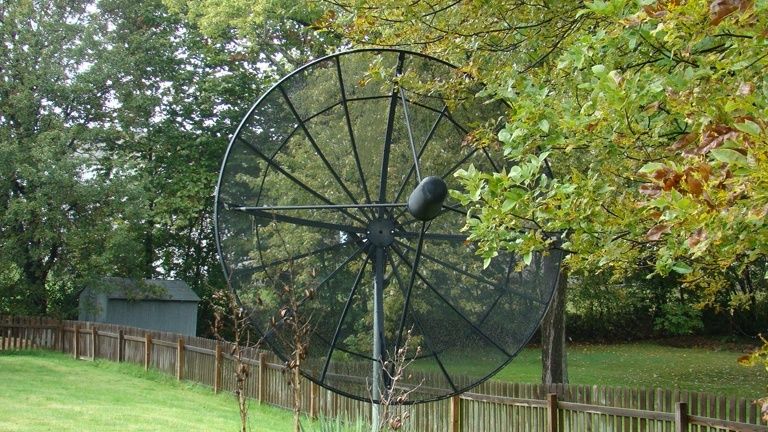

I finally got my dish up on the pole but realized my pole is about an inch to small for the clamp to properly grip the pole.
Do you think it would be alright to weld a sleeve on the top of the pole to get the proper fit for the clamp to hold better?
I was thinking I could use some liquid steel and/or just weld it, to build the diameter out some. What are your thoughts?

I'm just guessing on an inch, it may only be a half inch or so. The pipe was 3"OD I think, it's galvanized steel pipe (but thicker than fence post for chain link fences), it may not be Sched 40. I'll take a picture when it stops raining. It seems fairly sturdy though...
The "clamp" or mount goes 90% around, which is split into two sides with 4 bolts that tighten to clamp it together.
What Dish do you have?:confused:
I think it's a SAMI 10' I may be wrong though... (please don't laugh at the duct tape :o, it was holding in some shims temporarily while I tightened up the screws, until I could figure out how to proceed properly)

Basically, I'm thinking that you might end up with a mount that is easier to adjust if you DON'T weld your sleeve to the pipe, but clamp your mount to the sleeve, which will then allow you to adjust your mount's azimuth (ie pointing south) by rotating the sleeve over the smaller pipe. This would greatly reduce the effect of the mount tilting when you loosen the bolts to rotate it, which is really significant with that clamp mount you have. The three dishes I've used which have pipe over pipe mounts didn't tilt nearly as much as that clamp type mount. But you'll need some way of fixing the sleeve in place over the pipe, which is why you'll need to have them weld nuts to the pipe so that you can put bolts through it to lock it in place. The pipe over pipe mount I got with my new dish has 4 big threaded nuts welded to the side of the pipe. However, since you need to slide the 10" long collar of your clamp mount over this, you'd only have room for maybe 2 bolts at the bottom I guess, which might not be the best, but I guess if the sleeve is longer it should be OK.
I see what your saying now. I was thinking it would be just as easy to weld the sleeve directly to the pipe and use the mount as it was designed. It would still keep it from wobbling in the mount by filling the slack from the pole being a half inch to small.
I was looking at this Speedy Metals - 3-1/2" OD {A} x 3.000" ID {B} x .250" Wall {C} DOM Steel Tube 12" for 32 bucks, I suppose I could find it cheaper but I'm not sure where to look.
I measured the pipe this morning and it came out to 3.023 outer diameter (right at 3").
While were talking about this, when I was out there this morning I pushed on the pole to see if it moves. It does a little when looking at the dish, is that ok (I'm not sure what the tolerance is for signal)? Or does it need to be rigid, like not move at all, even the slightest. It could also be from the way it's mounted at the moment. I suppose I may need to fill the pipe with concrete...

Re the link to the pipe, hard to say, is 3.023 is bigger than the 3.000 that they say the ID of the pipe is. If their ID is a tad bigger, then your pipe might fit in perfectly, but if those specs are accurate, your pipe may not fit. I just looked up the ID of 3" sched 40, which is 3.068, so the 3.023 should fit in sched 40 OK. I just looked again at your link. Look at the link they have there re important info about telescoping. Basically that says that you can never be sure to be able to fit one pipe into another. They say to allow at least .010", and in your case that pipe is .032" too small, let alone allowing more space. I think that if it were me, I'd try to find some sched 40. I'd think that if you went to a welding shop, that they would have access to some short pieces of sched 40 pipe, and he could drill holes and weld bolts onto the bottom to lock the pipe once it's aligned. Re the pipe moving when you push on it, hard to say. All pipes will move a little bit. I think my galvanized pipe moves a bit more than the black sched 40 I used to have, but it doesn't really affect things too much, except right after a move or in wind, it tends to wobble a bit. But it settles down and is OK. But since your pipe is smaller, it might move more than my pipe does. Big thing is that you don't want it to lean forward due to the weight of the dish. If it does that, there is basically no way to align it perfectly. People with BIG dishes, like there was a guy with a 26' dish on another forum a while back, say that they can't use a polar mount because of the pipe bend. They have to use Az/El mounts. But since your pipe is so small, I'm thinking that you may need the concrete inside. I've never put concrete in a pipe, so I'm not sure what problems that might cause. Other people here have used concrete, so they would know better than me.
You got me thinking, so this morning I went out and checked the pole to see if it's still plumb with the dish on it. It does pull the pole off plumb but it's only like less than an 1/8th of an inch. The bubble just touches the line, so it's the amount of distance from the edge of the bubble to the line, which is like an 1/8 of an inch or less. Will that be ok do you think?
I ordered the 12" sched 40 piece of pipe in the size you mentioned for 9 bucks today. I want to thank you for your help.
Hard to say, re the 1/8" bubble. I would think it would be OK, but it probably depends on the level. My digital level showed my pole off by about that much, and it was still reading like 89.8 deg instead of 90.0, which shouldn't matter much. Tilt to the south doesn't matter at all, because that will be taken care of with the elevation adjustment, but tilts to the east or west are more troublesome. Your pole will probably tilt the most however, when it's aiming near the east or west horizon.
