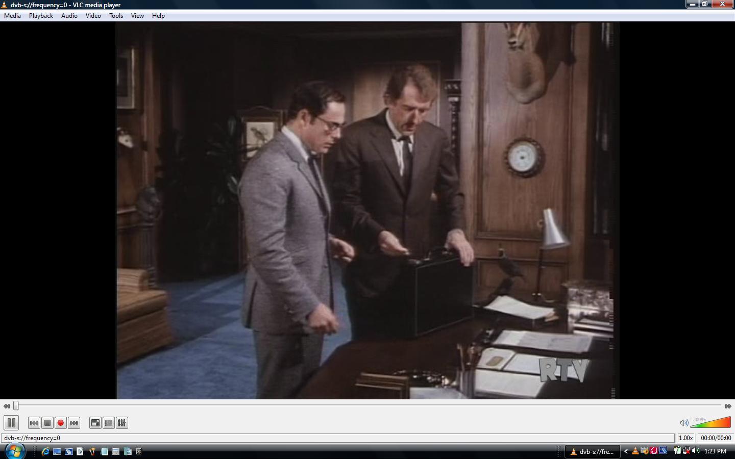

QQ Box Runs in VLC for Windows Vista
Just getting familiar with VLC in case LME issues the Linux QQ Box 7395 Driver.
Using VLC Vista app. until I can load new Linux driver in Mythbuntu.
What I found useful is that VLC allows increasing the audio level to 400%, which is needed on a laptop for easy listening. Also the audio equalizer is very nice.

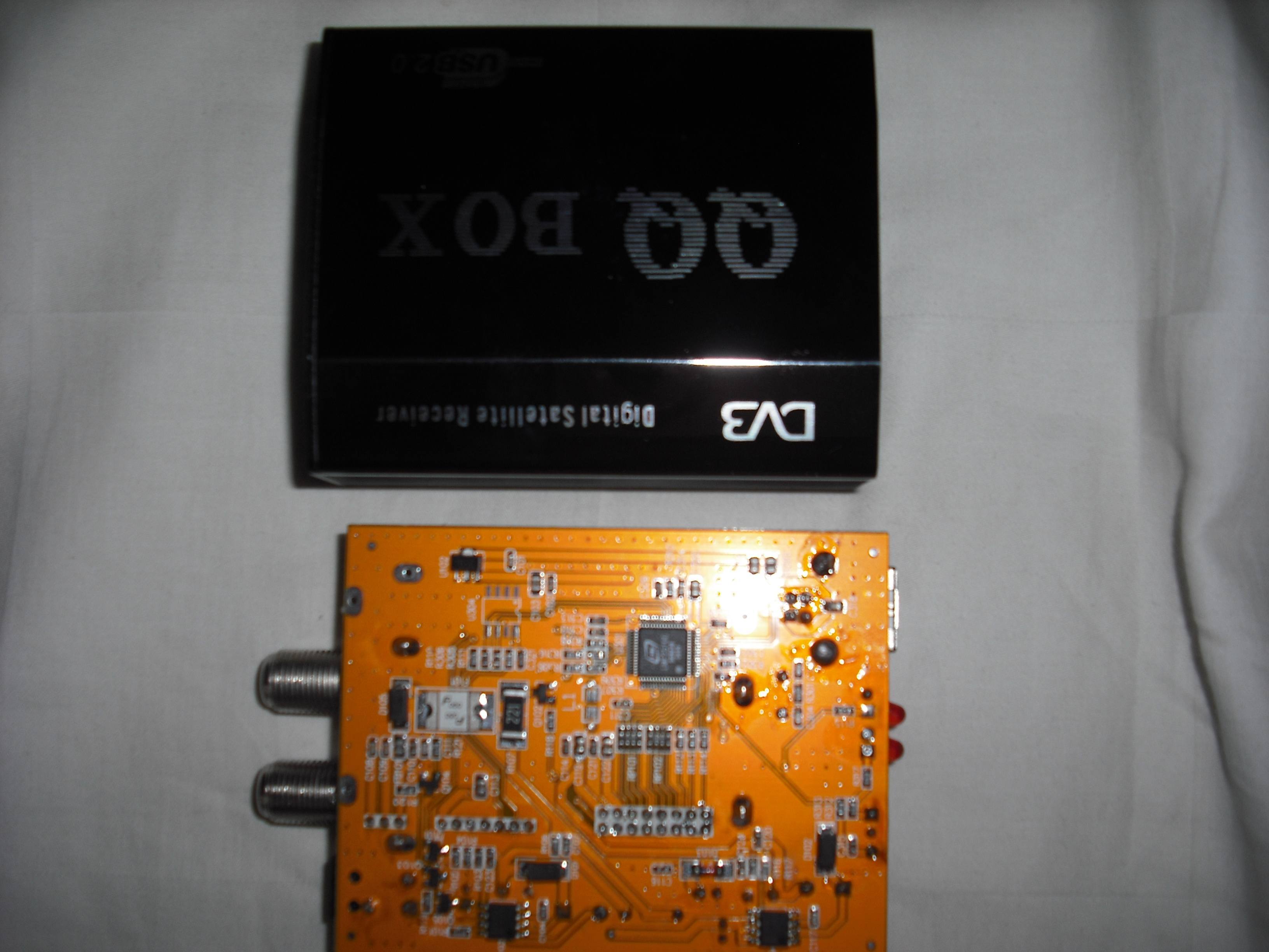

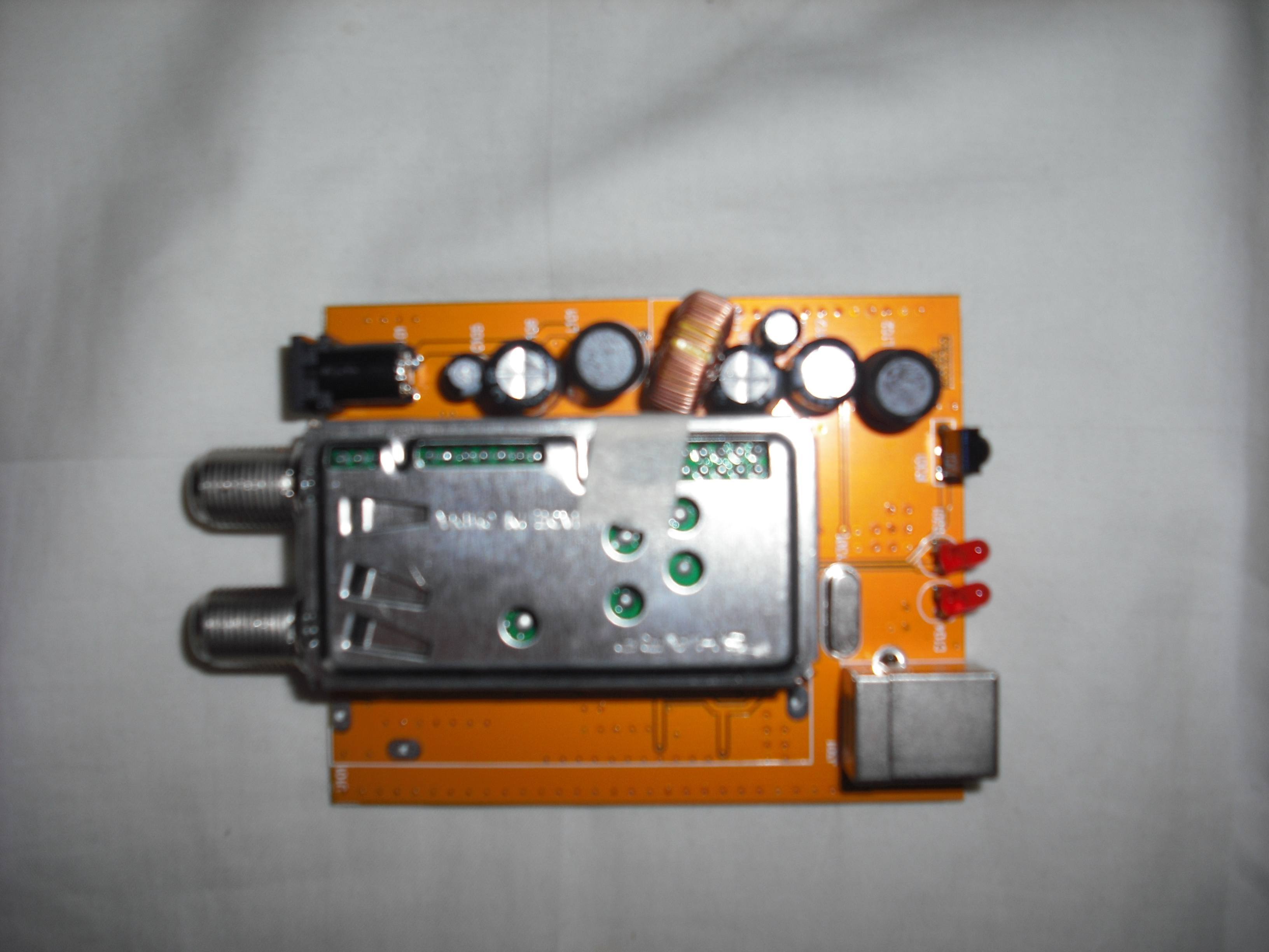

I received the QQboxes today, I ordered 3 of the cheapest from ebay.
They work well in DVBdream and win7 64bit! However, they diseqc switching does not work. I probably just need to find a plugin for DVBdream :D I will sort it out later, I received the dual mode microwave sensor for my car alarm so I gotta go install it :D

Thanks for the pics. I notice that they did not grind down the USB PCB board. That is a change from earlier V05. You don't need to use tape on the board.
DVBDream comes with everything you need to operate a 4 port DISEqC switch. I never had an issue with that. You seem very knowledgable but I'll ask anyhow. You know not to plug the power on while connecting your switch?
I'm curious, are you going to run all three on one pc?

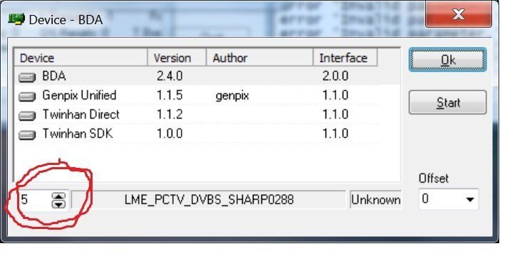

Ahh I found the problem in win7 32. It was in the Device selection screen (where you pick your driver/device). Notice it is the 5th device, circled. Odd, but it changed to become the last device. So now I have a twinhan, a qqbox, and a genpix in that puter. I have another qqbox on another computer, and I will try one on my netbook.
I am curious if I can use 3 qqbox on one computer tho, that is my goal in the end. I was not able to use more than 1 twinhan due to driver limitations.
Right now everything is working except diseqc switching in win7 64bit, unsure about diseqc in 32 bit but it is doubtful. I hope my qqboxes wont lock up like your earlier versions, Adam. That really is not acceptable behavior and would take a toll on my recordings.
Options/Device.
