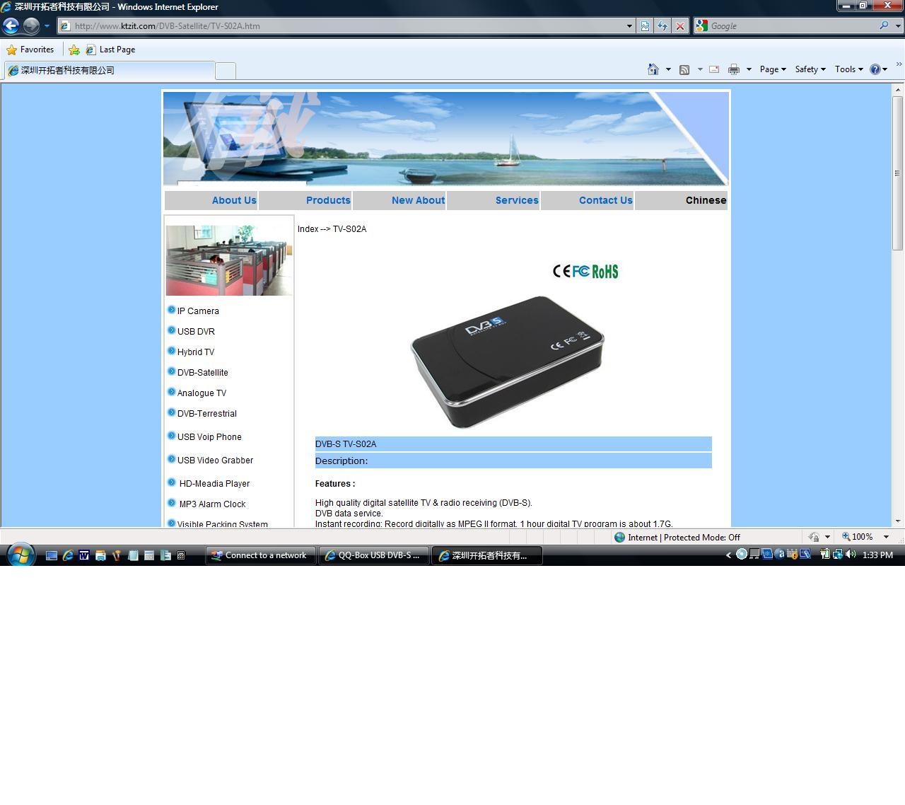

http://www.ktzit.com/ is the manufacturer i think.
I send them a a mail before the holiday. I hope they answer some questions when they are back. The 22 februari they get work again.
I have contact with a guy Ariel, he is verry helpfull. He come's also back on the 22th februari

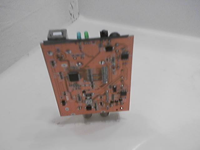

Sharp F7HZ7395 Tuner
This tuner uses a STx0288 Chip hence the LME 0288 driver.
QQ Box Version 05 Fix
Fix the 05 by adding a strip of electrical tape to the USB end of the board.
Like you can see is this one with a LME2510c chipset and a sharp tuner
I go try of the QQ-box works when the metal enclosure is removed and adding a strip of electrical tape to the USB end of the board.
Good Pics.
I checked all the solder connections and all look good. There is alot of Fiberglas dust on the board that you can clean off with an air hose or artists soft bristle brush.
If you can remove the box end plate at the USB side, you can apply the tape to it.
