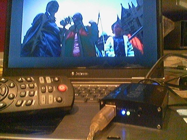

QQ Box Customized
While I'm waiting to test the new Linux driver (In UBUNTU),I did customize the LED's.

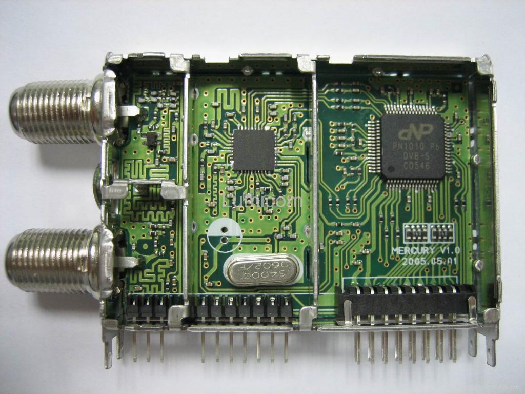

Sharp BS2F7HZ7395 DVB-S Tuner
Attached is the Sharp Data Bulletin (not really a datasheet) for the tuner used in the QQ Box.
Sad to say that the first QQ Box was received DOA with bad Sharp tuner. Now the second QQ Box has died. Same problem, the Sharp tuner is crap.
I found that Avnet is the only supplier I could find that lists but does not stock this tuner. 2000 / min. order.

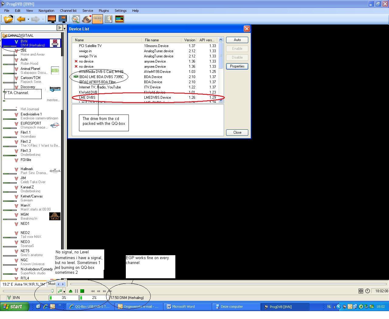

Hi,
Here you can also see the differents between the driver. In the first pic i show the driver who i get in the packed. This driver works verry bad, only with Blaze i have some freezing screens. With PogDVB i have sometimes some signal about 76%, but no level. It's always stay's black. Only the EPG i can read.
The seccond picture, here i used the driver i found here. Thisone is working, but not all channels. Maby a bad tuner ?? My experiece with sharp is not bad, Do you know how i can test the tuner ?.

In ProgDVB settings, device, please select LME DVBS device that shows ver. 1.26 and 1.29.
This works in ProgDVB ver 6.30.01 for me.

you can see it here, when i change the driver in DVBprog I have the first few seccond sometimes longer signal and level like in picture 1. Screen stays black on different channels. Picture 2 shows signal, no level. And you can see the driver is 2 times on the list.
Picture 3 this driver not works at all

What version of ProgDVB are you using?
ProgDVB is often flaky about reporting SQ and SL.
The black screen is either a codec issue or your tuner is broken.
I had the same symptoms in BlazeDTV before the tuner stopped working.
Does BlazeDTV do this same thing?

I'm use the ProgDVB 6.32.0.
Like you cn see on both pictures there is some video signal and audio. On both channels. The FTA channel stay's black. Sometime's i hear a little sound.
Only with the DVBS_SHARP7395_20090317_x86_x64 driver
