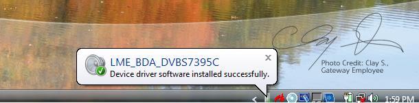

First pic. is notification in windows that driver is installed. The receiver is connected to the PC but not powered up.

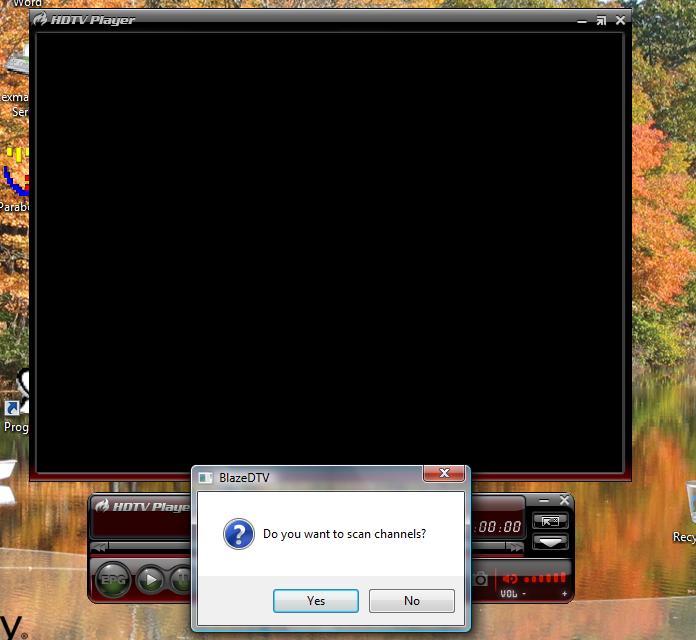

Second Pic. Boot BlazeVideo with power applied to receiver. USB powers LME2510C, Power cube powers motor and lnbf.

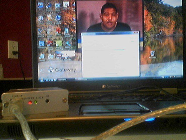

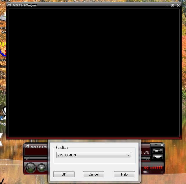

Third Pic. Select Satellite to scan.

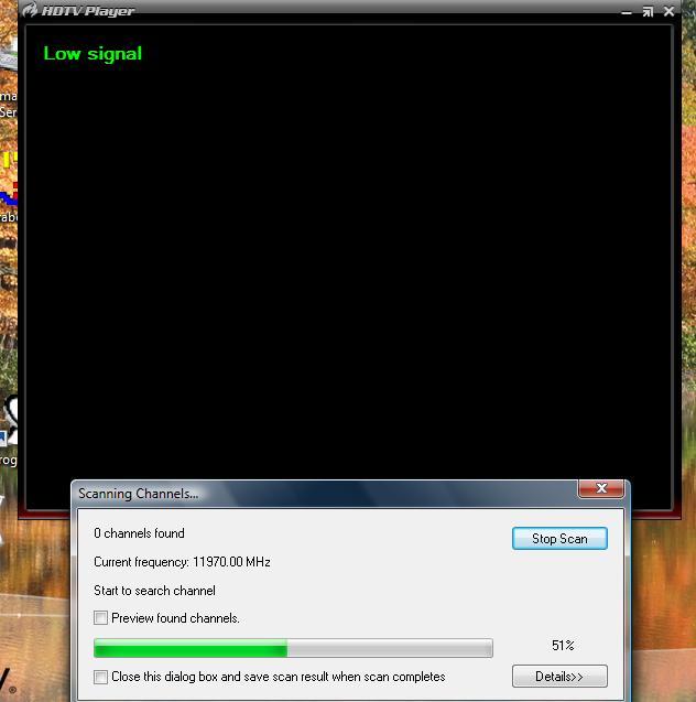

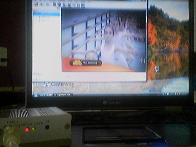

Fourth Pic. Receiver is scanning.

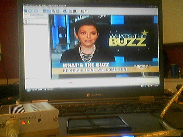

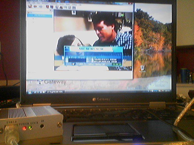

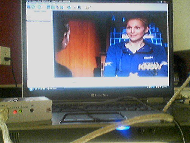

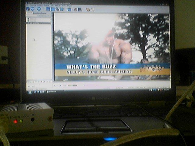

QQ Box in operation
Here are pics. of QQ Box operating with BlazeVideo, ProgDVB and DVBDream.
Warning- There is a flood of these things on eBay all called QQ Box. I found a T-3, T-4, B392, 5392, all look identical but the T-4 works in Windows XP, The T-3 Works in Vista. All claim to do DISEqC 1.2 but they don't.

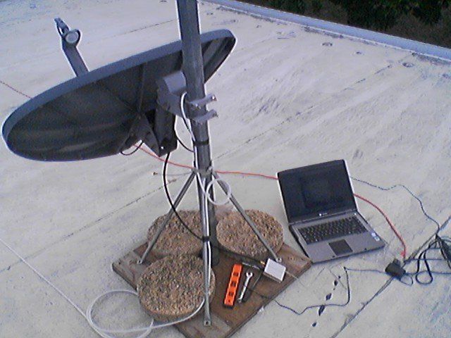

Great Satellite Meter
I see you pretty much fall in love with this QQ baby - just like in old RTV movie. It looks like they finally sent you the best version out there. :)
Very useful tool. Much less expensive then a commercial satellite meter. It's ideal for me to take out to set up a dish. In addition I watch HDTV on my laptop.

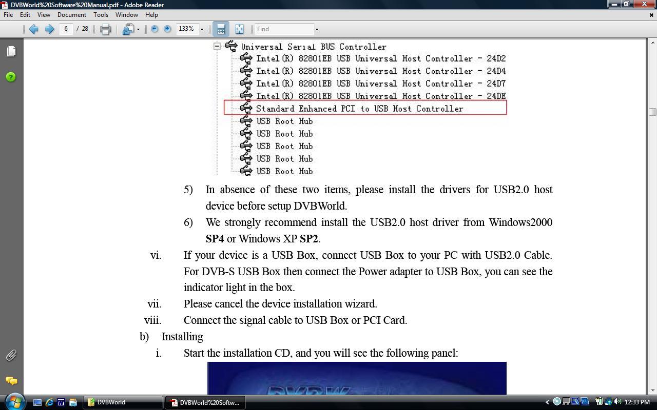

launch pc then plug in USB then power and launch DVB Dream. You should hear the windows USB confirmation tone when you plug in. If not then Standard Enhanced USB PCI driver is not installed. See the Picture attached.
The DVB World Manual states that you must install a USB_PCI.device to open the USB port. This is available at windows download.

Yes, the correct file name is Standard Enhanced PCI to USB Host Controller. Check in Device Manager to see if is listed.
