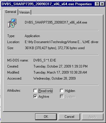

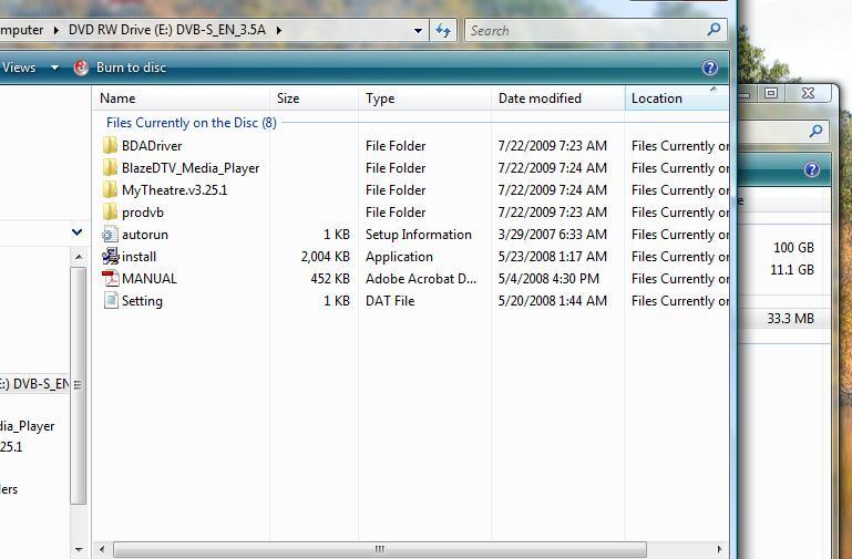

Can you post your OLD driver file pics from CD Properties like shown below? Attach a .txt file with NEW driver INF file content as well. For sure, we can make it work, probably 1-st time in N/A, as other reported, even if it's chipsets are dead. :)

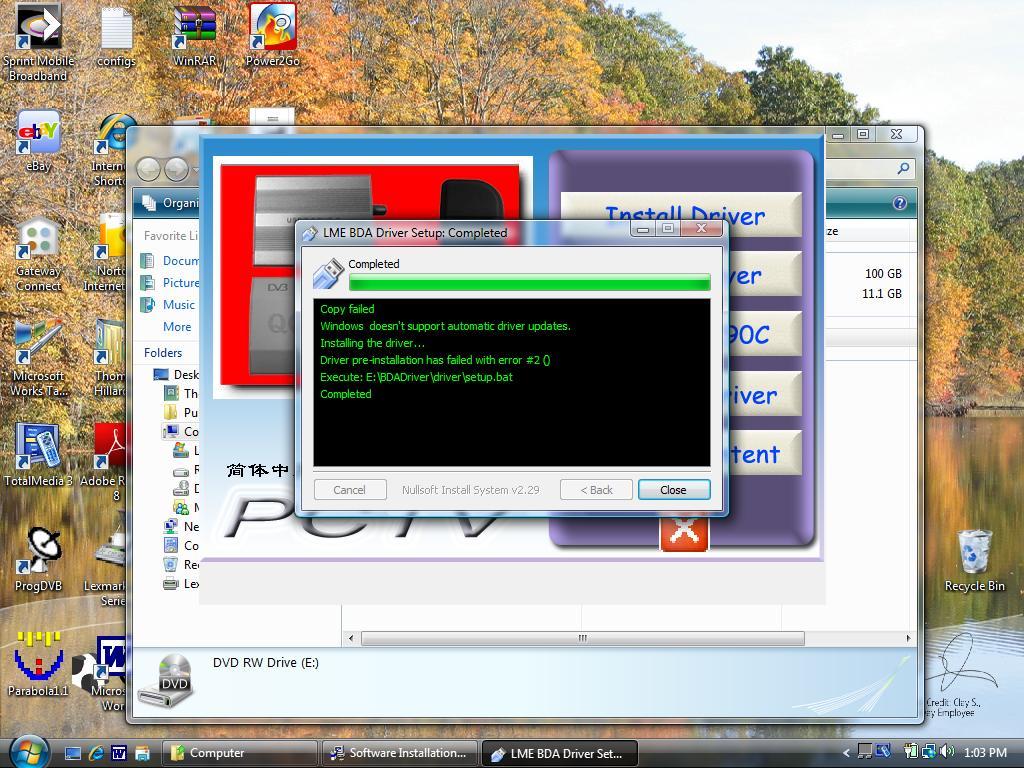

It looks like the device is supposed to be connected before driver installation starts. Old LMEBDA_DVBS7395C driver is V1.4c, and bundled in one package with old Blaze Player. It tries to check for a new version before install. Did you switch your A/V & Firewall Soft OFF? Cleanup your PC and try that before installing the old driver once again. Hopefully, it will update to latest version over the web before install.

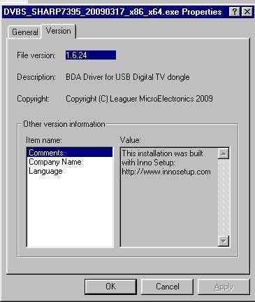

If it can't update anyway, install the new driver you downloaded. If you already installed it, what's the sys file name and version? Its installer version is 1.6.4. If you can't uninstall the drivers, and don't have any Uninstaller soft, try manually delete all LME driver files you can find by File Search, and all its entries from Registry using Regedit search for entries mentioned in the file and similar. Then reboot PC, reconnect the device and reinstall the new driver (not bundled with Blaze). It should work, but channel switching & locking would probably work normally only in Blaze. Install the latest Blaze package from the player site. Everest may show the actual USB device make & ID.
Cleaned pc and checked to make sure all lme files deleted.
Installed 1.6.24

File name is: lme_dvbs7395c.inf_58f5054e Will Vista read that extension?
In that file is lmebda_dvbs7395c.sys
by MICE dtv card driver dated 10/9/2009 Ver. 1.0.0.0
What if you point Add New Hardware to lmebda_dvbs7395c.sys in windows/system32/drivers folder? Try to find the same inf file in another Win folder. Also, I assume, you did all recommended (not mandatory) Vista Media Center updates, since the new driver & installer may reflect these updates.
At this point MS Tech support and LME Support will be good place to follow. User efforts in this regard are limited to correct driver install, other steps would require more knowledge, tools and info, available only to the device manufacturer - LME in this case. You may want to email them detail snapshots of Add New Hardware Wizard and Driver Install messages. :)
