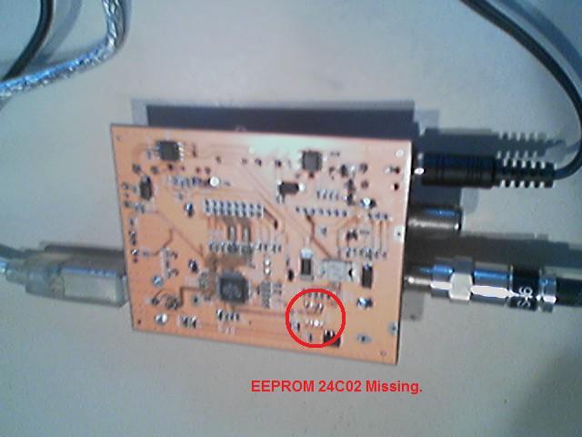

U304 EEPROM Missing
LME has sent me the Schematic for this product.
Good reason for it not to work, NO EEPROM!
It uses a 24C02 which is available form www.mouser.com but without the programmer and firmware, this is the end of project.
