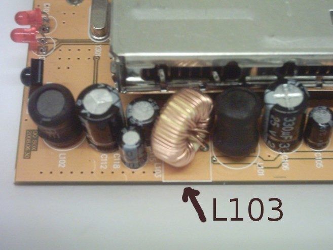

i have a problem
i have cutting in pic, i opened the metal box and Removed the board out, the channels works perfect ,
when i back the board again inside metal box , the cutting back again,
i followd up the instructions given in that post with put Tap on coil and boad but not success to solve the problem
any advise?
The problem is that L101 and L103 are both standard ferrite cores, energy is transferred from L101 to L103 through the case.
L103 was originally a toroidal type which is less prone to magnetic pick up. While changing L101 to a shielded type does help horizontal pick up, it does not eliminate energy through the case work.
I changed L103 back to the toroidal type and have experienced no problems at all.
Incidentally, they have stop selling the QQBOX on Ebay in the UK no doubly due to returned units, due to Sky mini dishes LNB more sensitive to the noise.
would you please give me a picture of L103 which is Toroidal type
dear tvboxspy thanks alot for reply . Tyt
my L1 and L3 now are the same at pic you attached
really i cannot know what i can do right now. what i change L1 or L3 .
