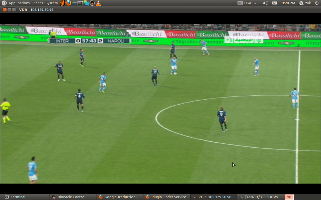

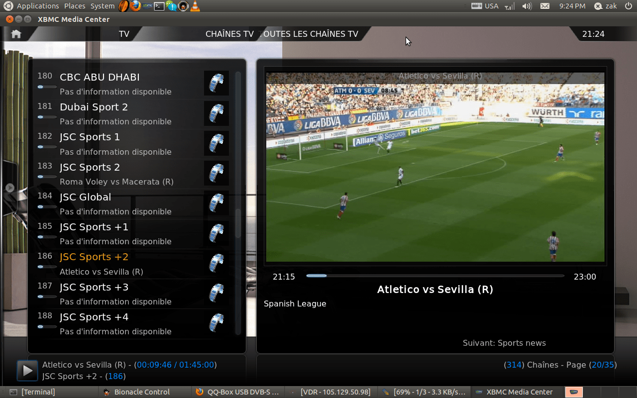

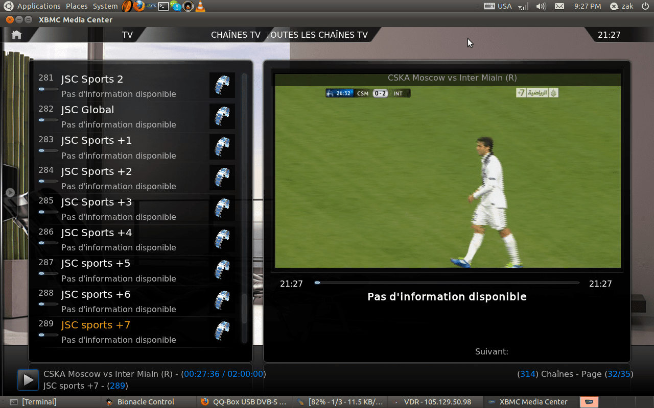

QQ BOX work fine on VDR & XBMC with ubuntu bionacle 4 (based on ubuntu 11.04
but the remote still off
VDR +XBMC

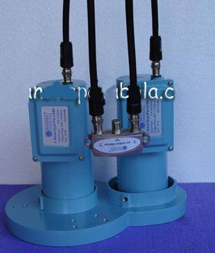

Hello all guys in this thread...I need to ask.....Did QQ Box can use this kind LNBF LNBF_Dual_Polarity_1x2.jpg? QQ Box Support that LNB'S Autoswitch ?Sorry for my my bad english n my newbie question.... :yes
