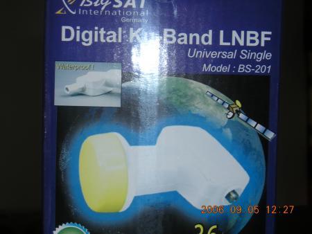

I have this LNB :Bigsat Digital Ku-band LNBF universal single model:BS-201
Specifications
input
Low Band:10.7~11.7GHz
High Band:11.7~12.75GHz
L.O.Frequency
Low Band:9.75GHz
High Band:10.6GHz
Output
Low Band: 950~1950MHz
High Band:1100~2150MHz
Noise figure
0.2 dB(Typical)
Conversion Gain
50 dB(Minimum)
Band Switching
Low Band:0KHz
High Band:22KHz

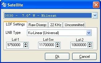

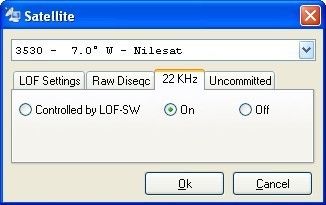

but currently i use another universil twin that it work like the Previous
I don't know why i must choose on or off for 22KHz in normal structure(from dish to qq box) for taking the signal of some frequencies but normaly i must choose (controlled by lof-sw )like i do when i use the loop out their i have signal

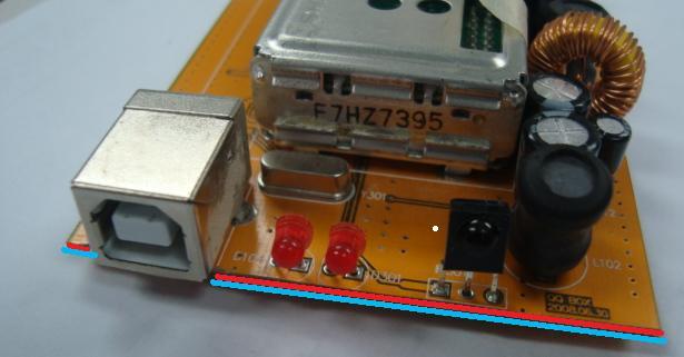

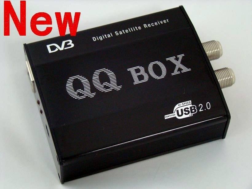

I have a BLACK QQ BOX [ Like in the pic ]
First , I install the driver , & I install PROG DVB
& i do everything but the signal level is 80% or more & Signal QUALITY is 3% or 4% !
i read some problems like me
posted in this thread , & ADAM says : " You must apply the electrical insulating tape to either the PCB or the USB end plate. Without this the tuner will "FLY". "
is this the solution ??
If Yes , Where I should apply the electical insulating tape
And THANKS !
# I'll Die To Make This QQ BOX ON #
