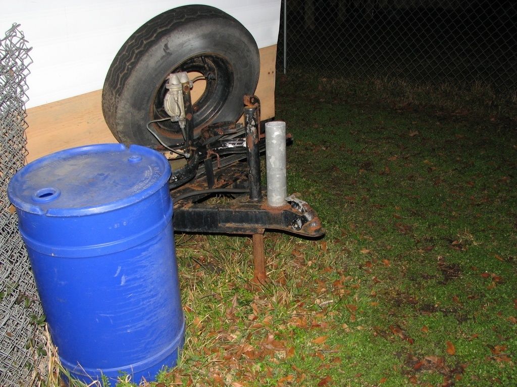

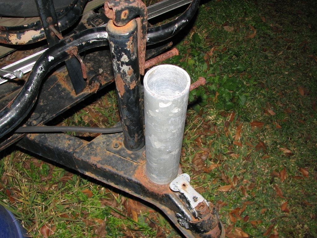

I found the final missing piece!
So, my dad bought some poles to fit the BIG 10' dish.
I ~think~ they are 3 1/2 outside size. I'm pretty sure that's what they are. And I ~think~ the inside of them is about 3".
So the big problem has been how to put the little 6' dish on ANY pole because it's a weird size. We measured it's mount thing and it needs a 70mm pole. We googled and could find no such critter anywhere. My dad says that's probably some BS they use in China only. I wouldn't be surprised..
So nothing you can buy fits it. Grrrrrr! :rant:
Well, my dad figured out that he could take a smaller pipe and trim it down on one end then weld it into the bigger pole. Pipe, pole, post.... I don't know what the proper name is for these, I've been calling them poles mostly.
Anyway.. So the problem was to find that smaller piece.
Bingo! I found it and it's been sitting under my nose for YEARS!
There is an old, UGLY 50's camper trailer in my yard I use as a tool shed. I was out playing with my dog in the mud a while ago and I looked over and like a bolt of lightning, I saw it.
Welded onto the front of the trailer hitch is a short piece of pipe. I guess it was part of the awning system or something, I dunno. I walked over and looked at it and dang it if it isn't just right!
So I ran inside and got the digital measuring thing my dad gave me (Dad fixed me up with a buncha tools last year) and measured it. It's 73mm around! This is just the right size for what he was talking about.. So I called him and he said that yes, this is perfect, he can trim it down on a machine so that half of it is 70mm and the rest of it stays at 73mm. He can then put it into the end of the BIG pole and weld it into place. I plant the pole in cement then and after that, put the dish in it and all is good!
Woo hoo!!
So my dad is going to come by tomorrow and saw it off the trailer hitch if it isn't raining, take it home and do his magic to it.
Now with that one last part we were missing it's just a matter of getting the poles planted. I don't know how we can do that because we estimated that it's going to take like 32 bags of cement at 80lbs a bag. That's like insanely heavy. That's 16 bags each for the two poles.
The big, giant hold up now is the weather. It's been raining and my yard is a swamp and it's supposed to rain again tomorrow and then it's supposed to get really cold for the rest of the week. It takes my yard ~forever~ to drain off and dry up.
There is no way possible it's going to be happening this week. No way..
Next week is do or die time. I need some good weather now!

Woo hoo!!
Woo hoo!!

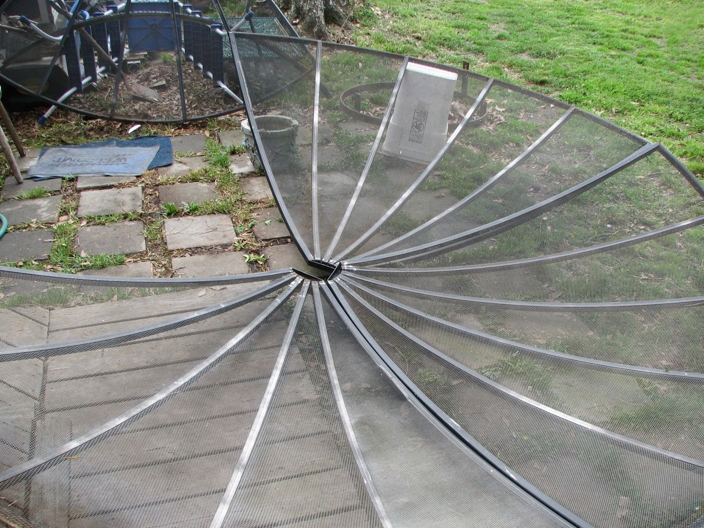

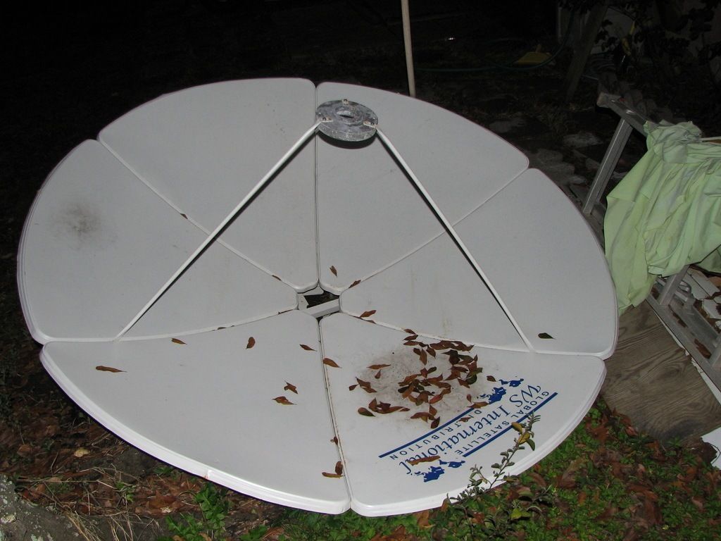

This is the dish I'm talking about. It's a 6' mini Cband dish that was on sale here last year for like $70. There's an enormous thread about the dish in the FTA section.
All my small ku dishes are planted and need no further work, I'm trying now to plant the two Cband dishes, a 10 foot and a 6 foot dish.
I'm smack dead on the Texas coast and we get a lot of hurricanes so these poles have to be very, very substantial. I do not expect the six foot dish to survive, it's going to fold up like a wilted flower the first good storm we get, it's flimsy and I bent it in several places trying to assemble it so it's already on borrowed time and it's never even been put up for the first time yet.
If the little one goes in a storm I won't weep too much but the big dish, I'll croak if it gets damaged, they are soooo expensive and hard to come by and the stash of dishes my ex left me all got crushed up and or stolen last year so this is the last one, I can not afford to replace it.
