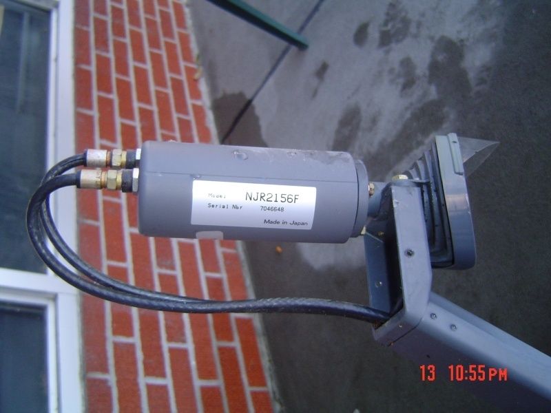

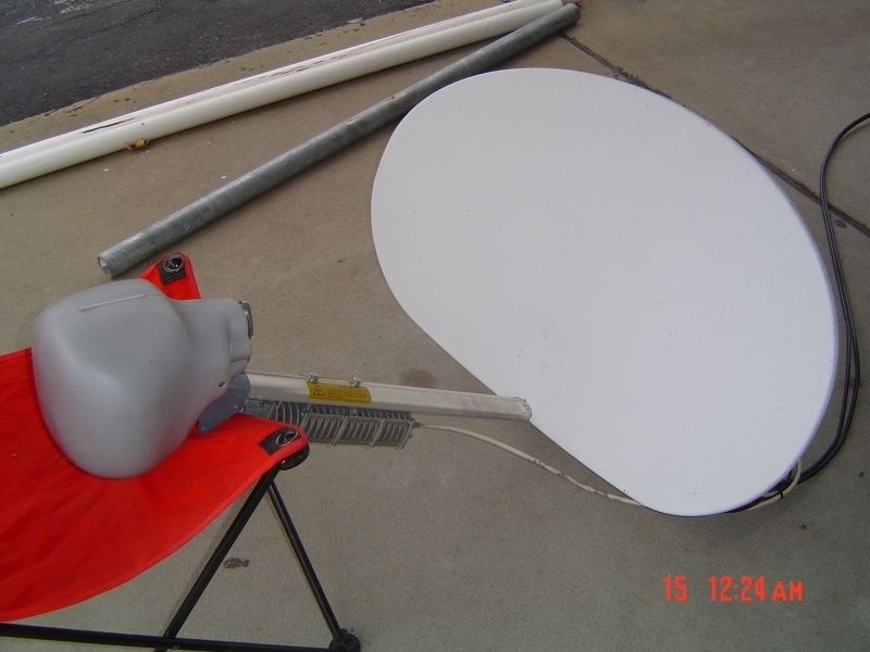

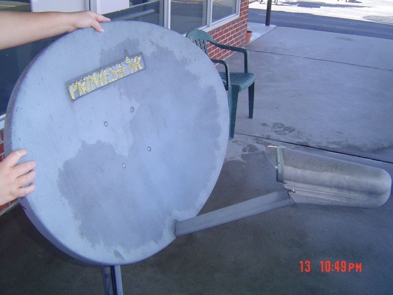

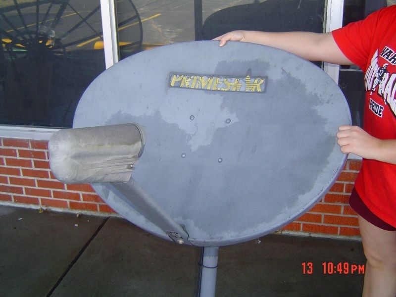

Picked up the Primestar 75e, 36x26" (90 X 63cm) this morning. The neighbor let me have it free.
Here are a couple of pics:
Ps 75e Ps 75e2 Ps 75e3 Ps 75e lnb2
It seems to be in pretty good shape. Got part of the pole and all. :D

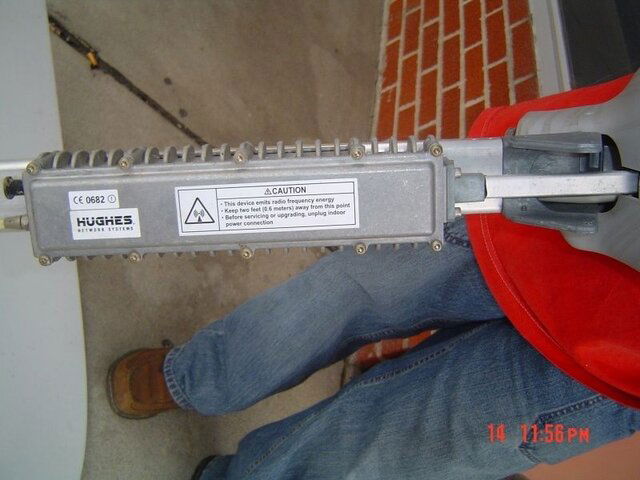

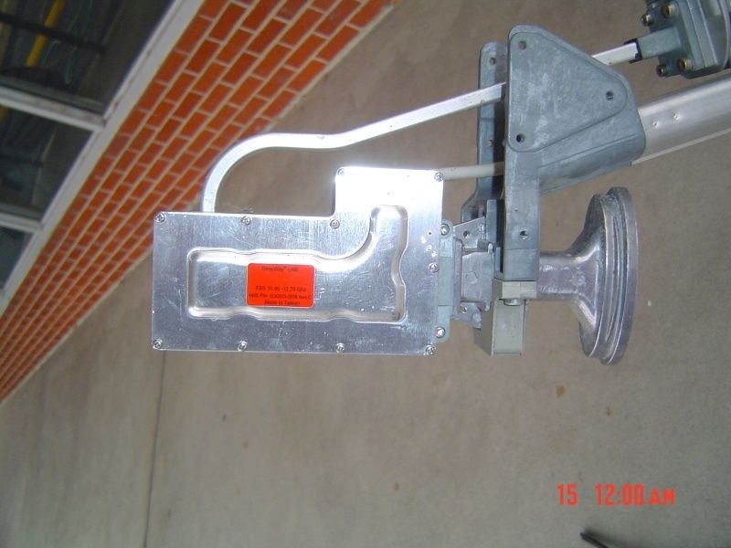

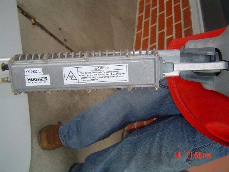

Hey Guys,

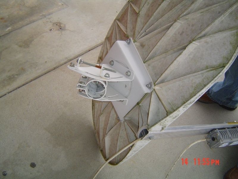

I picked up a 2nd dish after Church today, free of course.
It is a DirectPC dish. it is a little wider than the Primestar 75e, and just a bit shorter. 39x23" for this one vs the primestar at 36x26".
Here are some pics. It is in great condition, and only been hanging about 3-4 years.
D pc D pc mount
If nothing else, I might be able to use the mount or pieces of it for a bigger dish when I find it.

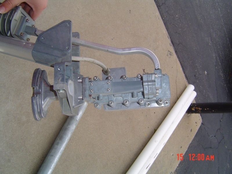

D pc lnb D pc lnb feed D pc lnb feed2
The lnb and feed horn are in good shape, just a little odd shaped where the clamp is.
Anyone have any experience with this kind of dish?
Is this lnb/feedhorn good for anything? Of any value to anyone?
The search continues. I want a Primestar 84e or bigger if I can find one. :D
Fred
BKP
BKP
Jul 24, 2006
386
Vacationland, USA
Great score with both dishes...
I think you should play around with both dishes.. Also, I think you'll be surprised with the results you'll get..
I'm thinkin' Pete and maybe Iceberg has (or has had) a DirectPC dish..
PSB
PSB
On vacation
Nov 5, 2003
1
5
I have a few DirecPC dish, they work GREAT for FTA and the great thing about the white ones is they can be inverted by skewing 180º and still be bang on the satellite!
I would replace the LNB and keep the feedhorn as its designed for the exact shape of the DirecPC dish!
Nice find (Both)
