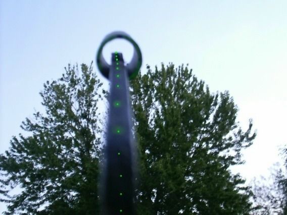

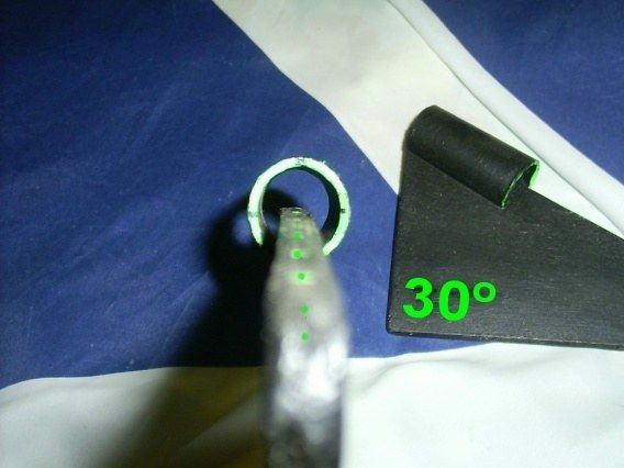

The only questions I have are:
Where does the signal come into the dish with it laid over on it side almost vertical end to end when pointing to Hispasat? I think it is a 12 something degree of elevation for me in 63369 zip code.
I would like to construct something out of cardboard, paper or whatever to tape in the center of the dish or wherever the signal comes in, at the right angle towards the satellite that I can sight down, and see what is the obstruction. I think it might be a single branch of my neighbors tree on my East, and it is one of those trees that the leaves won't finish falling off for another month. I am sure that if I can find the branch, he will let me cut it off. He is a very nice guy, and lives alone, almost a hermit type.
If any of you can explain to me where the signal hits the dish and the height, and angle, or maybe give me an idea how to construct something that will allow me to see the obstruction, I think I can nail this bird.
Thanks, Fred

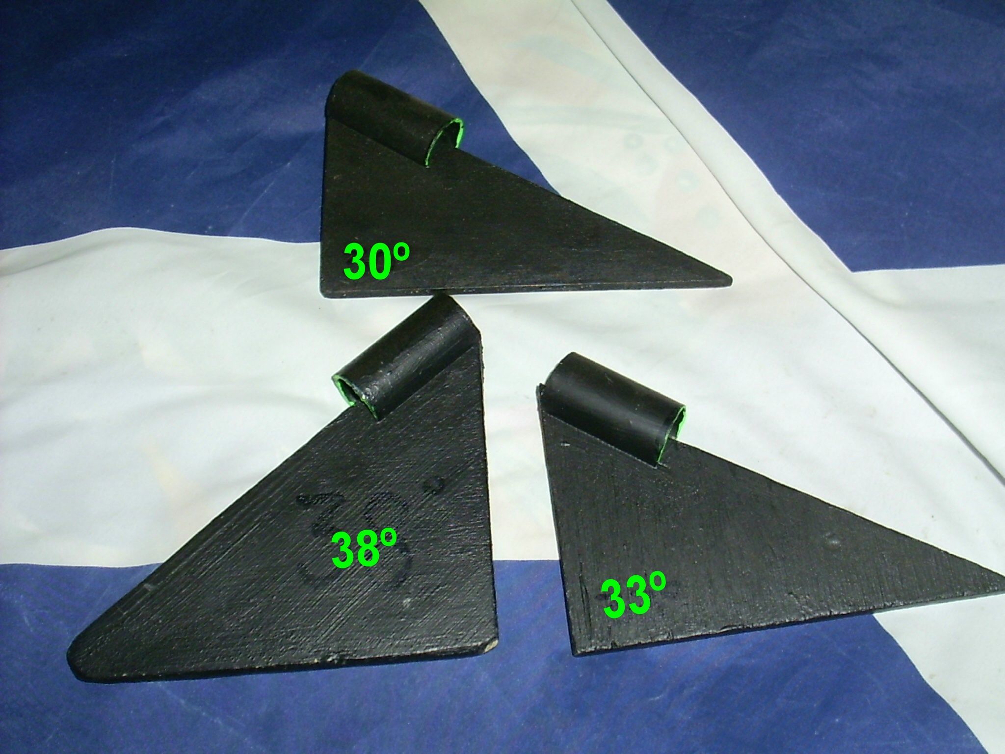

14º elevation for you, here in MN. its like 10º no problems here with 30ºw
Have look below for ideas on how to make your own clearance view finder!
I used to have 3-4 made up for the popular satellites before I got a professional satellite angle finder.........

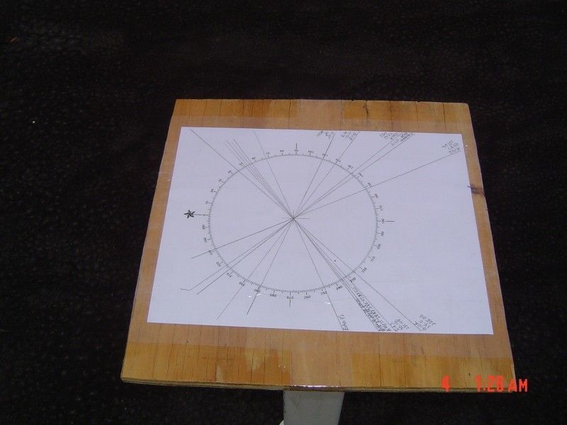

Thanks Pete,
I think I can come up with something like you have for the elevation.
The next question is where do I point it when looking towards the East sitting in front of the dish? I guess I don't know what compass heading to use for the pointer to set on. Your figures above show an AZ of 109.4, my problem is that I don't understand where the AZ is calculated from.
Sorry for being so dense.
Fred
Thanks Pete,
I never really understood that part of all this. It is finally starting to make some sense.
Now I think I can figure out which branch to cut off. :D
You Da Man!!!!

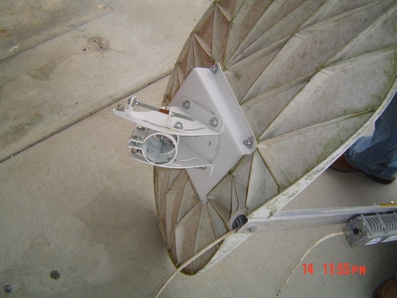

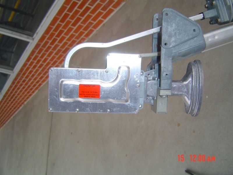

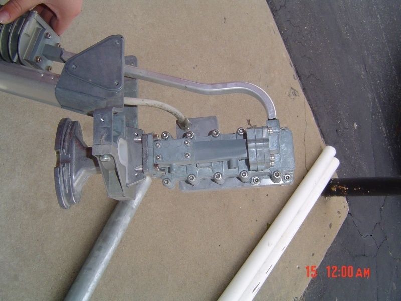

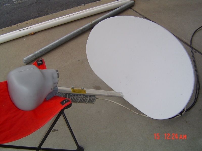

You have all looked at my DirecPC dish that I found. If not, here are some of the pics.
Since this dish has a nice skewable mount that will fit right onto one of my extra non-penetrating mounts, why don't I just put up a separate dish for Hispasat?

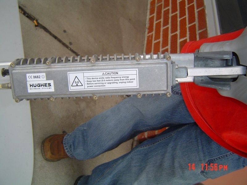

1. Does anyone know if the above LNB is standard, or universal? I think I read somewhere that they were standard.
2. This is both a sending/receiving unit. Do I just hook up to the input on the LNB only?
3. Can I remove the sending part hanging under the support arm?
4. Since there is only one output from the LNB, can I assume that it is voltage switching for the polarity through this one hook-up?
5. If number 4 is true, I should be able to just hook it into port 2 of my 4-way diseqc switch. Correct?
I think this might be an easier solution than cutting my neighbor's tree, or moving the motorized dish since I have it almost completely tuned in. Plus, it will give me some experience at dialing in a single satellite with a single dish. :D
Thanks for your help, Fred
1/ DirecPC LNB's are Standard (L.O. 10750)
2/ Right just the LNB
3/ Yes!
4/ Yes!
5/ yes you can use a switch (Only after you are all set up)

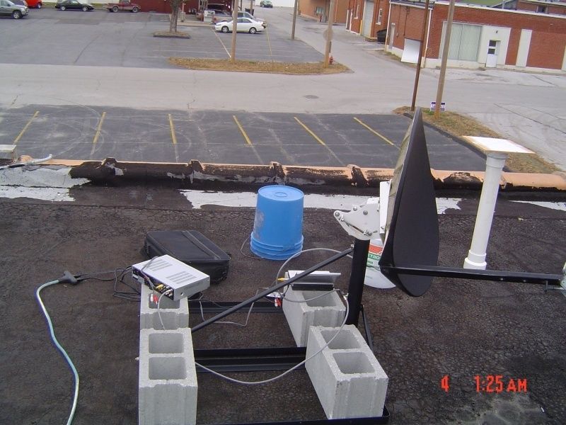

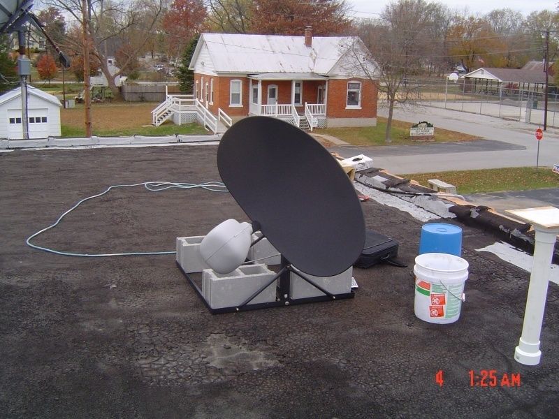

I got sidetracked yesterday. Had to actually go out and make some money. :D
I also had to prep the dish, put together the mount, go get some concrete blocks etc. Took the mount and blocks to the roof late yesterday afternoon. Didn't feel well so waited until this morning to take up the dish and set it up. Drizzled until about 11:00 AM.
Took the dish up and actually started the setup. This is for Hispasat 1/3C at 30 degrees W.
This was actually easier to find and tune in than a motorized setup. Course now I have some other tools to help in all this setup business. Also the DPC dish has skew and elevation scales to work with.
So I set the elevation at about 14, the charts say 13.9, set the skew at 48, charts say 47.2, and pointed the dish where I knew about where it should be. The DPC dish also has a bolt that runs through the mounting bracket that sits right on top of the mast making it real easy to move back and forth. Then it was just a matter of fishing up and down, then move over a bit.
I just took some readings, some of which were a little better earlier when I was on the roof. It was drizzling before that and some that is now East of me. This is SQ readings on 4 TP's that are listed on Lyngsat.
12131 - H is at 44-50%
12172 - H is at 45-50%
12052 - V is at 28-32% (this one was at 45-50% and bouncing to 60% when I set the dish up, and was the TP I used to home it in. Don't know what happened except maybe the weather.
12175 - V is at 15-25% but still has a picture.
Another TP that isn't listed am getting it at 55-60%.
I need to fine tune it some more, but I got cold, and with not feeling well last night, I did't want to push it today. It is supposed to be warmer tomorrow, so maybe tomorrow afternoon I will try and super-fine tune it, and finish the super-fine tune on my motorized.

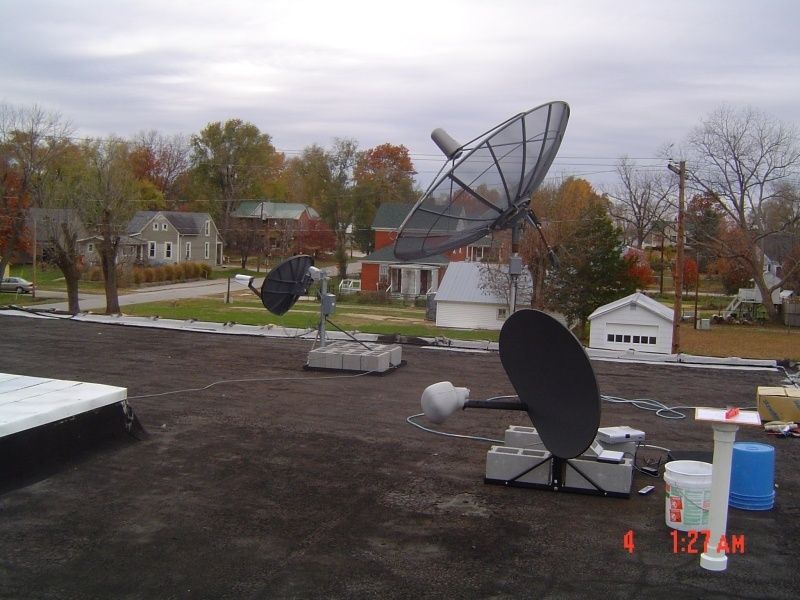

Here are some pics, and some of the tools I made.
dpc-hispasat-skew.jpg dpc-side-view-hispasat.jpg home-made-azimuth.jpg home-made-az-elev-tool.jpg dish-farm.jpg
Any suggestions on how I might fine tune this sat further?
Thanks for all your help, Fred

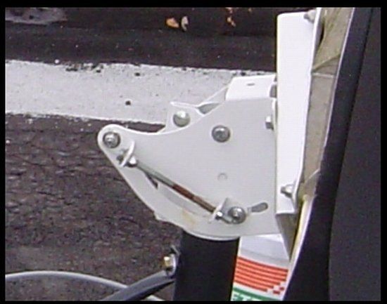

I need some advice on what to do with the DirecPC Dish. The fine adjustment screw on the side is kind of screwy. It seems to cock the dish E-W when trying to move it up and down. The angle brackets which are part of the adjusting screw mechanism seem to bend towards each other and you have to turn the locking screw on the inside of the brackets on the left to make it move up. It is very difficult to maneuver for adjustment.
PSB and Ice, please take a look at it and tell me if the original installer put it on correctly.
elevation-adj2.jpg d-pc-mount.jpg.

I used to install DirecPC, I hate those elevation screws!
I used to just remove them, manually point the dish then put them back on just for some extra support!
I tried to take the screw loose, but couldn't hold/move/adjust and tighten down all at the same time. That thing is a pain in the butt!!!
