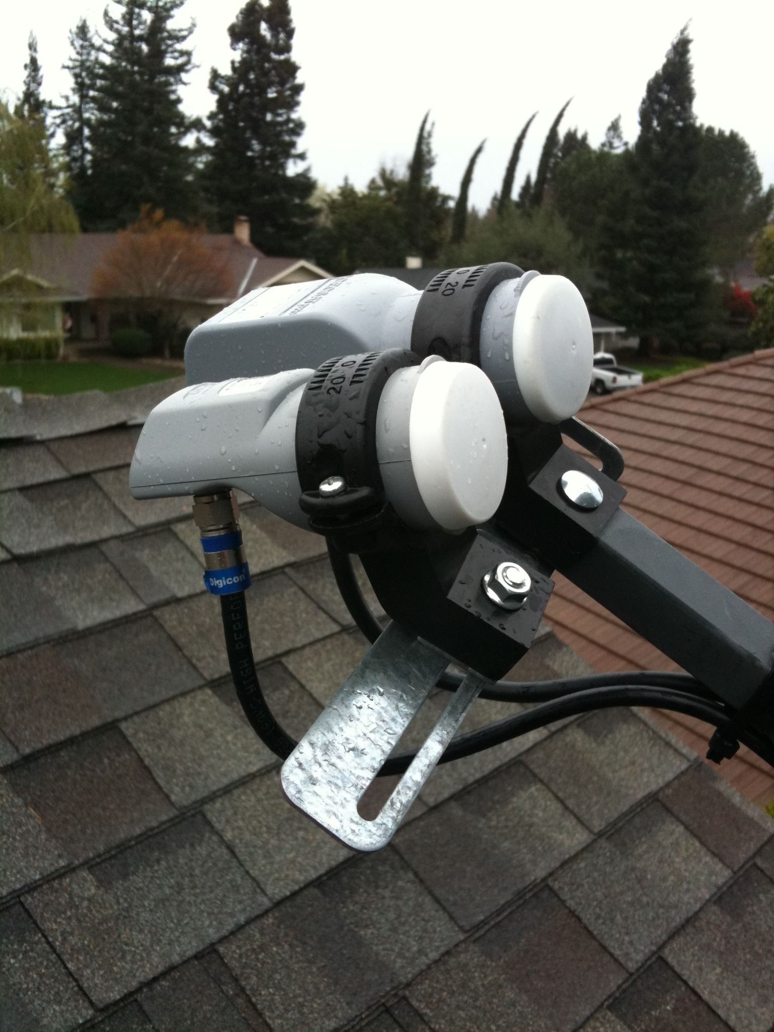

Caught my error of the last post! Lost my mind for a moment.... The side LNBF is mounted 6 degrees to the east side of the main LNBF, not 2 degrees. Have the receiver programmed for the 103W satellite to be in the 97W position and the 22 KHz to switch ON. Nothing special..... Just a standard LNBF mounted in the regular LNBF clamp and use a offset LNBF clamp to attach the second LNBF to the east side of the main LNBF. When I select the 103W, the motor drives to 97W and the 22KHz switch selects the side LNBF with the +25 skew.
Pouring rain out here in CA, but will snap a picture when it clears.
I would love to see a picture of this setup. :)

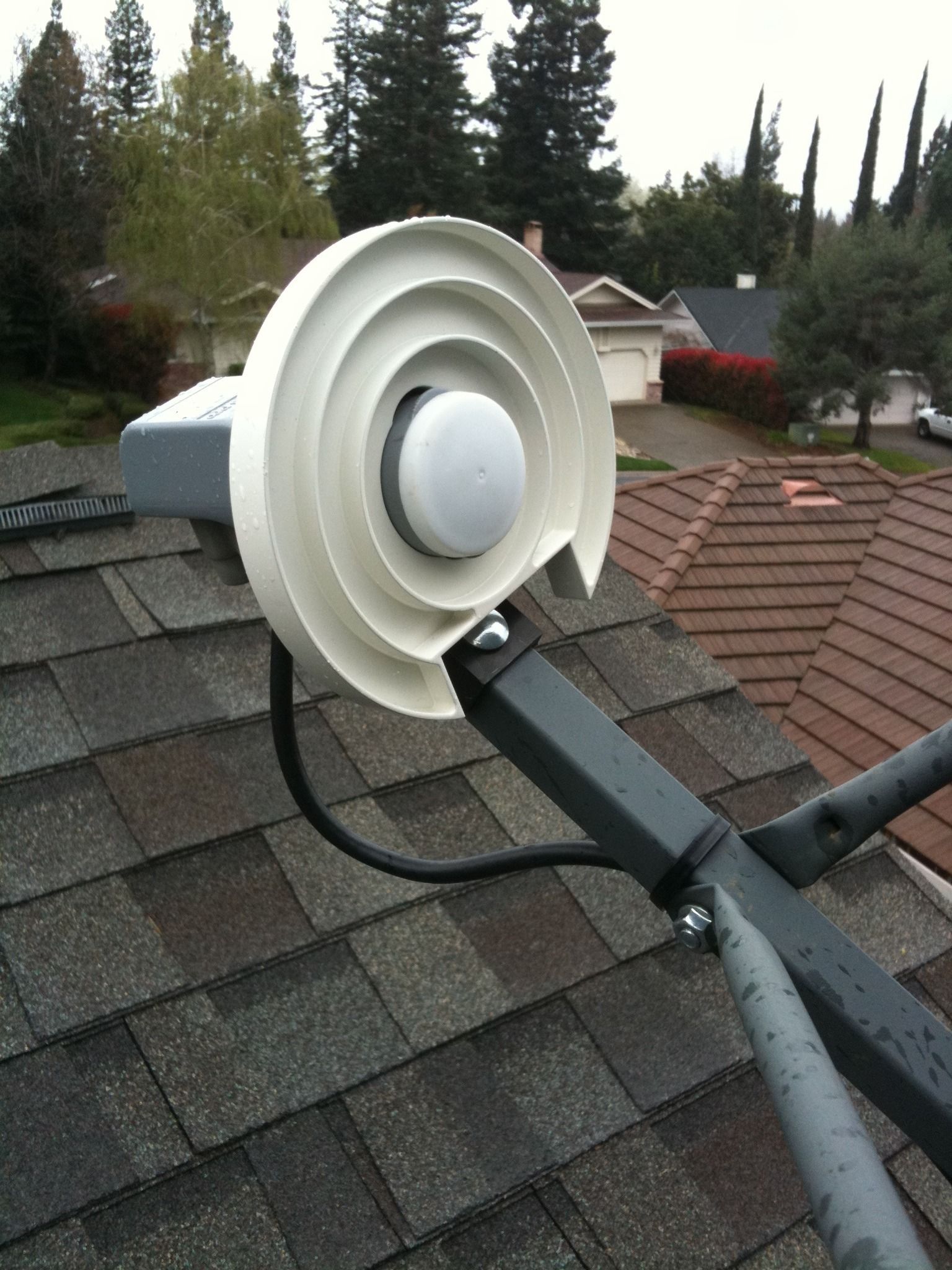

Had a break in the weather today, so I was playing with a new KU-band scalar project. WescoPC has played with this sample. Thanks Bob for the testing and input!

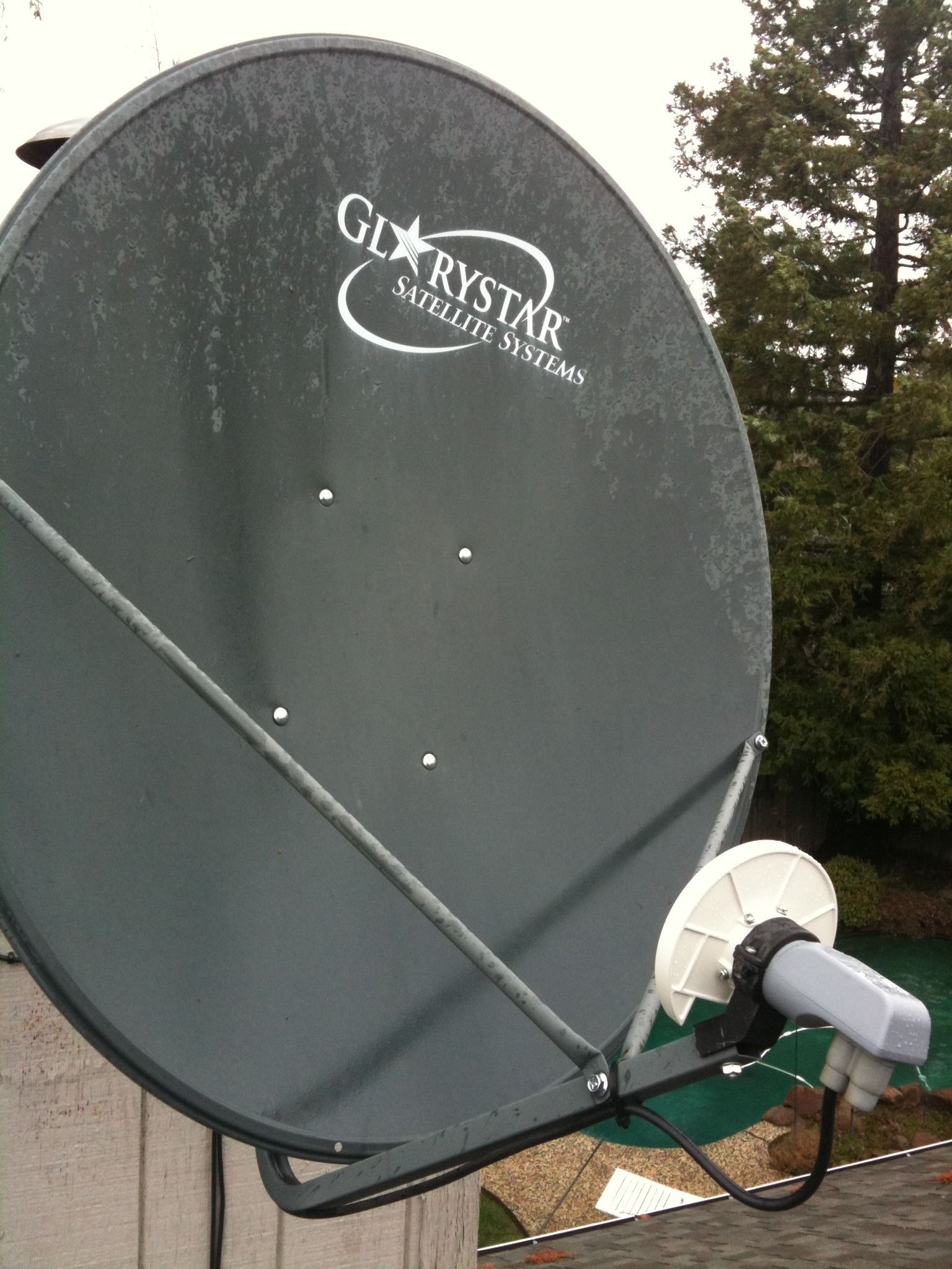

Got a shot of the motorized GEOSATpro 90cm with the side mounted AMC1-KU bracket as I was reassembling. Here is a shot right before the skew was set for AMC1-KU and the downpour chased me back inside.....
My focal distance is supposed to be around 26.5 or 27 and only have about 5/8 sticking out of the scaler but I had about inch and a half or more. Haven't had a chance to check it but what exactly does it do. I'm assuming it makes the picture better but by how much?
Have your receiver and a small TV next to the dish and observe the Signal Quality reading as you move the Feedhorn in toward or away from the reflector. You will notice the SQ reading optimize when it is in the sweet spot of the FD.
Placing the feedhorn out of the sweet spot of the FD will eliminate the signal reception. Yes.... feedhorn placement is critical for optimum Signal Quality.
It also important to make sure that the scalar is centered and parallel to the reflector and the feedhorn is aimed directly into the center of the reflector. You can use a laser level centered and placed across the scalar and again across the feedhorn to project a laser point into the reflector.
